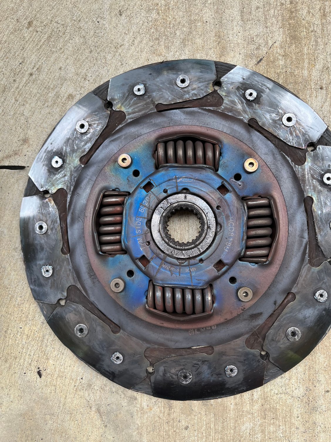

My 01 EX coup friction disk appears to have exploded after less than 25K miles. While driving around town the clutch just gave out. Back in 2020 I had an ASE mechanic replace the clutch (Exedy ?) etc. The flywheel was resurfaced. Upon investigation, I found the slave cylinder spring broke. I've replaced both master and slave (Exedy) and now I can get in and out of gear with the engine running but there is vary little grab from the friction disk. The transmission bell housing has a bunch of fibrous stuff in it like kevlar or carbon fiber.
My question is: Would the slave cylinder issue account for the friction disk problem or is something else wrong ?

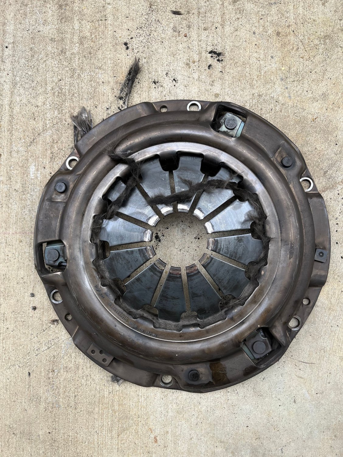

Pulled the clutch today. Both the clutch and the pressure plate say Exedy on them. I checked against the Exedy global site for counterfeit and they appear legit.
No material left on the friction disk.

Yes, the other side of the clutch has a little material left. Maybe the pressure plate wasn't torqued down correctly ?

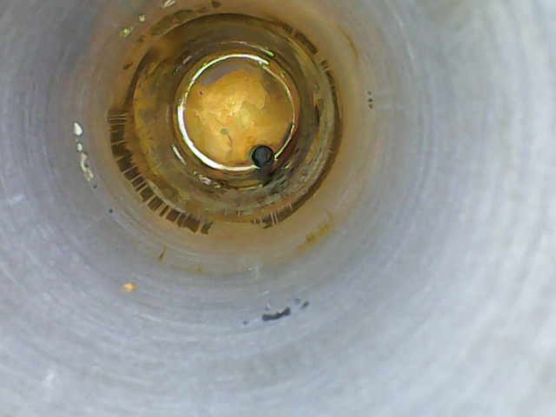

Here is a shot of my slave cylinder:
So I think "Lack of free travel caused by faulty clutch slave cylinder ..." fits my case and answers my original question. I never noticed any problem with the clutch until it broke.
Moral of the story: If you're going to go through the trouble and expense of replacing your clutch, replace the master and slave cylinders as well. They are not that expensive and you have to bleed the system anyway. A vacuum bleeder makes quick work of that.
