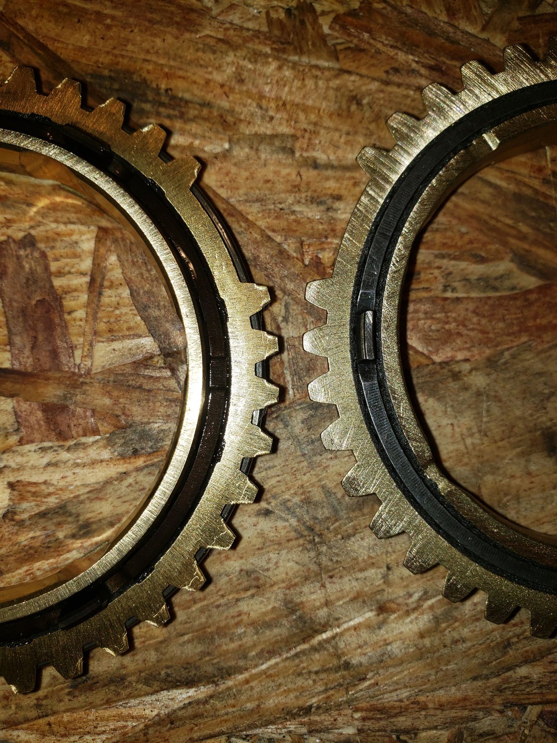

Big gears are engaged all the time so they shouldn't really show any wear. You would want to look at the synchro and small teeth next to them. 1st and 2nd synchro and shift collar are on the countershaft. 3rd, 4th, and 5th are on the mainshaft. Don't have a pic of chewed up shift collar teeth but here's a pic of a worn synchro. If you look in the service manual it will show you what to inspect.
Great info, thanks! I just inspected the synchros and shift collars and everything looks good, so hopefully it is alright. Only thing that has me a bit concerned is the diff bearings sound a bit loud, but that may be normal for those bearings for all I know. I was going to replace them while its apart just in case until I looked at the price of those bearings. I'm hoping they are okay since they don't feel rough or have any play.
