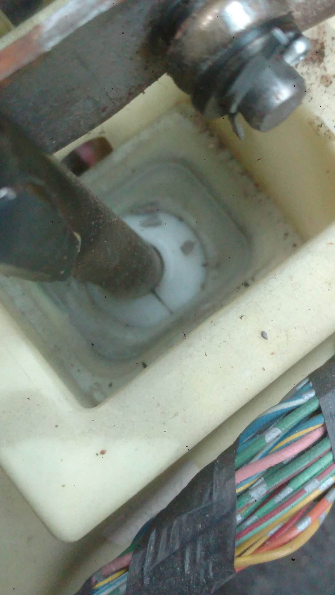

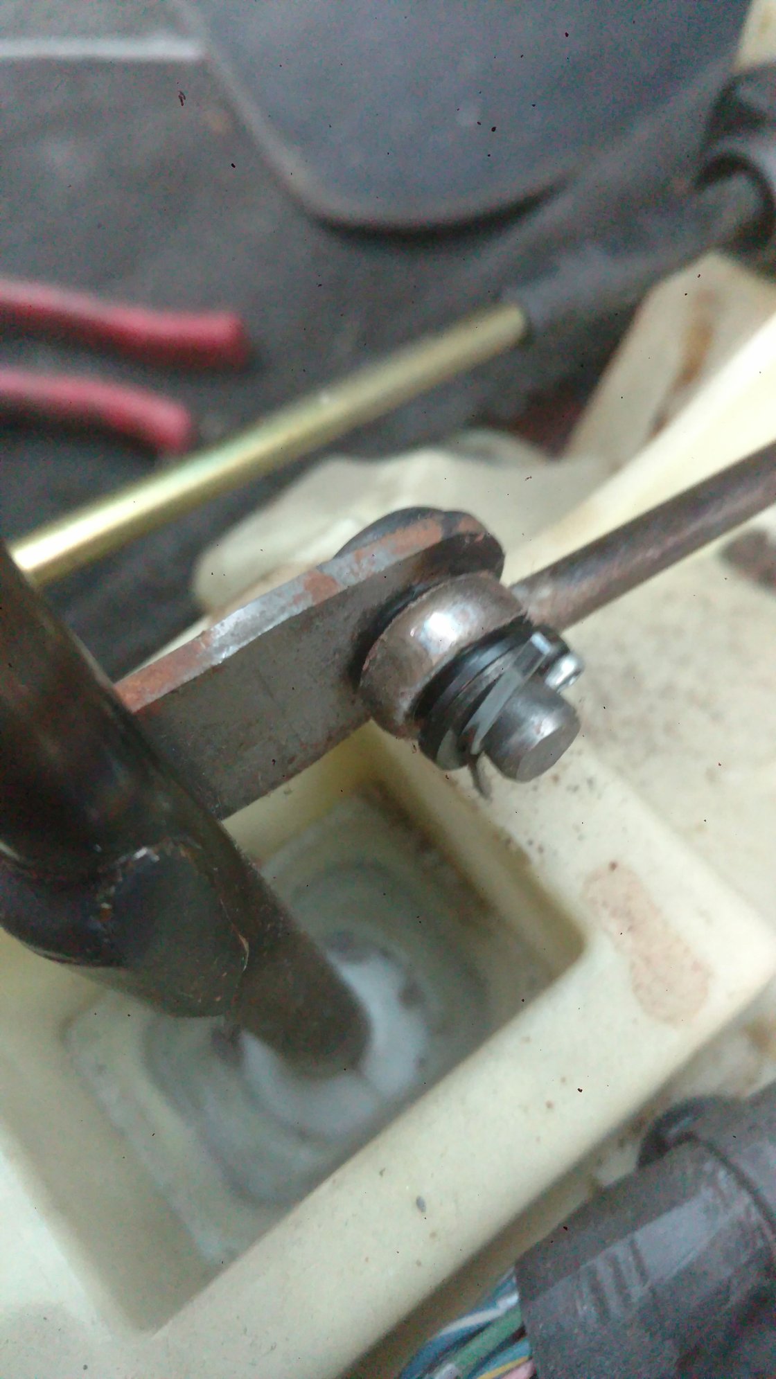

Old Jan 19, 2020
Mrbrown's Avatar
Joined: Jan 2020
Posts: 4
Mrbrown is an unknown quantity at this point
Re: Pops out of 5th
So I took off the center console today and found this. Is this maybe the cause of my 5th and reverse problem? Also the linage in the pic seems very loose. I can move it side to side very easily. And it looks like maybe no rubber bushing in it
Old Jan 19, 2020
Colin42's Avatar
Posts: 9,654
Likes: 1,285
From: Barrie, ON Canada
Rep Power: 223
Re: Pops out of 5th
Yep split shifter ball
