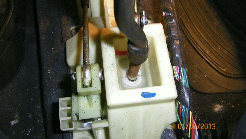

So starting about a week ago I've noticed my shifter squeaks when shifting, and is starting to become difficult to shift into 3rd or 5th.
So I just took it apart to lube it up and noticed what appears to be the problem, when you shift out of 2nd or 4th, the bottom half of the ball seems to get stuck and the seam splits open farther, then when you try to shift up into 3rd or 5th, it sticks because the bottom half of the ball is still stuck on the bottom. I've attached a pic ( and yes... I know it desperately needs a clean :-P ).
I'm going to lube it all up anyway, but my main question is:
Are the 2 halves of the ball supposed to come apart? It seems like a natural seam in the ball and not a crack, but is it supposed to be glued together or something?
Thanks in advance.
Edit: So I sprayed some lithium grease around the ball and worked it in a bit, seems to not get stuck as much, but now its squeaking really loud when shifting into 5th or reverse :-(.
I only sprayed grease around the edges of the ball from the top... is there a way to remove the ball entirely so i get get some grease down around the sides and bottom?

That sucker is broke, you have to buy a new shifter to fix it. Lubing doesn't help the fact that the ball is split in half.
Pretty cheap, considering what it is.
A little over $50 from Majestic. Probably a bit higher in Canada.
http://www.hondaautomotiveparts.com/...y5=SHIFT+LEVER

Re: Shifter pivot ball... shifting problems
You had better look in a real parts catalog.
The catalog I linked above shows MSRP in the US is almost $80. I'm guessing Canadian will be higher than that.
You will not walk into a dealer and get that part for only $50.
54100-S5A-003 is the part number.
As for a used part, I would get one from 03-05.
01-02 had the problems so do not use those.

I actually have the exact same problem. So you have to replace the entire subassembly to fix this? The ball is not broke completely yet but you can see the split pry open when one side starts to stick. I am surprise lubricant wont fix this problem.
Old Jan 20, 2013
The problem could have been caused by lack of lube, but once the ball starts to split it must be replaced.
That means the whole thing, as already explained.
I have not seen any aftermarket solutions thus far either.
HTH

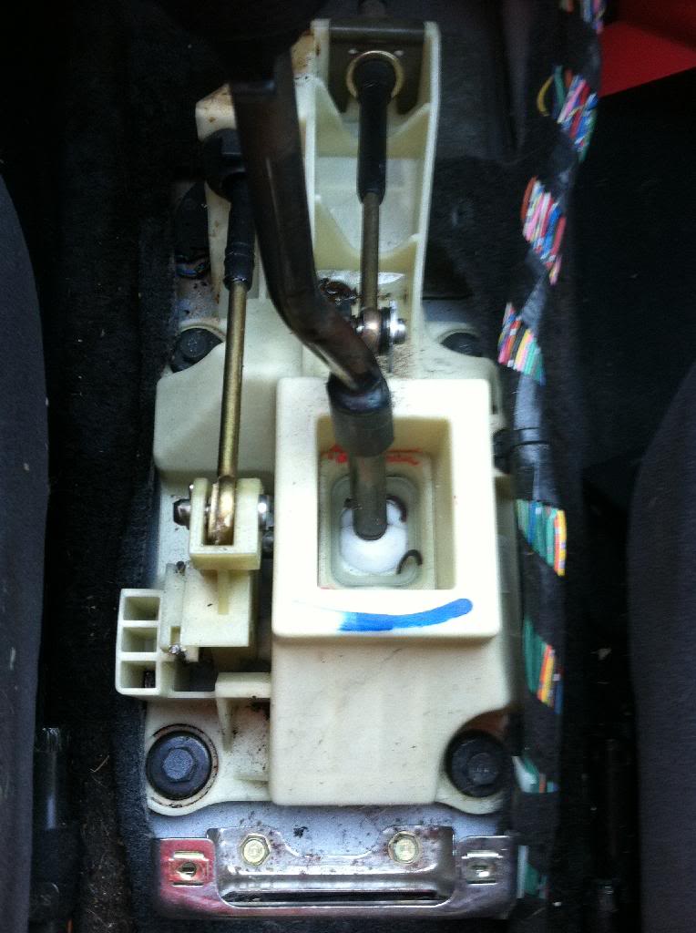

Bump, did anyone change out this shifter sub assembly?
Mine slips out of gear into neutral and I noticed that my pivot ball is splitting open...I'm hoping this will fix my issue instead of being the syncros.

Yes I have replaced a few of them, and of course you need to fix the obvious problem first.
Seems like the usual complaint was "the shifter is very stiff to move" once the ball splits like that.
I don't remember anyone (customers at work) saying theirs popped out of gear, but it's certainly possible.

My shifter does not feel stiff to me, it had grease around the ball before I lubed it up...I don't think this is causing mine to slip into neutral but again I wasn't sure if this was normal or not.
I asked a few guys at the Honda dealer and none of them had replaced the assembly on these cars.
Old Apr 20, 2014
Shifter is a hell of a lot cheaper and easier than trans guts. Just sayin.
If you were really ambitious, you could completely disconnect the shifter from the cables and see if it still slips to neutral. Of course you'd have to figure out how to work the bare cables as you drive around to do that though.
It's been several years since I replaced one, and I can guarantee you that I'm the only person left at my dealer that ever replaced any of the shifters. Anyone else that might have no longer works there.
It's a known issue with 01-02 cars, there's a couple bits of service info about it.
Lack of lube for the pivot ball (PDF)http://www.google.com/url?sa=t&rct=j...65058239,d.aWw
Stiff shifting? Check the shift lever pivot ball. Page 2.
Honda Service News June 2002 http://techinfo.honda.com/Rjanisis/pubs/SN/a020600.PDF
You can't see the link above, follow the instructions in this post to see it.
HTH

So can I order a shifter assembly from 03+ and would it bolt right in?
Old Apr 20, 2014
The part number given in the linked service info is the newer version.
As far as I can tell, it is now the only part number for all versions of the car from 01-05, IF you are purchasing brand new.
If you get one from a wrecking yard, then you want a unit from an 03-05 car.
