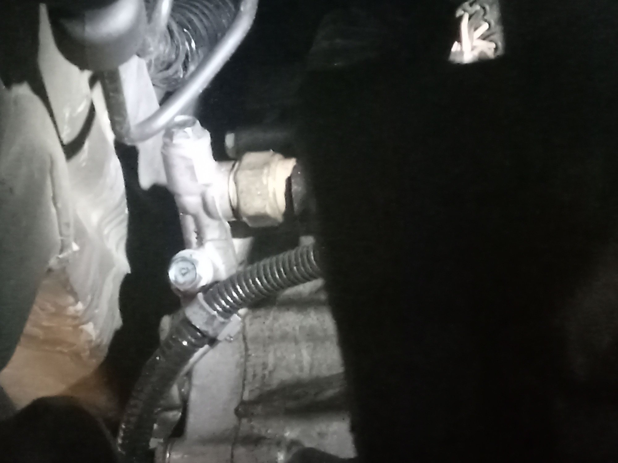

Searched this forum, but didn't find exactly what I was looking for...
I have moisture all over the top and rear of my auto trans ('05 EX civic). The front of the trans is dry. The wettest spot I found is right on top of the trans where the banjo bolt secures the cooler pipe to the trans. I feel like this may be a common problem, so I'm hoping there may be a couple threads about it.
I found a Service Bulletin about this on AllData. It states that to fix this problem, the pipe should be disconnected, new crush washers should be used, and then the banjo bolt must be torqued BEFORE the bracket bolt. The leaking may be caused by misalignment of the crush washers if the bracket bolt is torqued before the banjo bolt. This makes sense to me.
I'm thinking I'll just buy four new washers and do both cooler pipe connections. I think I just have to remove the air box above the trans and it should all be easy to access. Not sure how much fluid I'll lose, but I'll buy a quart of DW-1 to top off when I'm done.
Is that all I should need to do? Should I buy new banjo bolts too?

give it a go, the parts are cheap enough,
doubt you'd lose enough fluid that you would need to top it off, but check it to be sure

Thanks for the reply. I know about that plug. Mine indeed was leaking a little, but I replaced the plug a couple weeks ago. The oil from that leak tends to pool in that little crevice next to the EGR and maybe down the front of the engine and trans, My leak is definitely trans fluid probably being blown from the top toward the rear.

UPDATE
Looking at this thread, it's been almost two years since I've done this repair. Every time I've been under the car or looking in the engine bay since then, it's been clean and dry on the trans side. Great to see
I haven't noticed any issues with shifting either.
And when it comes to fluid service (drain and fill), I've decided every year may be best. Every two years is too long. I find too much sludge on the plug magnet when I drain the fluid. It's a pretty quick job and doesn't cost much anyway. This should keep the trans shifting well even as the miles go up.
