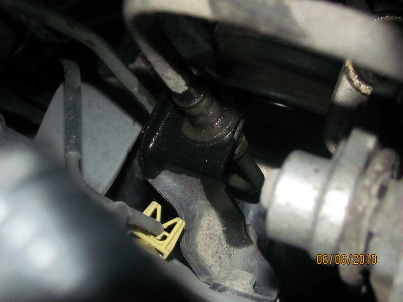

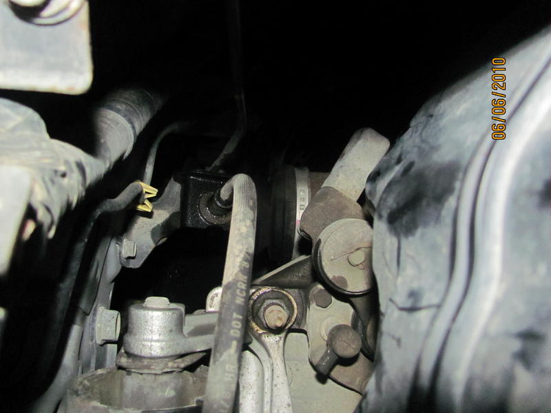

So after changing the transmission fluid last night and taking it for a drive (huge improvement) I checked underneath to make sure I wasn't getting any leaks. Everything looked fine. I went back out later to check again because I'm ****, and to my surprise I found this. I'm not sure what this part is, or what the line is for. I am very inexperienced with transmission stuff. Any help is much appreciated.

Is the leak a brake line near the caliper?? The second picture looks like it was taken from the drivers side under the motor mount and axle? I could be way off here..

Re: Leaking trans fluid. Pics.
no that's from the top on the passenger side. the black plastic on the right of the pic is the first air filter chamber. after driving it around a bit today it seems to not be leaking anymore. i cleaned around the spots where the fluid was and it has not returned... hm
this car needs an overhaul, so I guess I'm just assuming the worst when I run into irregularities like this. my first real project, and my first manual. the guy that sold it to me didn't take care of it, so it's getting overwhelming with all the needed repairs.
thanks for help on this matter, but i think it's ok. probably some missed spillage or something from filling it up. it was late when i saw it and didn't want to mess with it any more last night.
