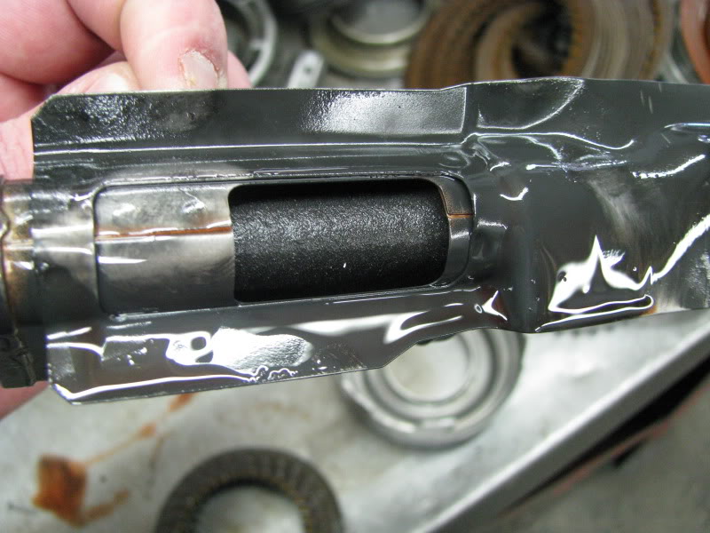

The trans was out and torn apart today.
The rebuild kit is from Transtar. Their components are VERY reliable from my experience.
I talked to the mechanic today and got some great knowledge from him.
According to him and his years of experience the Honda clutch material is the point of failure inside the trans. The aftermarket companies have solved the problem with more durable clutch material and he told me that once my trans is rebuilt it will last far longer than what Honda could do.
The clutch packs on my trans looked great. The problem was with the clutch in the torque converter.
Strainer totally clogged.

sounds like good news. yeah that filter is a big part of the problem too. they shouldve stuck with the older design of having a large metal mesh internal filter and a servicable pan filter you can change every couple yrs. im still not sure why some trans have torque converter problems and other have clutch pack problems.

Honda had a batch of converters that the TCC clutch came apart on. The research I found was not year specific though the early years (01-03) were the worst for it. The p0740 is TCC is thrown when the TCC is commanded on by the ECM and the output speed is less than expected. Granted, this was on the second time I pulled it out! I am an experienced mechanic too, let me tell you, these trans are a confusing mess... Gearbox is right though, ASE is overrated for sure. That is from a MASTER CERTIFIED TECH. This is while most all dealerships, all makers too, have their own schooling. The GM dealership I worked at had its tech pay scales based on ASEs AND GM factory training. It honestly rolls to this though...A good mechanic is born, not made! No amount of training while take a non-mechanically inclined person all the way to good tech. A badge on the shirt or a plaque on the wall means nothing... Mine threw it because one of the seals on the shaft that goes into the TC was rolled. Wasn't the convertor itself, though I did replace it while I rebuilt it. Let us know, hope you have good luck. CN got hisself burned by a "low mileage" 01. A 10 year old car with low miles usually has a bunch more problems than a 10 car with 200000 miles and taken care of! My car has 170000 on it and I would drive it to Japan if I could. It is a good car. Still runs and drives like a new one too because I am **** and I alone take care of it. I am extremely picky about who works on any of my vehicles. I was a mechanic for 15 years. I was paid well, others in the shop weren't and they cut corners regularly. I am sure the 8.00 an hour guys do that all the time, not on my cars.....
