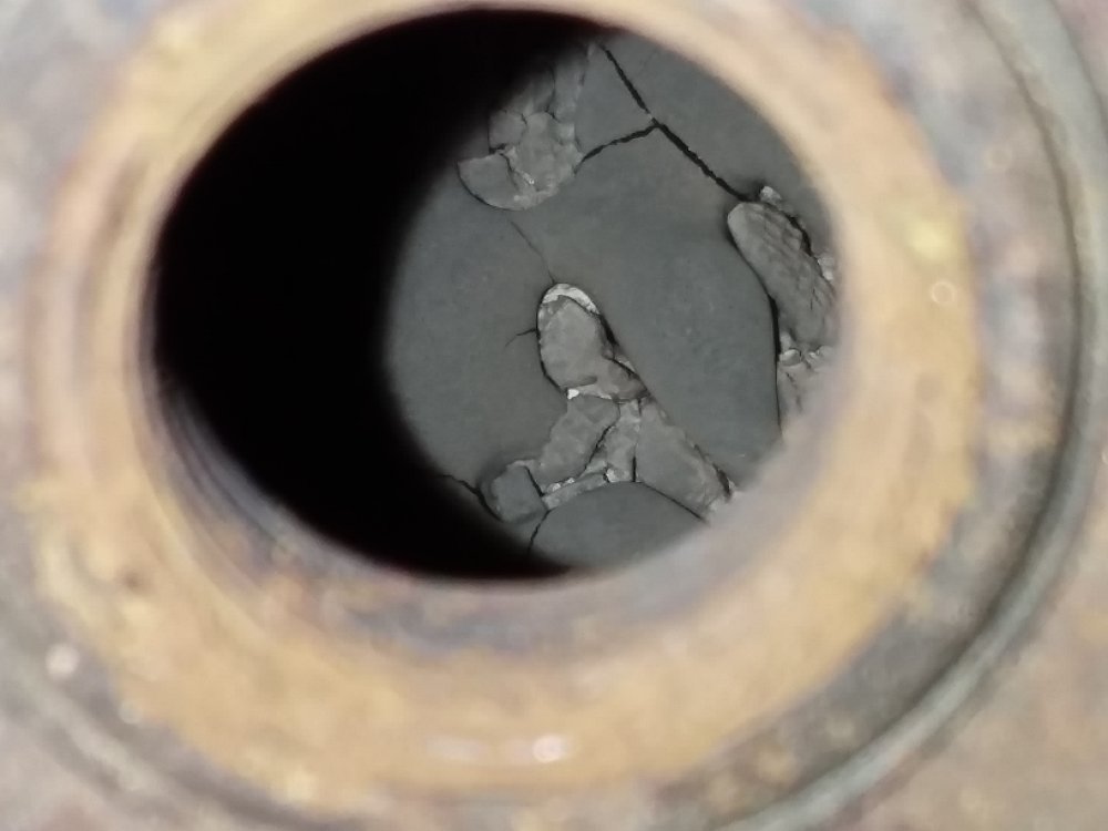

Posts: 15,179
Likes: 1,606
Rep Power: 367
Re: 02 Civic EX lack of power on hills no cel
have you had a chance to look inside the cat? below is a bad case.
