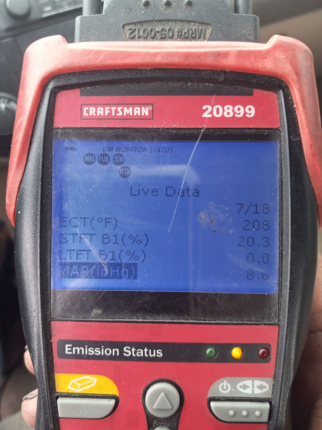

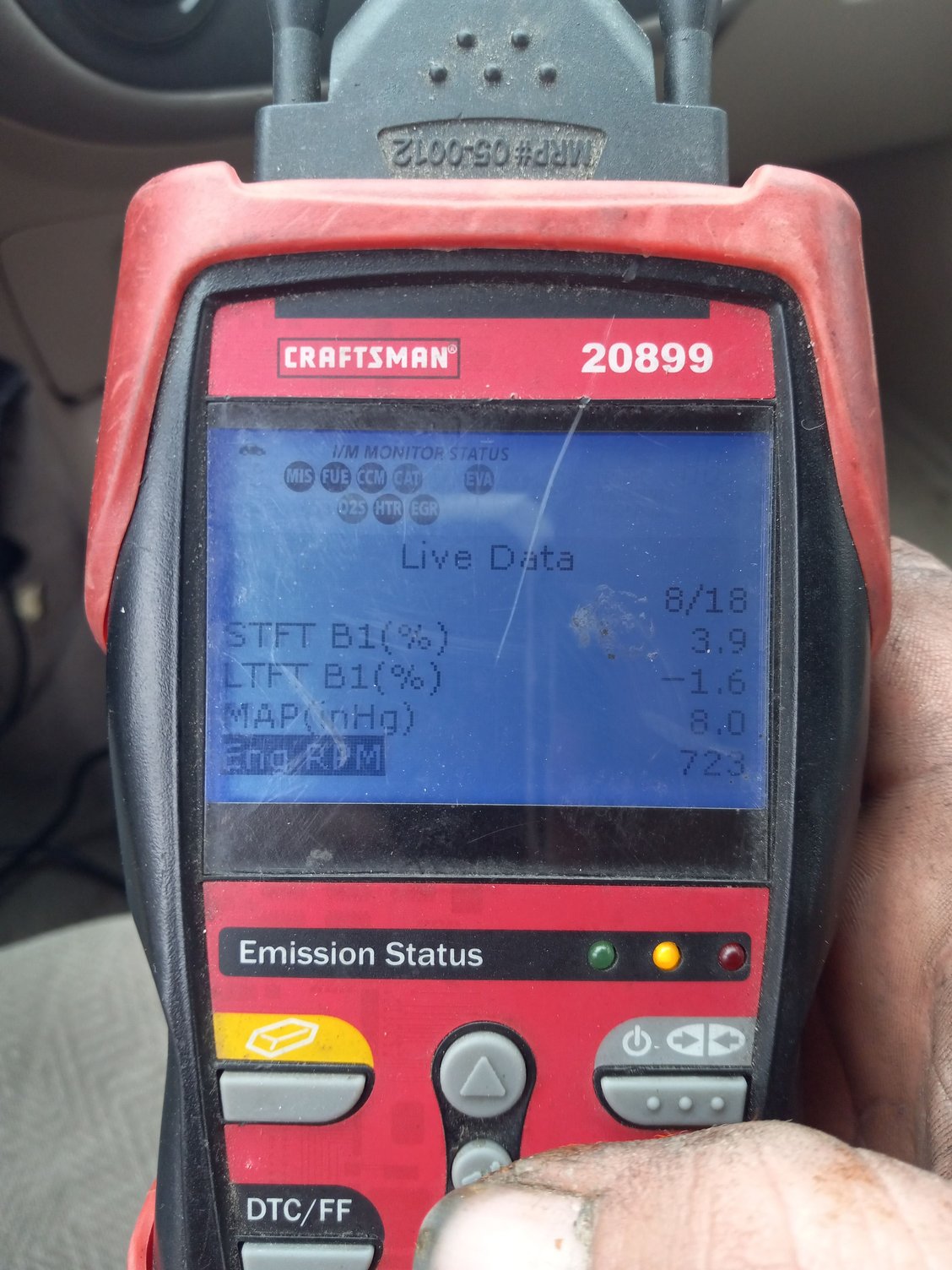

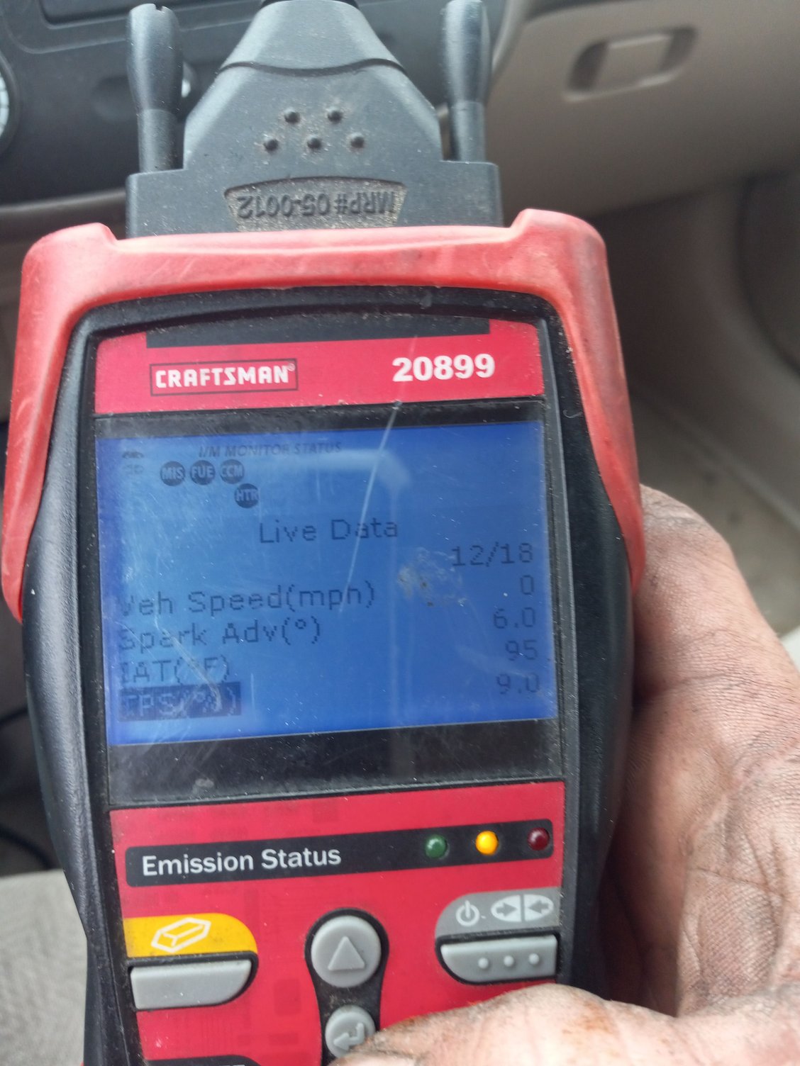

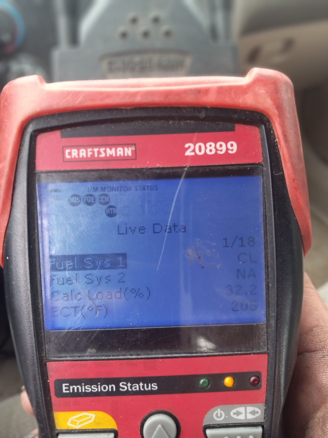

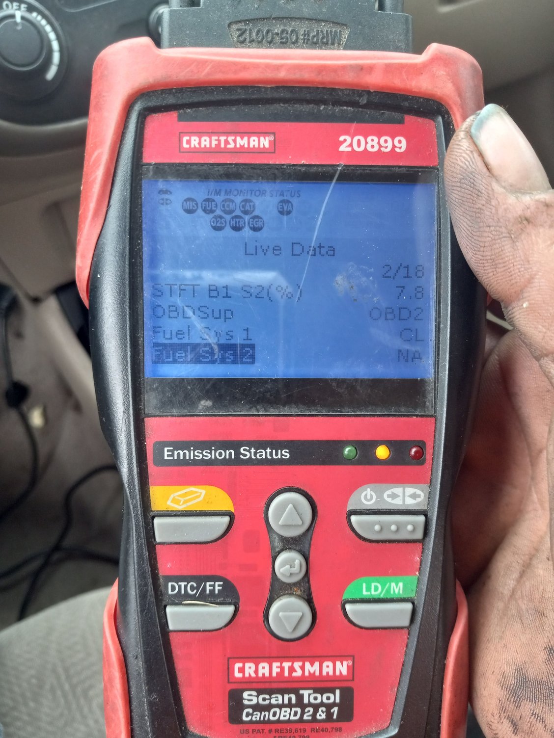

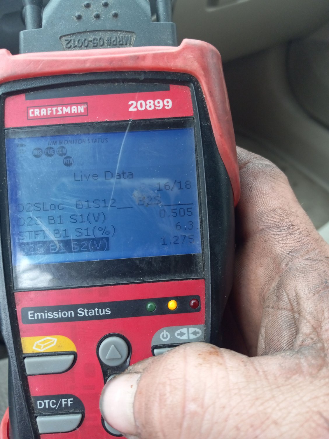

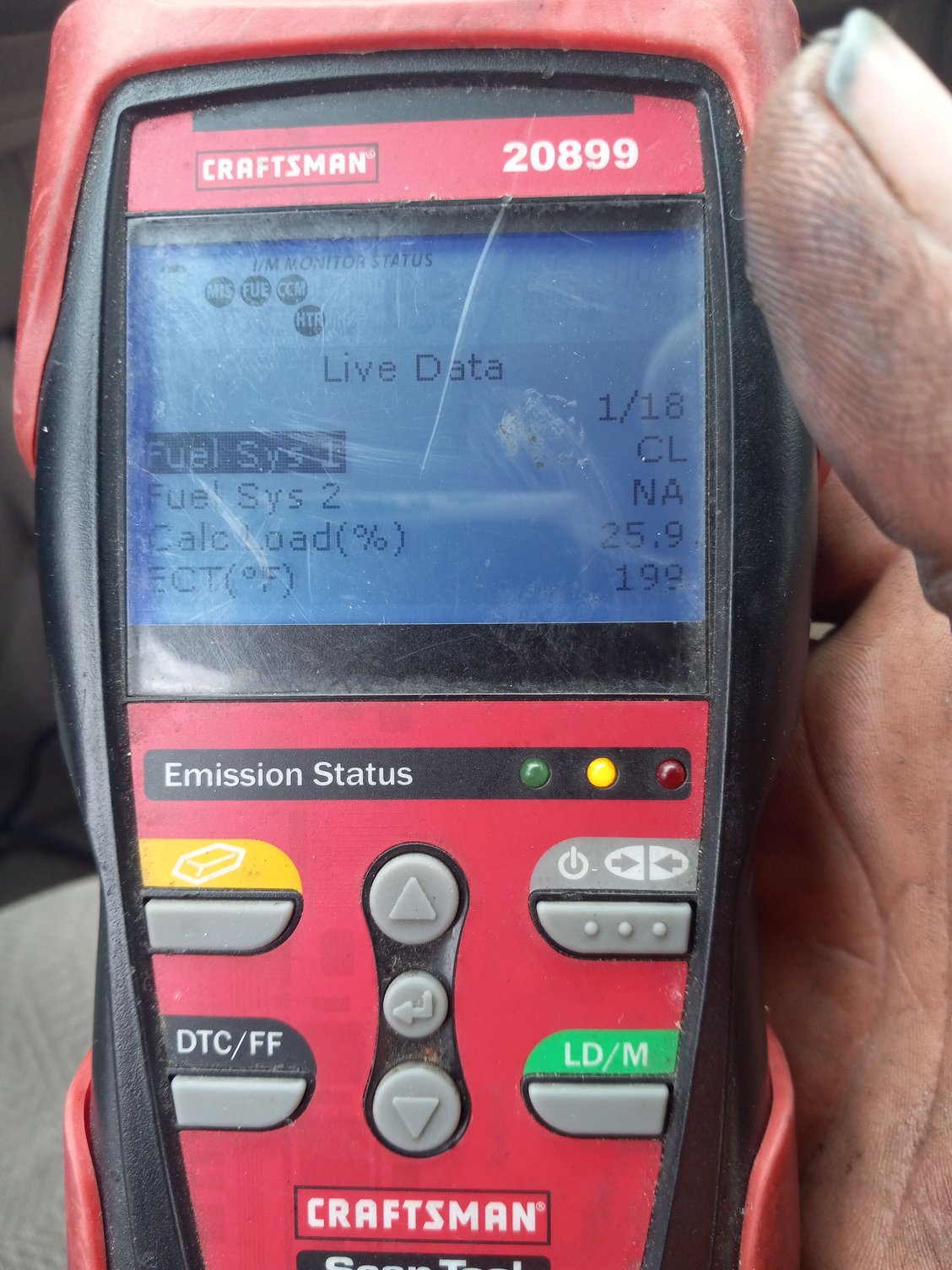

Just got home and fired it up. I let it run to see how long it would last. A few times it sounded like the motor was gonna die. But it didn't once it warmed up the motor sounded good. ABS light is on so I put the scan tool on it and checked abs but no dtc for it. So I hit erase codes. It said to turn off engine then restart it. Upon restarting it wouldn't start like as if the battery was dead. Any idea?

Still no dtc's, used to different scan tools and they shoe nothing. And the battery is constantly draining. I charged it. It was at 12.3 volts, put it back in the car by the time I drove the short distance and back and parked it the battery died within minutes

clean the engine, find the leak
the battery light might be the belt oiled up and it is slipping.
check if the oil filter does not have two seals
the smoke will not show up in the scanner
