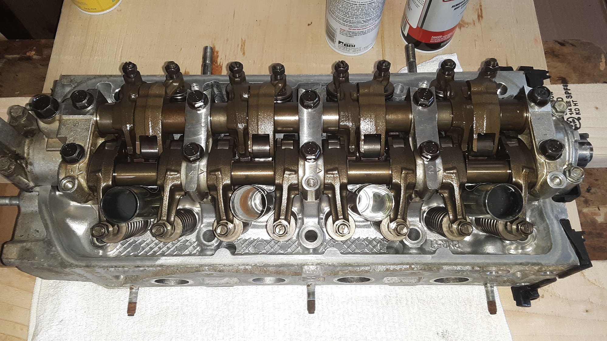

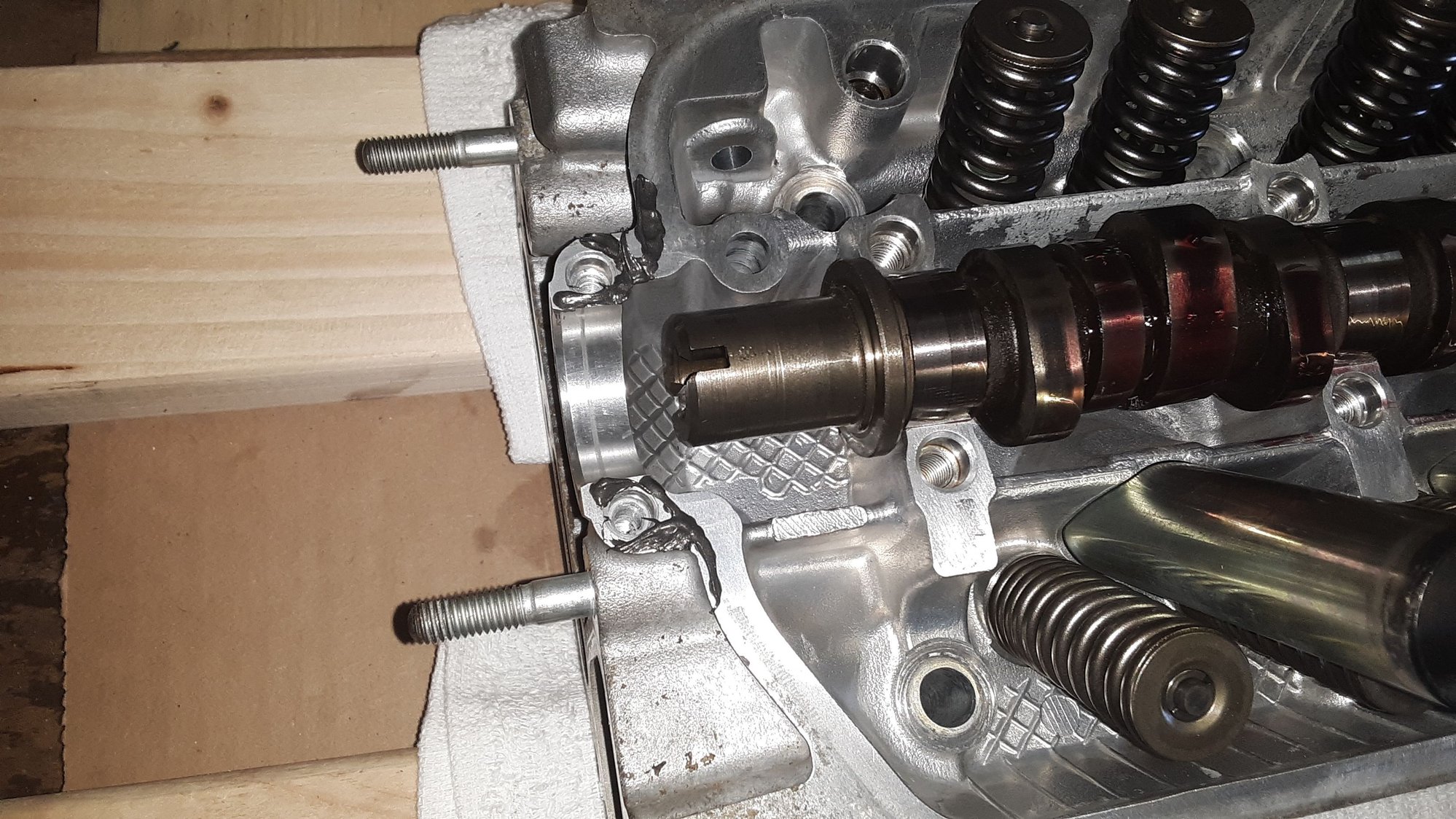

Re: Head gasket replacement

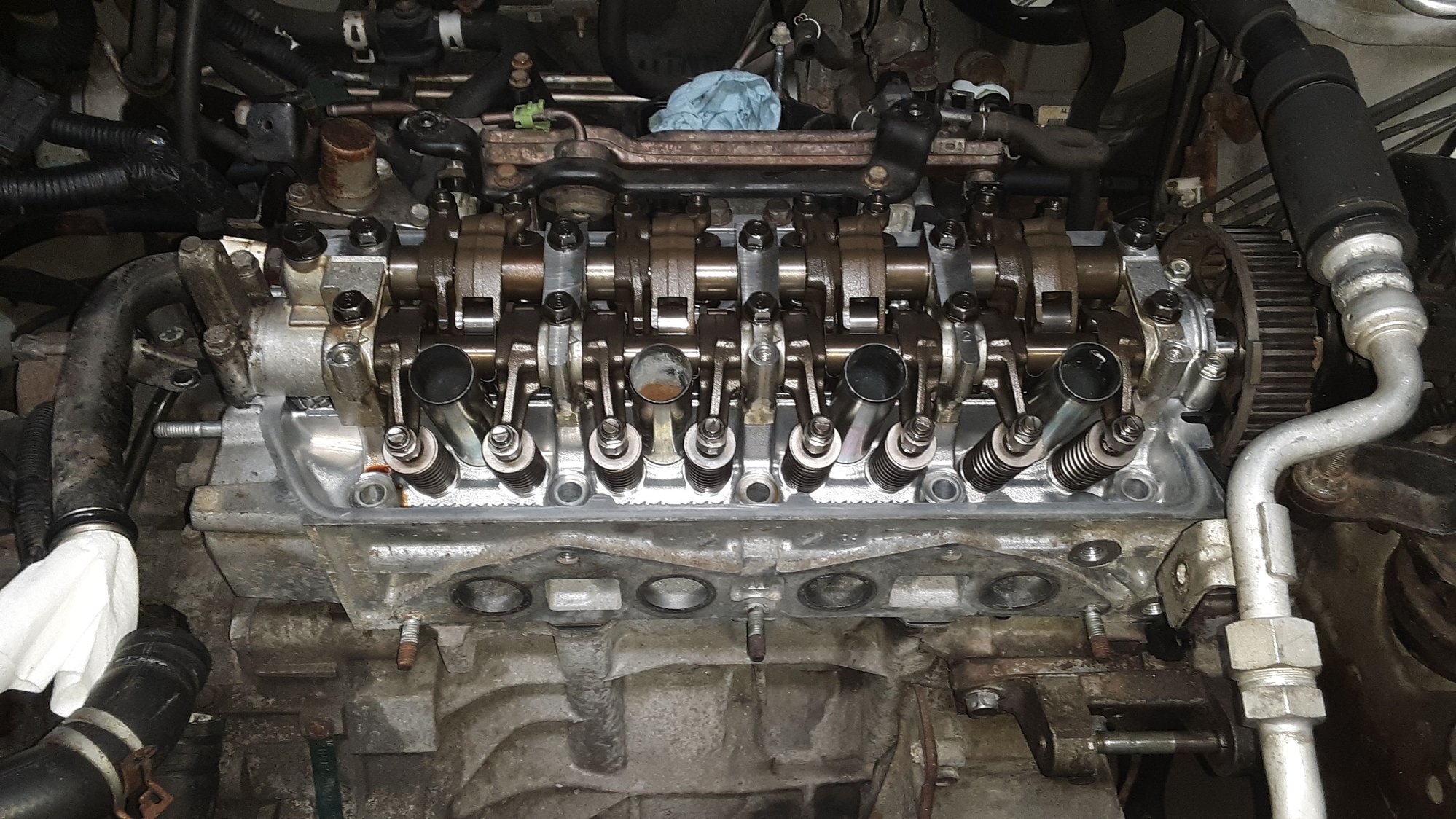

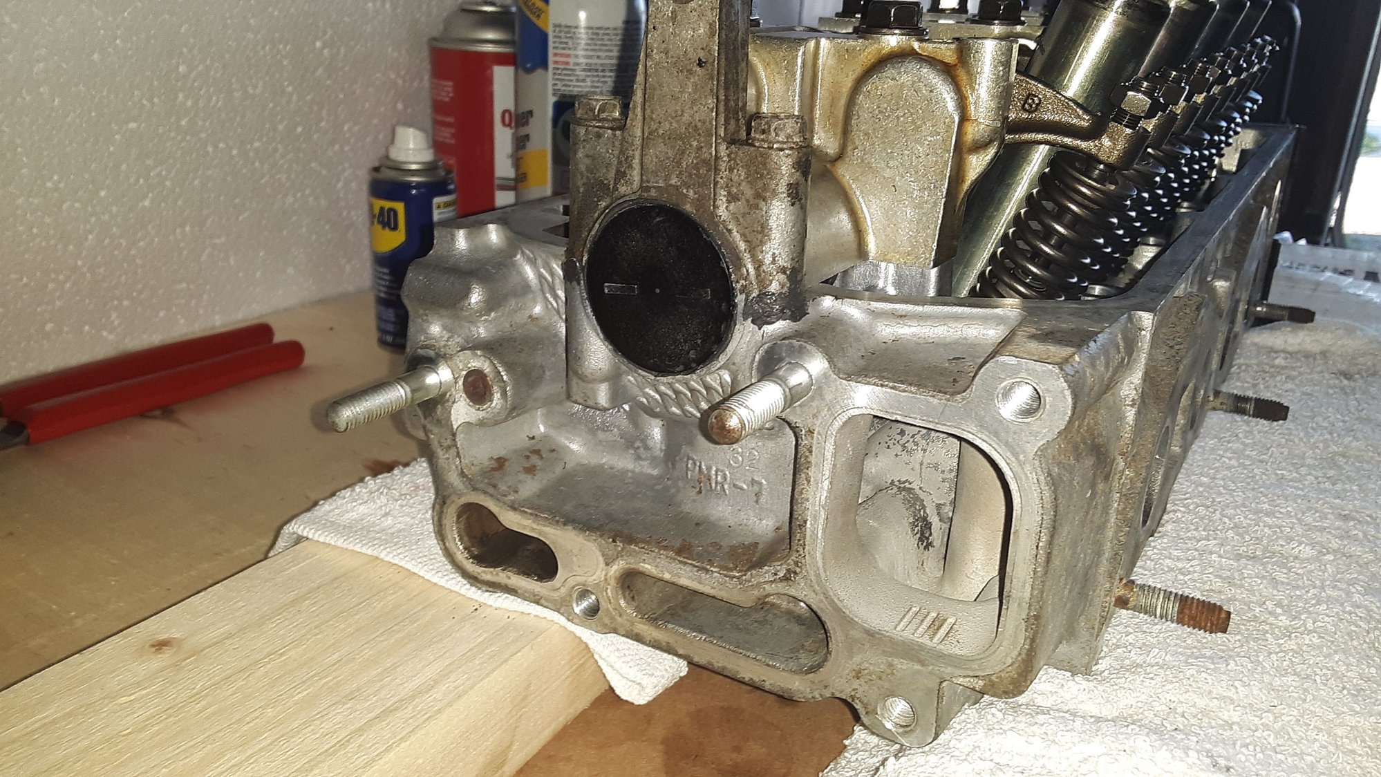

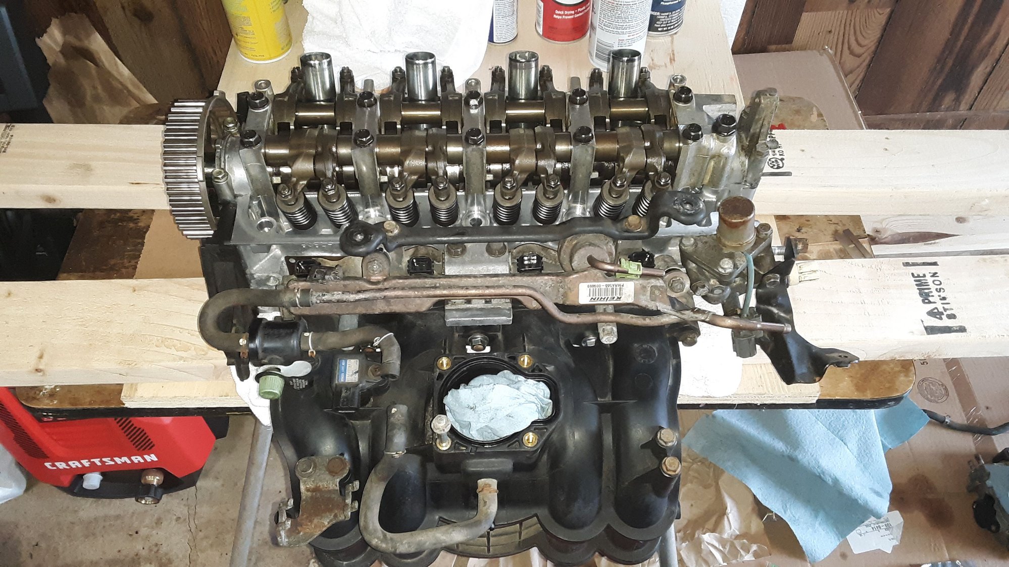

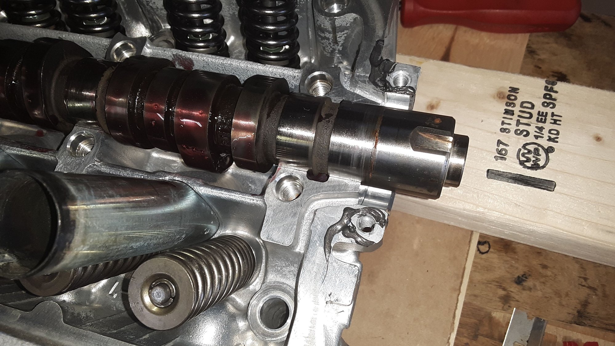

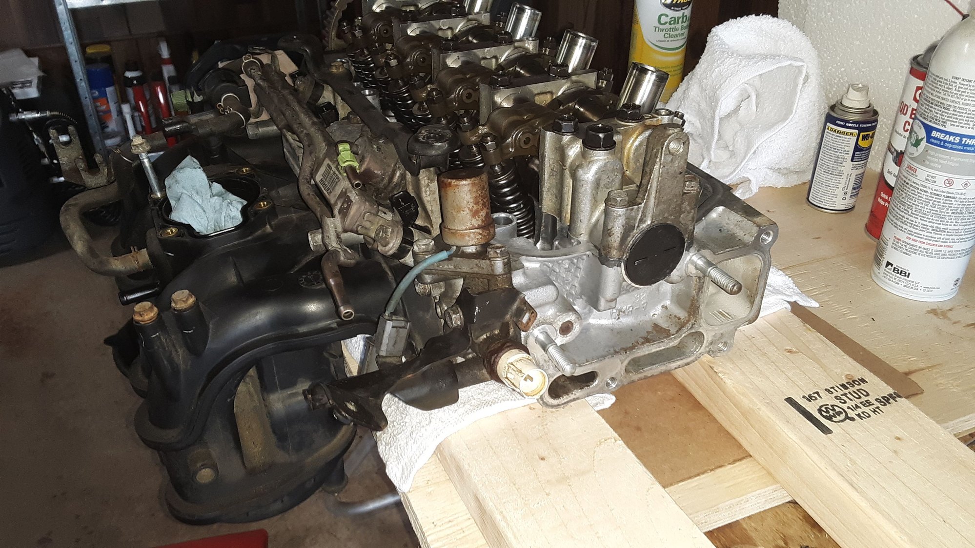

DAYS 8 & 9

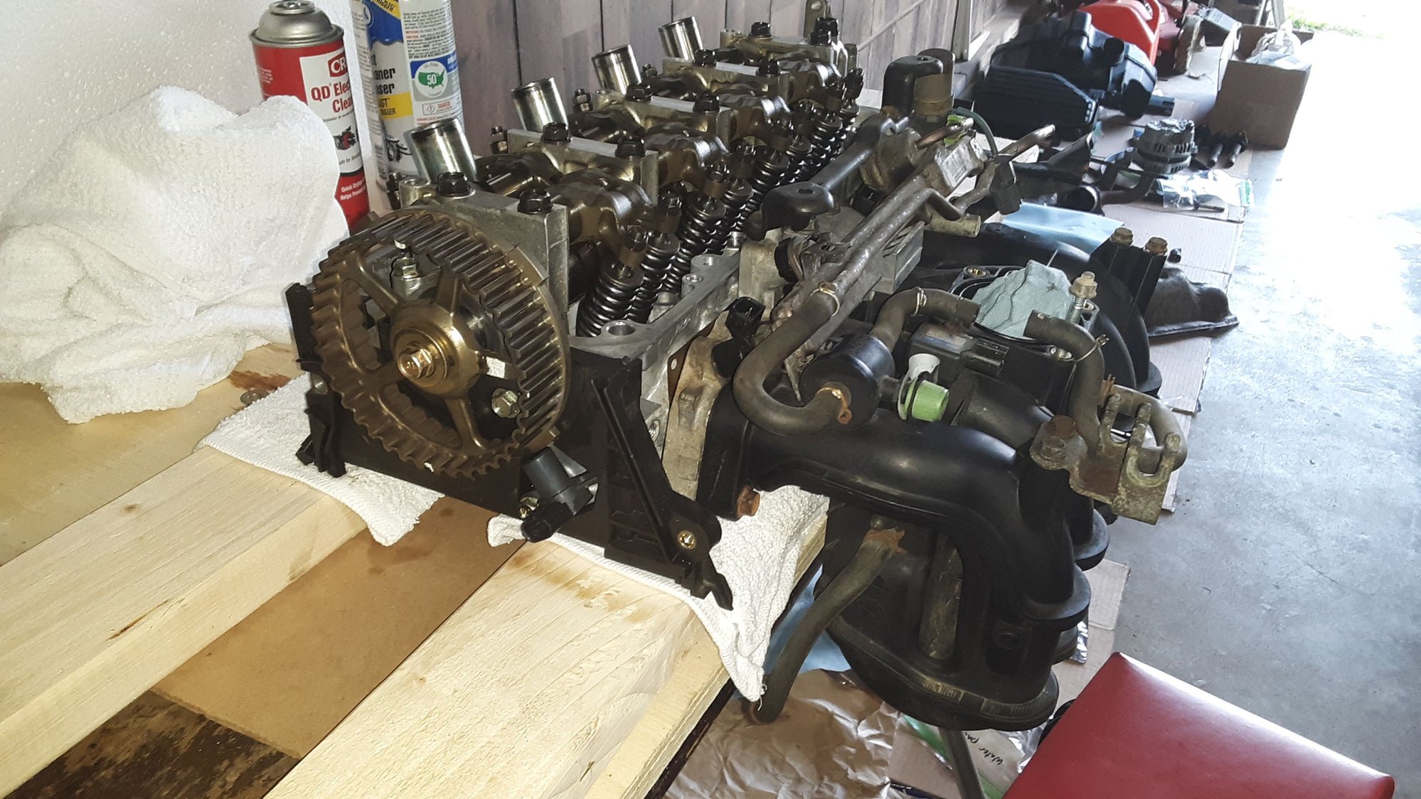

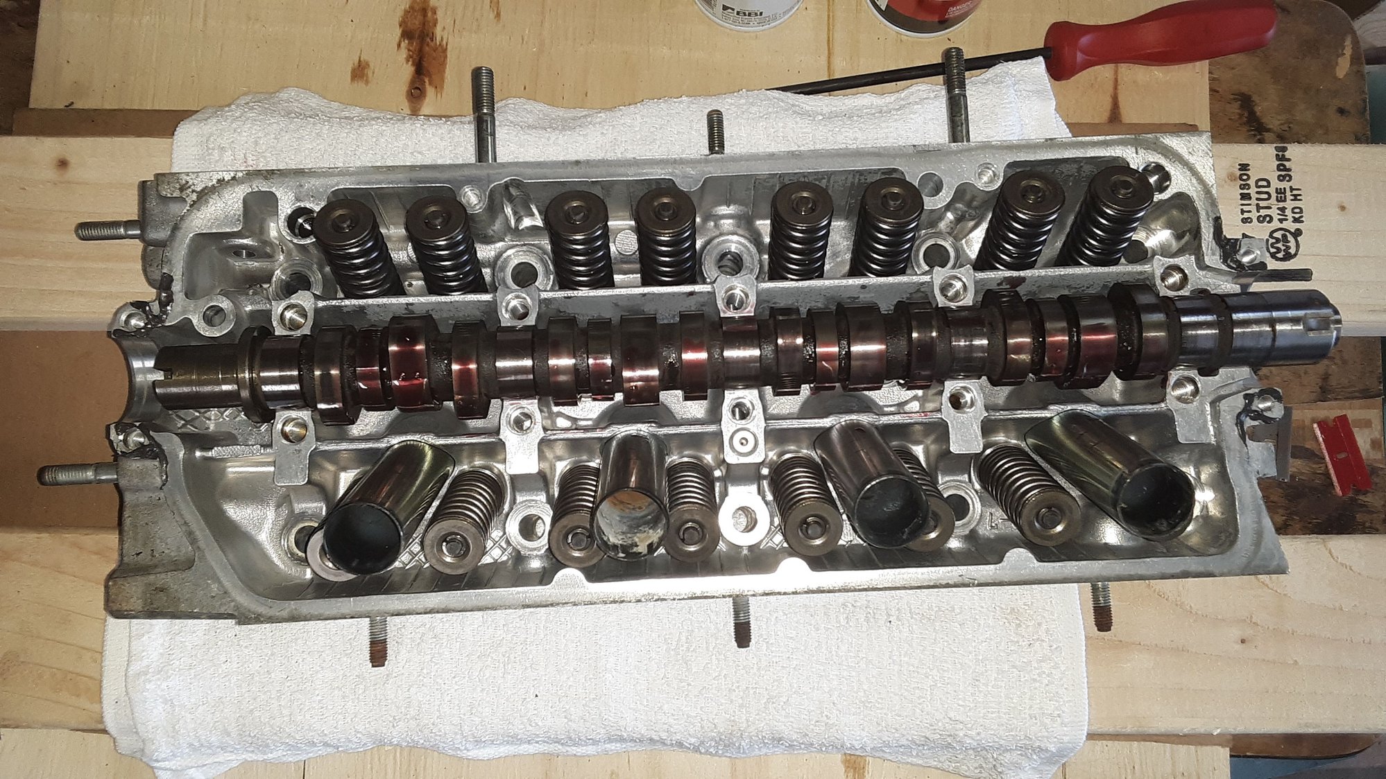

1. Prepare the cylinder head for installation
- install used camshaft, install rocker assembly and cam gear, adjust valve clearances, install I.M. and fuel rail, install brackets and hoses
Everything went together pretty well. The spec for the I.M. fasteners is 16 ft-lbs but I stopped far before that. It seemed like I was going to crack the plastic. I may have only tightened to 10 ft-lbs or so.
I found the replacing of the black o-rings on the fuel injectors to be completely unnecessary. I did it, but they were a real PITA to get out and they were in like new condition at 154K miles. The lower orange o-rings were a bit dirty, but still in good shape. Unless there's a problem, I wouldn't recommend to anyone replacing the fuel injector o-rings.

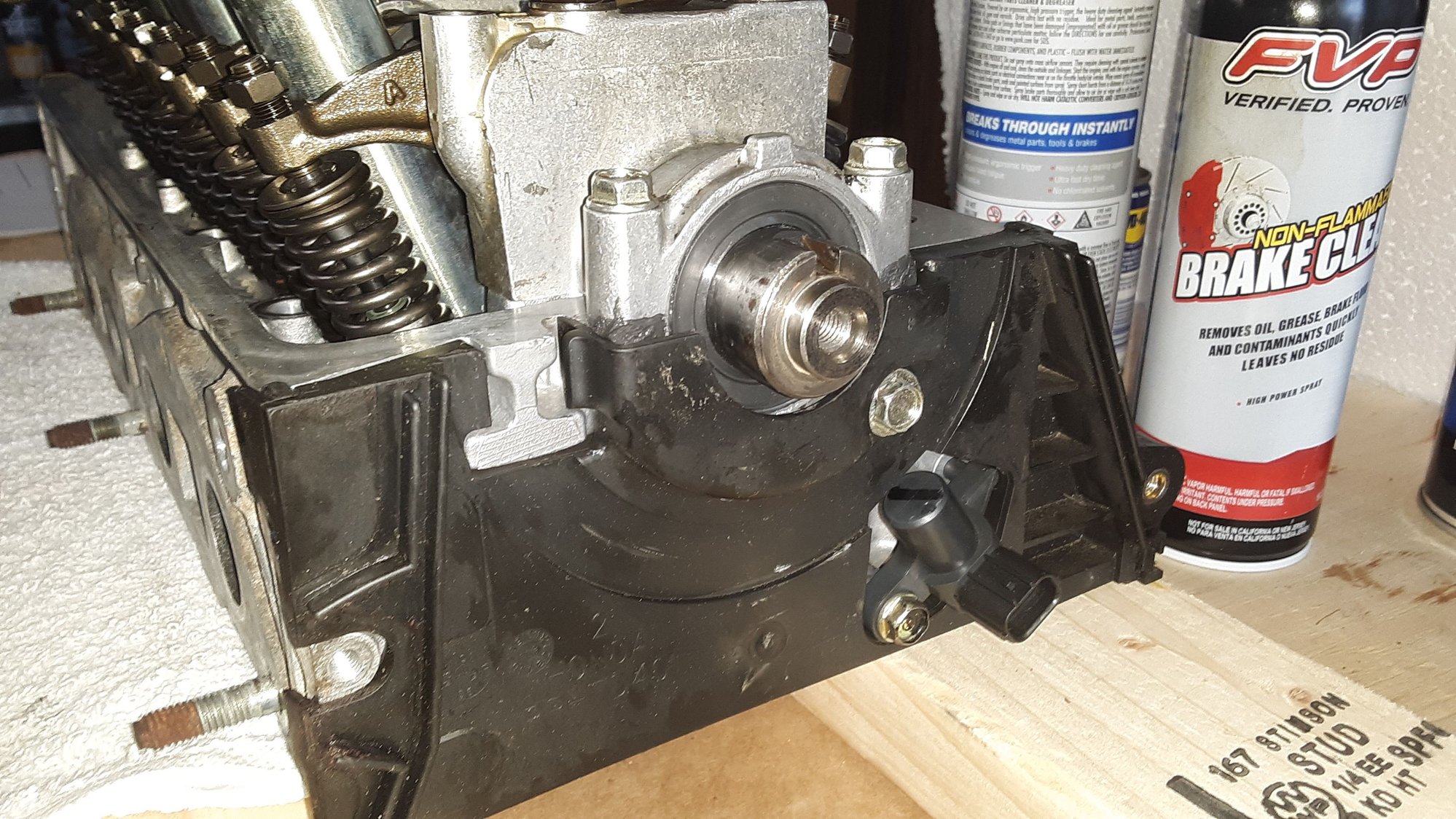

Assembly lube on camshaft
RTV on end cap
RTV on end cap
Rocker assembly installed

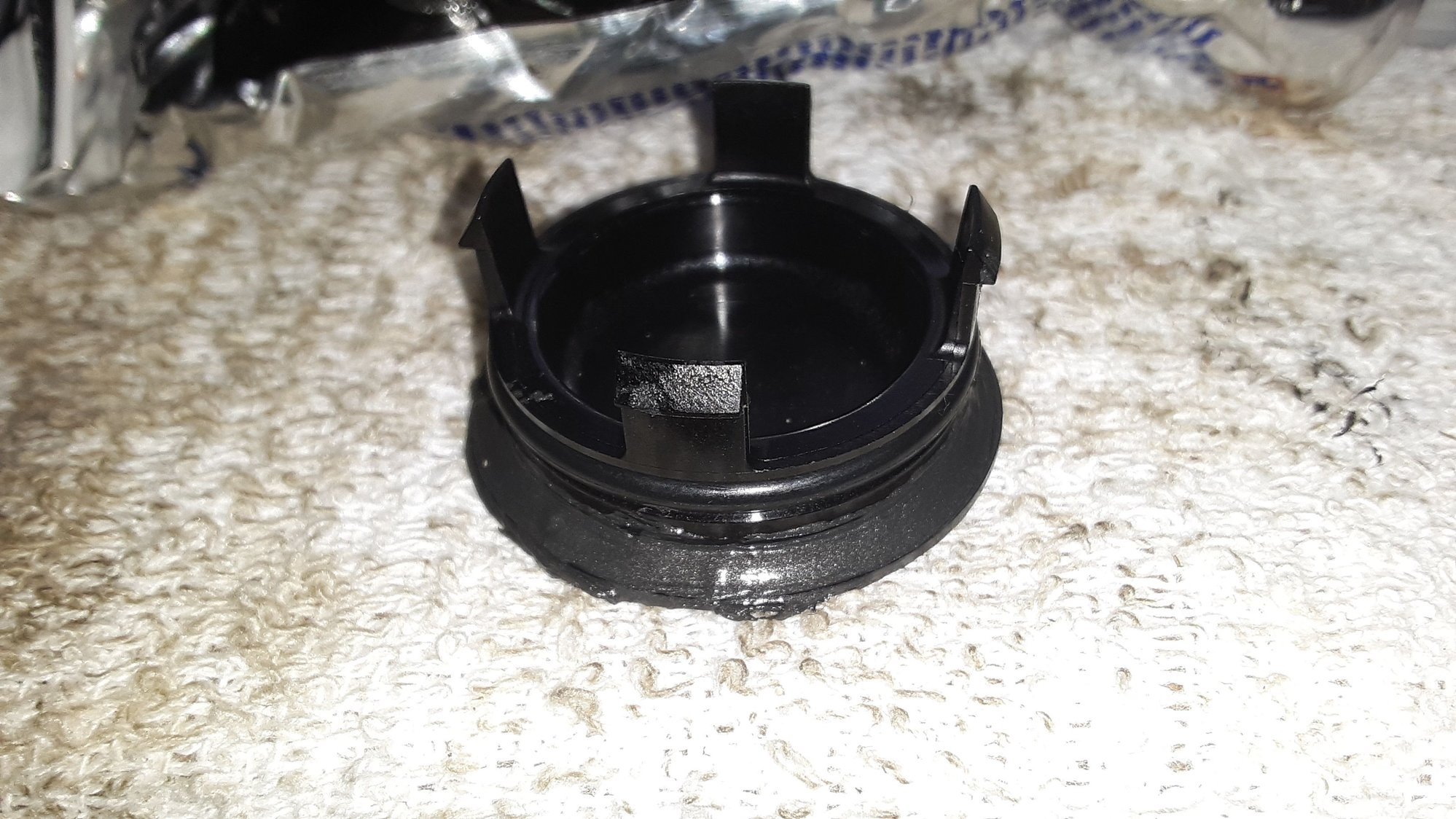

RTV sealant on inner lip of cam plug (redundant seal)
Cam plug installed
Cam seal installed
Ready for installation

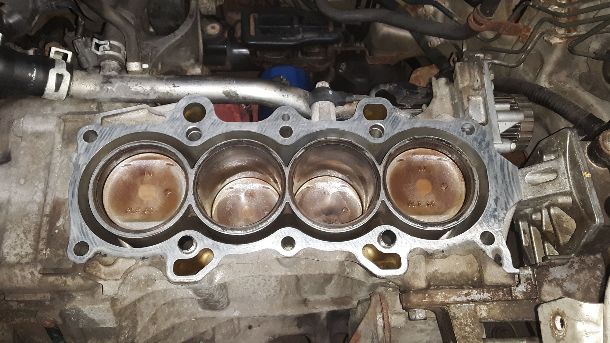

DAY 10
1. Install cylinder head
2. Begin re-assembly

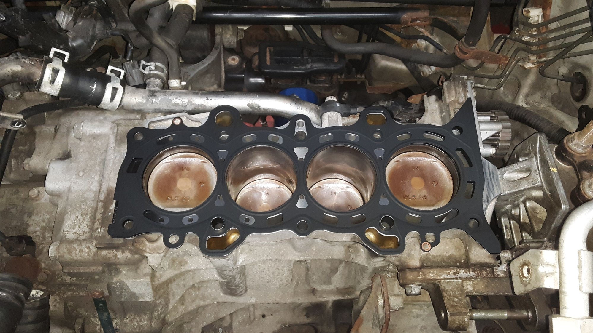

Luckily my buddy was available to help me install the cylinder head. It would have been a lot more difficult and awkward on my own.
All the head bolts torqued smoothly except one. Instead of backing it off I just "muscled" through it. I probably didn't apply enough oil to the bolt head/lip.
Everything else went together without much trouble. I did notice that even the OEM valve cover gasket likes to slip out of the groove during installation. I believe that's what happened with the Mahle one I previously installed. I think it slipped out of the groove on the driver's side and that's where a lot of the oil leakage was coming from. This time I put just a dab of RTV in the groove at each corner of the half circles. I think it helped keep the gasket in place.
I am almost ready to fire it up, but I wanted the RTV on the valve cover gasket to fully cure.
Block cleaned best I could get it
Honda head gasket
Cylinder head installed

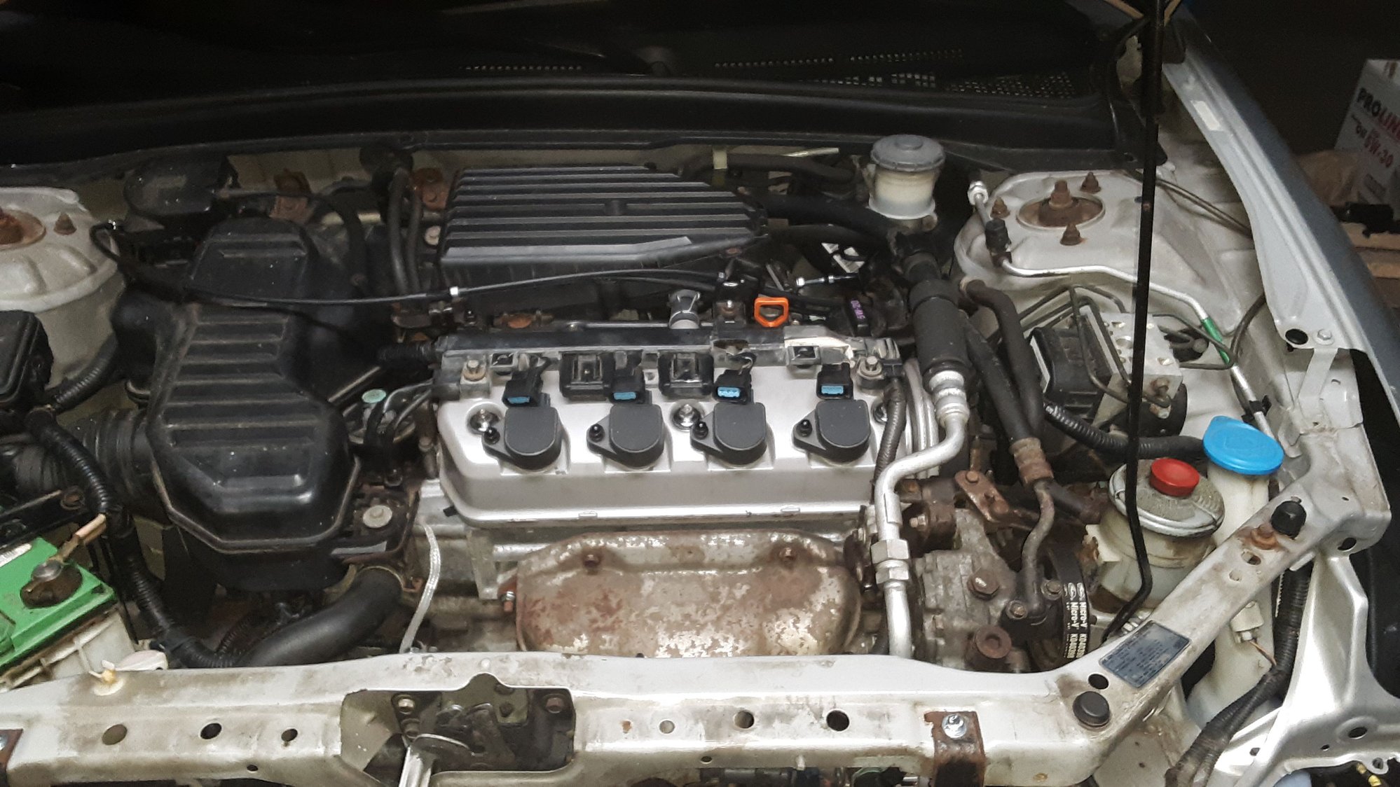

Engine back together
