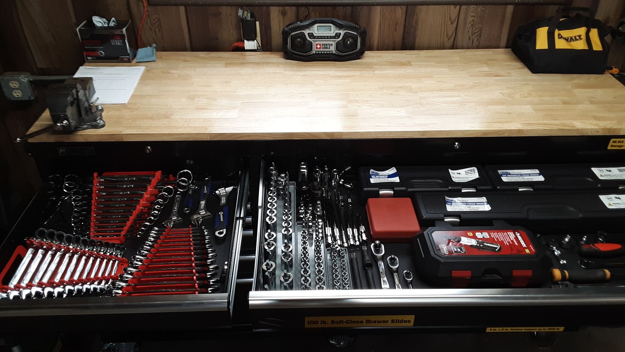

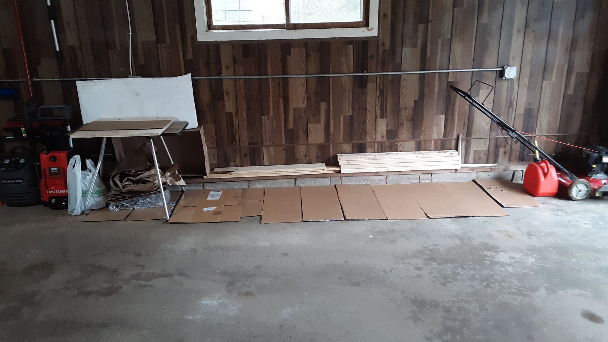

DAY 1
1. Sweep out and organize garage to make room for everything.
2. Organize all recently purchased new tools in drawers
3. Come up with plan on where to put everything as it's disassembled (tools, parts, hardware)

4. Perform compression test

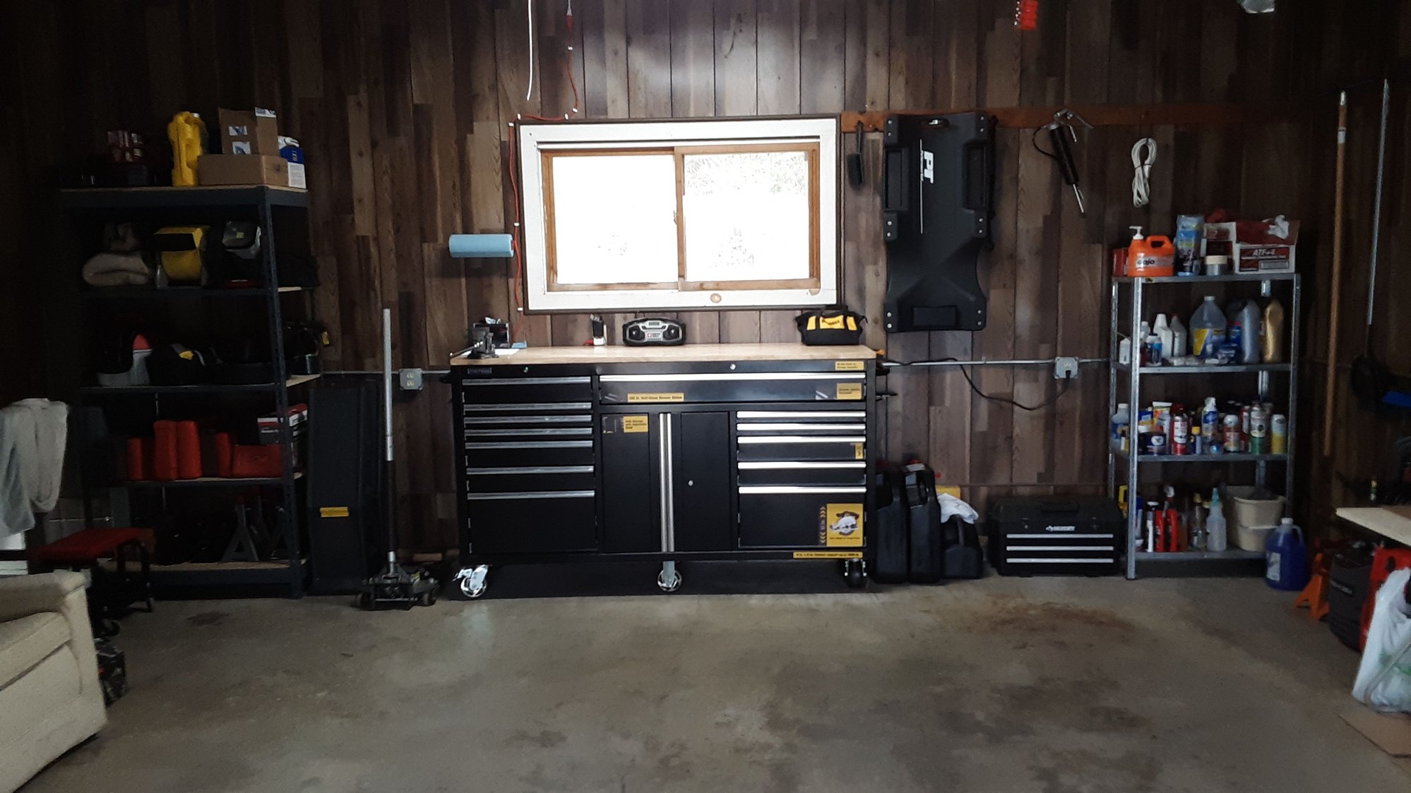

Garage and tools have been organized. Got a table setup for the head to go on. Compression test went well.
Compression Numbers:
Cyl #1 --> 200 psi
Cyl #2 --> 195 psi
Cyl #3 --> 173, 177 psi (did this cyl twice)
Cyl #4 --> 189 psi
Specification is minimum 135 psi with maximum 28 psi variance. Cylinder #3 is just barely in spec (variation). I'm assuming cyl #3 is where the head gasket is leaking into the cooling system. We'll see if that's true.
Overall, good compression numbers. This engine should be worth the time and money.
Space for parts and hardware
Garage setup (friend's garage)
New tools in drawers

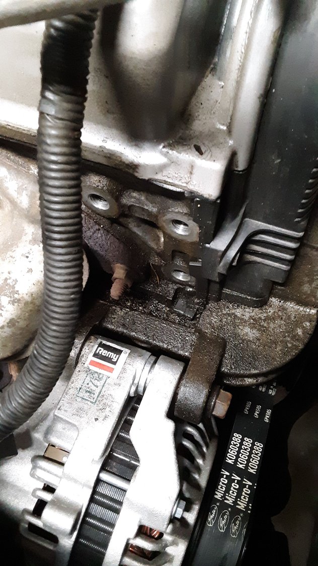

I have most of everything disassembled. I still need to remove the intake manifold and then OFF WITH THE HEAD!
NOTES:

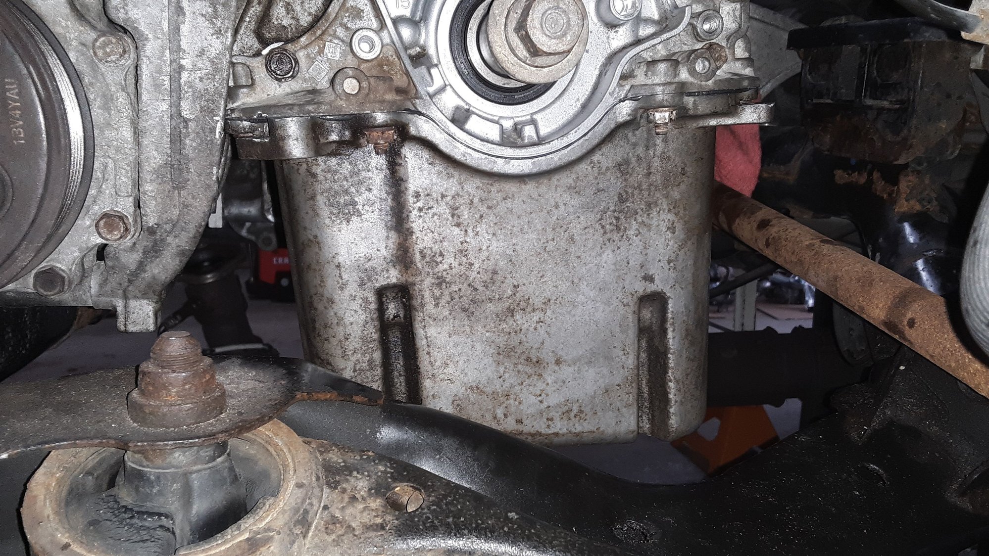

1. Removing the PCM/FI relay took some time. Turns out the relay is held in place by tabs on either side. The tabs must be spread out before pulling the relay out. I may have missed that in the how-to thread. I gouged up the relay with the pliers trying to pull it out.
2. The valve cover gasket I installed last time I had the cover off did not seal well at all. It was leaking almost all the way around. I'm not sure what happened there. Bad gasket (Mahle)? Incorrect torque?

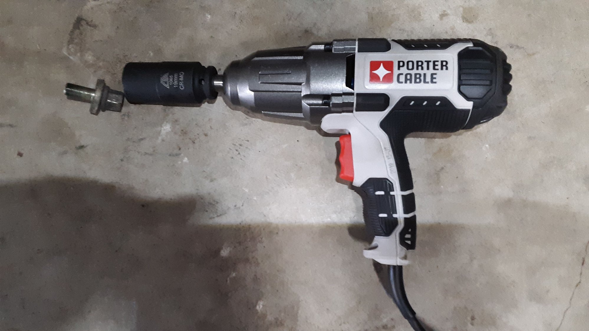

3. A corded impact wrench and the heavy duty 19mm Honda crank bolt socket made short work of the crank bolt. I had it off in 2 seconds
4. Most of the leaking oil is all behind where the alternator mounts and down behind the A/C compressor. But there is oil residue on the firewall side of the engine also. What is that leak source? I'm still unsure if the oil pump housing is the cause since the timing belt is still on.
Could be a combination of both. Hondabond or equivalent is also supposed to be used in some spots, not sure if that was done.
What torque rating does your impact have? Is that one of the big weighted sockets?
Oil that high up is going to be valve cover gasket or maybe the camshaft seal. It's going to be impossible to tell if oil is leaking further down because of that. While you're there I would definitely recommend dropping the oil pan, removing the oil pump, and replacing the crankshaft seal as well as the rubber O-ring between it and the block. Not much more work while the belt is removed and would save you lots of work in the future.
I used sealant (Ultra Black) at the corners for the valve cover gasket. The leaking, however, was along the long edges (front of car and firewall sides). I do not think all that oil in the pic is coming from the valve cover though. Besides, that oil was pooling there a little bit a couple years ago when the valve cover gasket was replaced. The valve cover gasket wasn't leaking then.
The impact wrench in the pic has a torque rating of 450 ft-lbs. I don't think that's breakaway torque...maybe it's working torque. And yes, that is a large, weighted socket. The P/N is CTA-1065. I purchased it at jbtools.com for about $25 shipped.
My plan was to remove the oil pump again (I did this two years ago) and re-seal it. I have the new o-ring from Honda coming. But it really is hard to tell if there is leaking at the cam seal, crank seal, or oil pump housing. Everything behind the timing belt covers looks clean and dry. I'll have time to REALLY look at everything before the head goes back on. Hopefully I can seal everything right this time.
If it's clean under the upper timing belt cover then that rules out the camshaft seal. Maybe it wasn't the valve cover gasket leaking but the only other option would be head gasket and I have never seen a head gasket leak oil. Maybe it's just remnants from spilled oil? Or maybe it's actually power steering fluid?
I would definitely recommend a valve cover gasket from Honda. Also, follow the torque spec in the service manual. I haven't had issues getting one to seal doing this.
Nice. I tried my Milwaukee impact rated for 1400 ft lbs on my friends Civic, it would not break it loose. That was when using a regular impact rated socket though. I'm going to have to get one of these weighted sockets.
Yeah, I'm doubting the cam seal as a leak source. But I'm going to be removing the camshaft to bring the head to a machine shop, so it'll be replaced anyway (genuine Honda seal).
The leaking valve cover gasket was Mahle brand. Maybe it was no bueno. I'll be using the genuine Honda gasket this time. However, there was NO leakage inside the spark plug tubes, so I'll just re-use those seals. They're a pain to replace anyway.
Yeah, that beefy 2 lb socket really makes a difference. I was ECSTATIC at how easy it came out compared to last time. The CTA-1065 model is well made. TOTALLY worth the money

It turns out I was wrong. The cam seal was leaking for sure. The scratch that i tried to fill in with JB Weld and sand down was bigger than I thought. I don't think there's anyway to fix it. Can a machine shop ground it down and then put a sleeve on it? I really don't know.
I can get a used camshaft off eBay for $112. Then with the $200 machine shop bill, I'm looking at over $300. At that point I might as well save a 100+ mile round trip to the machine shop and get a reman shipped to me. I can just clean everything while I'm waiting. What's a good place to buy a reman cylinder head? I'm sure this has been asked before.

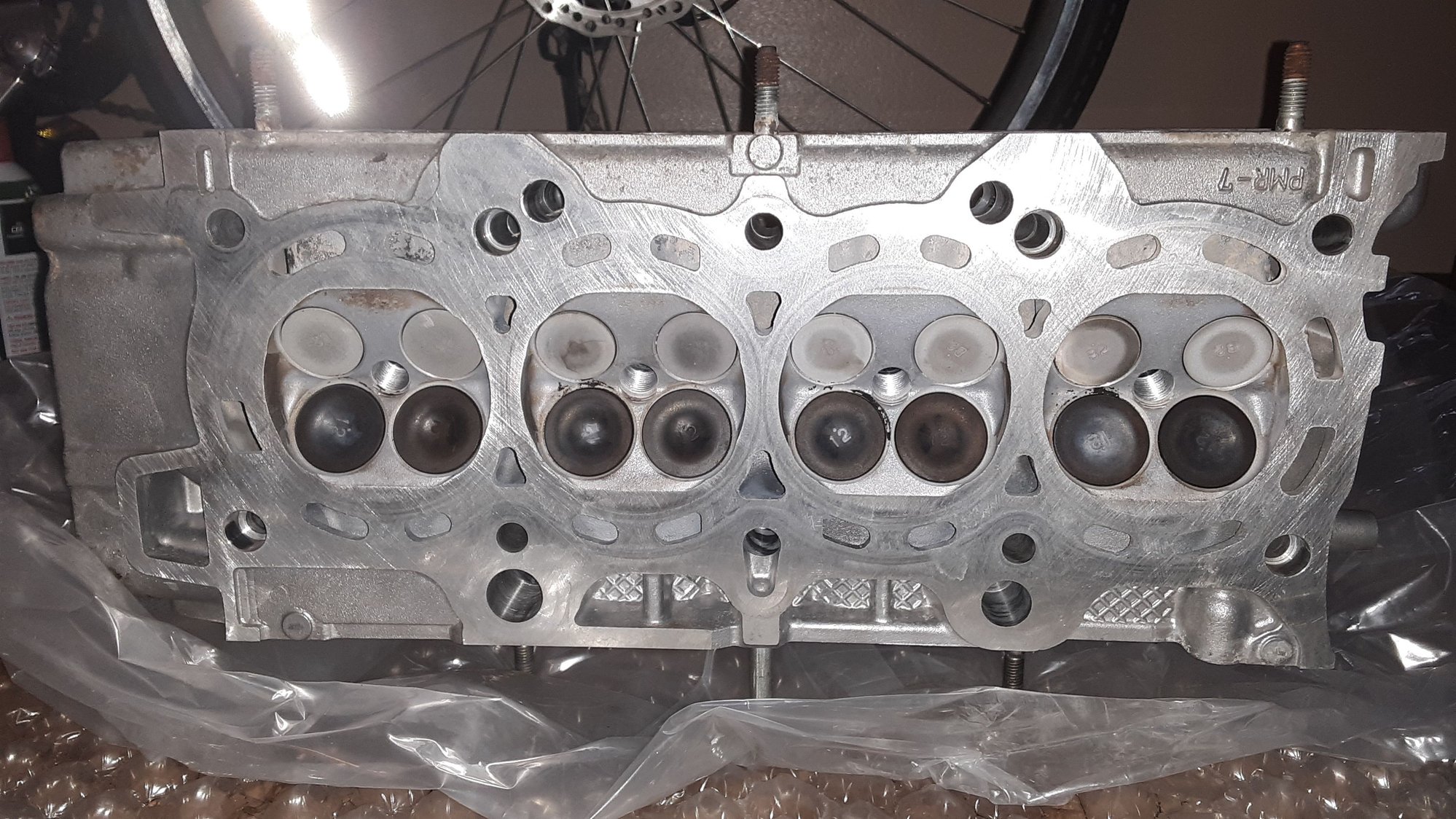

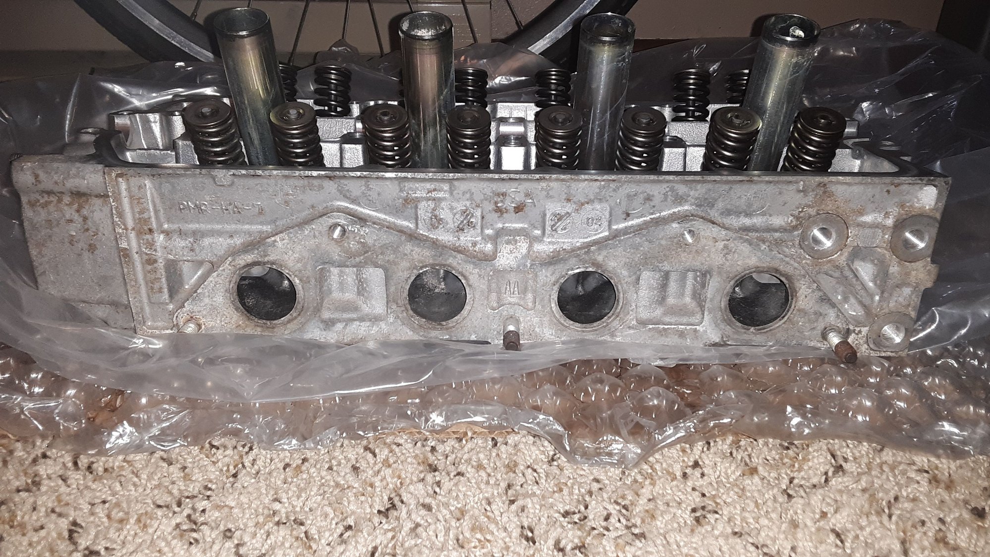

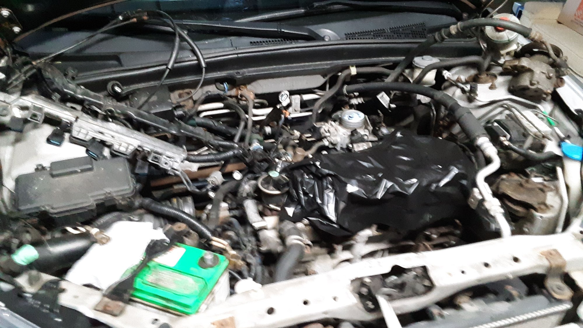

I've got everything disassembled. I'm currently debating if I should keep my current cylinder head and have the machine shop take care of the camshaft (or replace it) or if I should just order a reman cylinder head. I have to talk to people at the machine shop to see what my best option is.
In the meantime....
DAY 3
1. Replace radiator
2. Replace throttle cable
If time and energy permit,
3. Remove inner and outer tie rods
Head off
Oil pump off

At this point I have the new radiator and throttle cable installed. It didn't go as smooth as I wanted it to go, but it's done. The two upper radiator bracket bolts sheared off. So I had to drill those out, tap them, and get new hardware. I bent quite a lot of fins trying to get the new radiator back in. No major damage, but more than I was hoping for. Not the greatest design by Honda in terms of serviceability (in my opinion).
The cylinder head and camshaft are currently at the machine shop. I gave them all the new valve seals if they need to use them. The guy there looked at the head surface and said, "This has already been machined. Honda head surfaces don't look like this." What?! I didn't expect that response!

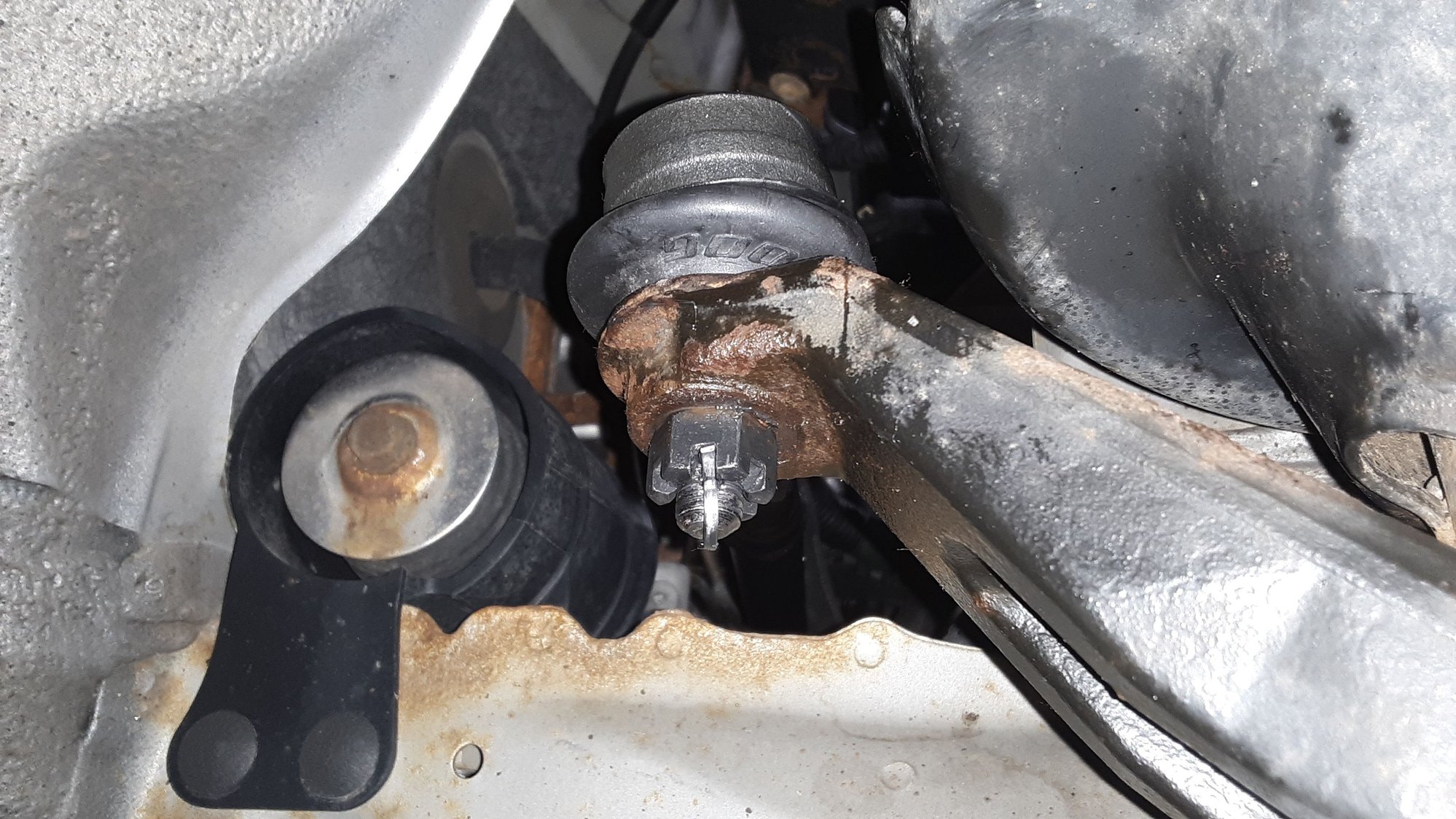

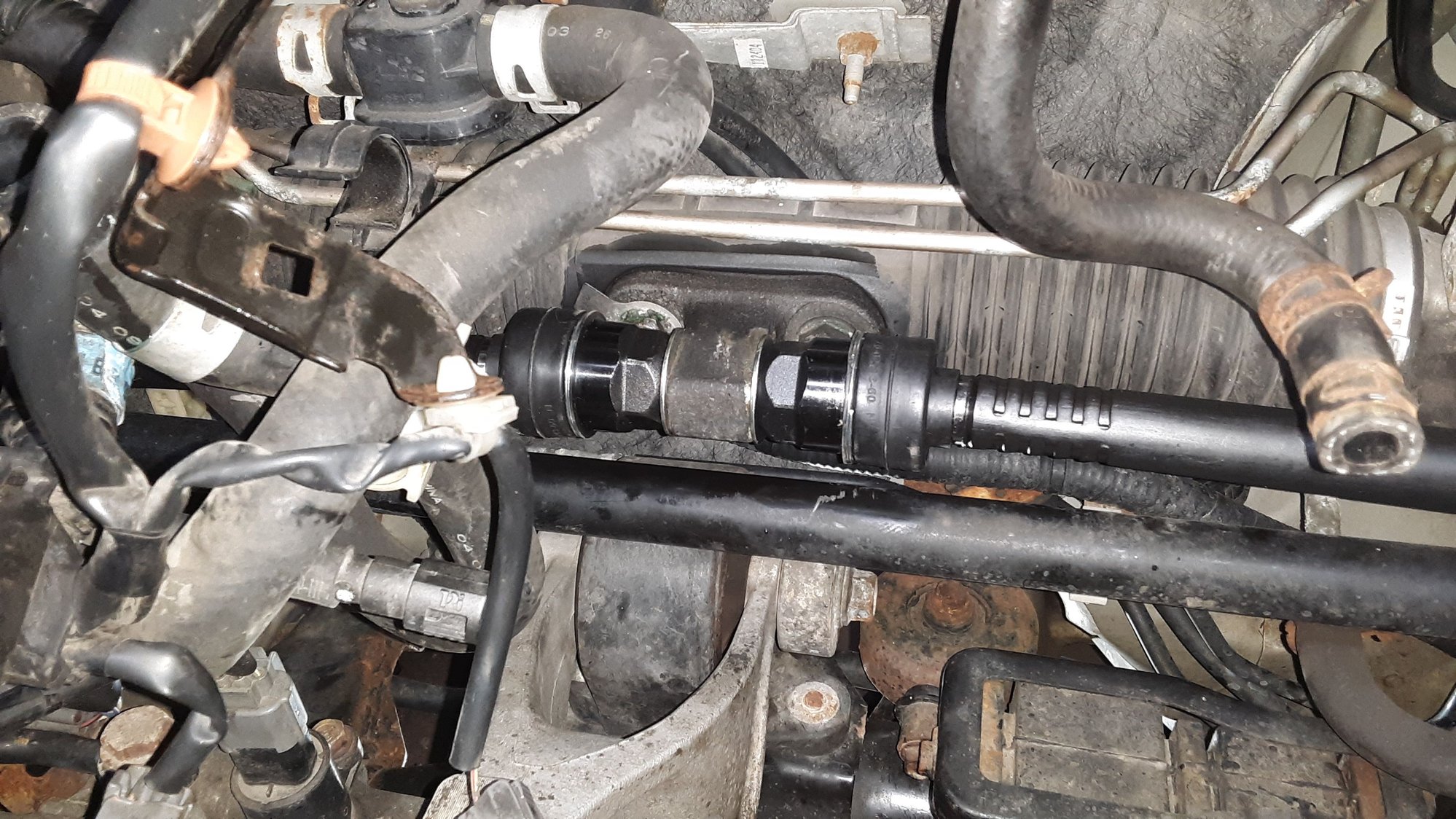

3. Remove inner and outer tie rod ends

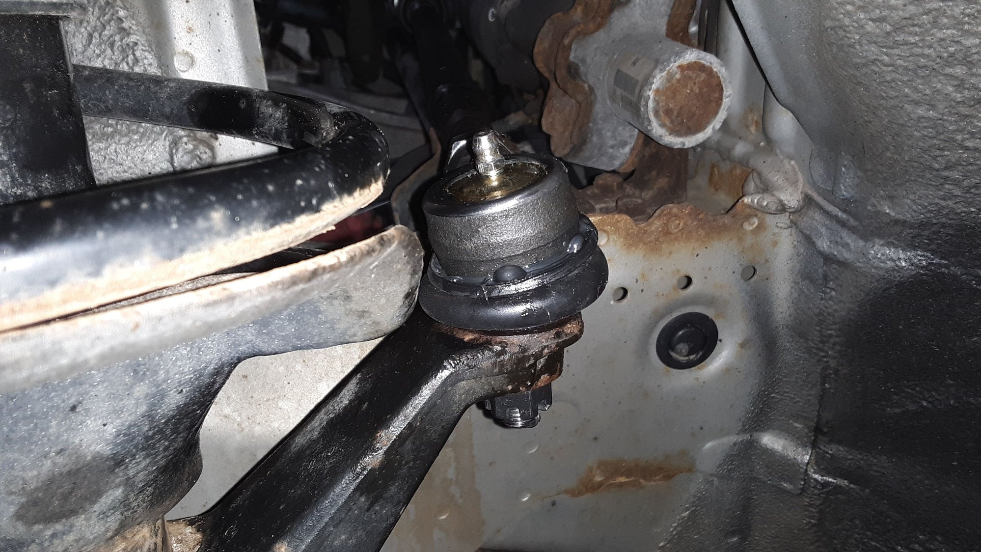

Oil pump with new Honda o-ring is installed. I have a lot of the old RTV cleaned off, but I need to do a final pass before installation.
The inner and outer tie rod ends are both removed. I don't know if they were original or not, but they were still in pretty decent shape. There was no play in any of the joints, but the outer ends felt like the grease was gone. The new Moog tie rods came in yesterday.
The gasket for the oil strainer should be here today or tomorrow.
DAY 5
1. Clean pistons and bottom end (use brakeleen for bottom end)
- I used Berryman's B12 to soak the piston tops, so it probably all drained down. Just needs cleaning before oil pan goes on
2. Clean oil strainer and oil pan sealing surfaces. Clean oil pan bolts.
3. Install the oil strainer with the new gasket
4. Install oil pan
5. Install tie rods while waiting for RTV to cure
6. Torque oil pan fasteners
7. Install trans gear selector cable, covers, and stiffener brackets
New radiator installed
Oil pump installed

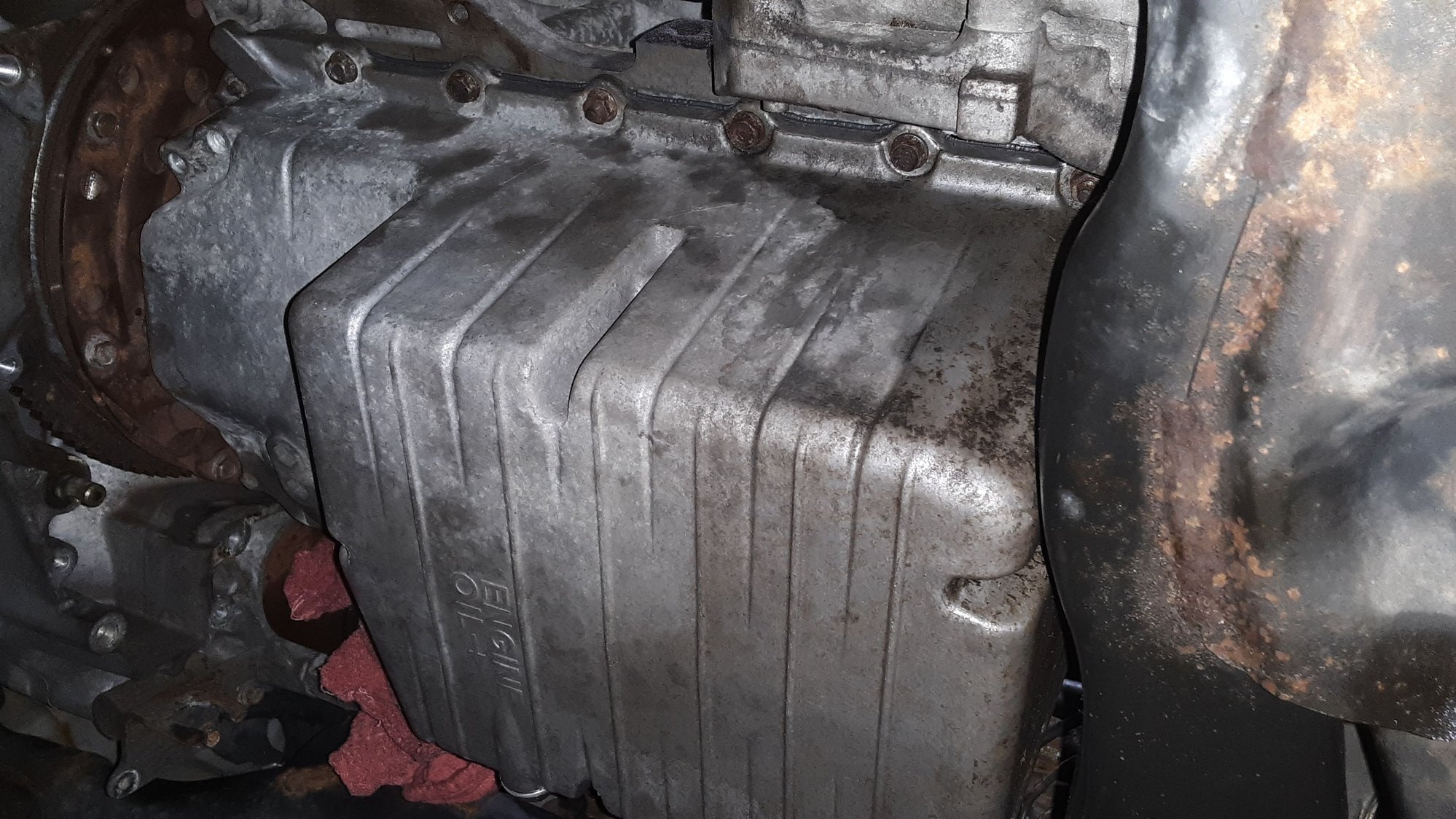

Re: Head gasket replacement
Got the oil strainer, oil pan, and tie rod ends installed. All went fairly smoothly. I may need an alignment after all this, but I'll probably forget and wonder why my steering is off.
I'm still waiting for the machine shop to call me. They said they could get the head done in a day, but the speedi-sleeve they ordered for the camshaft had to be ordered. Maybe they'll call me Monday.
Until then, I'll be cleaning everything and installing new seals/o-rings in preparation for re-assembly. I have to remember to oil the cylinders before putting the head back on...the Berryman's B12 probably cleaned out all the lubrication.
Oil pan installed
Oil pan installed
New Moog inner tie rods
New Moog outer tie rod end

I plan to install the intake manifold to the head before installing the head. I think this will work...we'll see. I also need to adjust all the valve clearances.
Old May 8, 2021
Posts: 15,190
Likes: 1,609
i removed the head/reinstalled it with the intake.
just remember it is made of plastic.
removing some of the rubber hoses was a PITA, but it really do come out and in. I removed the intake after the head was off.
make sure to tighten the knock sensor before you install the head back... I forgot to do this...
Old May 9, 2021
Rep Power: 513
Installing the IM on the head is loads easier than trying to finagle that summabitch on with the head attached to the block. Some of those nuts/bolts are stupid hard to get on otherwise.
I've been thinking about this in regards to head installation. If I install the I.M. on the head before putting the head on the block, I will need to connect the brake booster and PCV valve hoses on the I.M. before setting it in place. Those hoses are really difficult to get to once the I.M. is installed. But that shouldn't be too bad if my friend helps me put it in place.
After the head is in place, I think it's all downhill from there (in terms of difficulty).
PROGRESS...
At this point I am just waiting for the machine shop to call me back so I can go pick up the head and camshaft. Everything is pretty much clean and ready to install. I just have to install the new fuel injector o-rings.
The I.M. gasket should be easy to see which way it installs, but what about the exhaust manifold gasket? It looks like it may be the same on both sides.

Machine shop ordered the wrong size speedi-sleeve and told me it'll be a week before another one comes in. I can't wait that long. I need this done by the end of the week. So, I decided to buy an entire cylinder head from a local salvage yard...have it shipped to me. Hopefully the camshaft is in good condition since that's all I really need. I may need a couple alignment dowels for the rocker assembly since I seem to have misplaced a couple.
At least the cylinder head is cleaned and ready to go. They really didn't do anything except clean it since no problems were found.
I'll have to transfer the used camshaft, install the rocker assemblies, adjust valve clearances, install seals, and install the cover, sprocket, and cam sensor. Oh yeah...the I.M. too.
