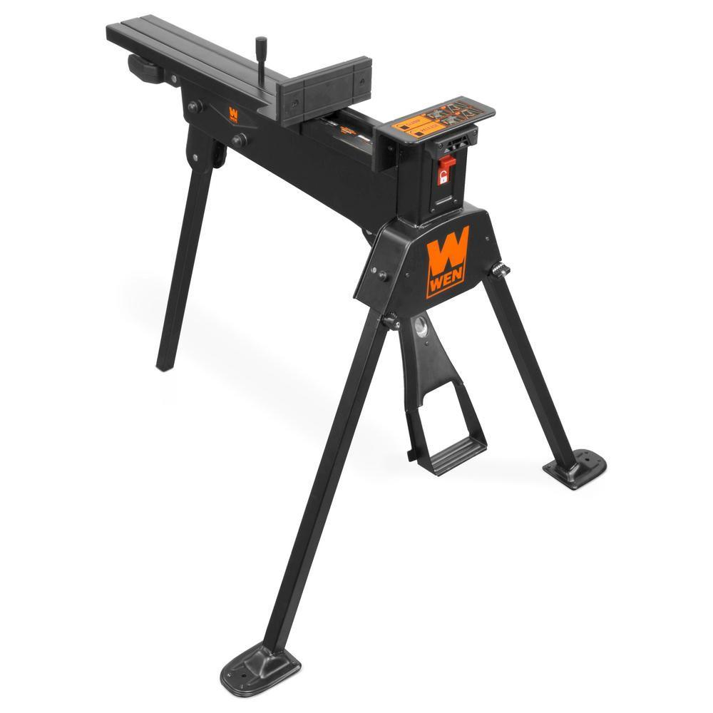

One set does both left and right control arms (comes with 4 bushings total). The removal process of the OEM bushings is quite destructive, even per Energy Suspension's instructions -- they tell you to take a hacksaw to the rear bushing's (the one whose bolt goes in horizontally) housing and use a punch to take it out. It's a pain in the *** process. The compliance bushing (bolt goes in vertically), I chipped away at the rubber with a razor blade , then took a hacksaw/dremel to the outer metal shell of the bushing. I'm pretty sure I nicked the LCA a bit with the hacksaw, but it was a non-issue. I also tapped the LCA on both and threaded in some zerk fittings as lubrication points, Threaded them in just enough so they were flush with the inner surface of the LCA bushing.. housing.. part. I'ma tell you right now, silicone grease is a pain in the *** to pump through a grease gun, but it's doable. After that, I liberally greased up the poly bushings with silicone grease and pressed them in, then pumped more silicone grease through the zerk fittings. Another big pain in the *** because I didn't have a proper press, but I found out that one of those portable clamping sawhorses (pictured below) work sufficiently to press in greased up bushings. Hard to get started, but once it goes through, man, that thing pops right in place.
