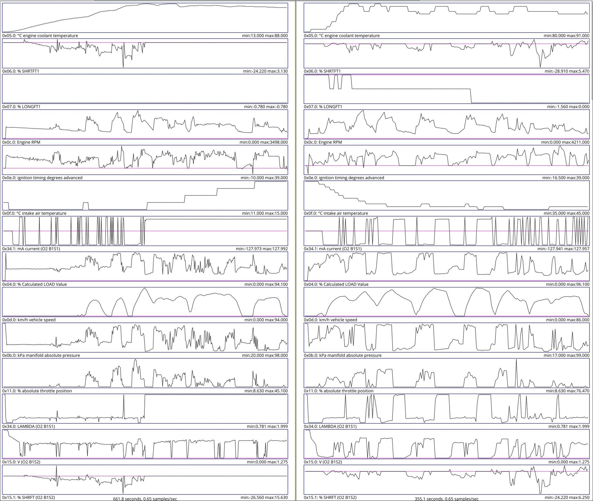

I have been struggling to get my 2005 Civic to pass smog for just over 1.5 months now and of all the things I tried and O2 sensors I bought + returned this posting was the one that had the magic and saved me. The essence of the problem was the heating element of my upstream AFS (Air/Fuel Sensor) burned out and this caused the initial check engine light problem (P0135). So many E-Bay sellers and even Amazon sellers will tell you they have the correct part and at prices from $13 to $40 (of the ones I tried) but they are either wrong or lying. The fact is the Air/Fuel sensor is a different beast from the heated O2 sensor, it is more complicated and more expensive. I ended up solving my problem with the 235-9005 part from Autozone for $192.99 (January 2025 timeframe). I'm sure I could have gotten a working part for maybe $110 less online but I was exhausted with failures so I decided to reward Autozone's brick + mortar presence and keep the part.
BTW the part number inscribed on the AFS from Autozone (their part # is 234-9005) is:
DENSO [NEW REPLACEMENT PART BOUGHT JAN 2025]
Assembled
in USA
192400-8040
11008
Maybe that will help in someone wanting to buy a cheaper equivalent part.
My original failed AFS (open circuit heating element) is this:
DU2 [ORIGINAL 2005 PART]
DENSO
192400-1160
O6G22
Along the way to diagnose the problem I went through 2 different OBDII testers from Harbor Freight, they're up to some scam of their own. An ELM327 bluetooth sensor you can pair with your smart phone can be had for $5 or cheaper, free shipping, and with a little patience you can do anything that any of these expensive scanners can do. Harbor Freight's scam seems to consist of selling you the $30 option, you find out you need more features so you return that (paying the 20% restocking fee) and get the $60 option, which has more features but still not good enough, so you keep upgrading, paying 20% restock fee each time until finally maybe for $600 you have the scanner that can do everything you need. Meanwhile you can buy something on E-Bay for $30 that is a much better value. Shame on you, Harbor Freight! The added features don't cost them any extra, it's just more functionality built into the software + the hardware is the same.
I only tried the $30 and $60 scanners from Harbor Freight but they gave me enough insight as to what I wanted to be able to do through the OBDII port. I returned them and ate the $18 restocking fees and considered it a good expense for tool rental. I'm an engineer and so I made a gadget using a 3.3V serial port USB adapter, 2 BC547 transistors, a diode, and 5 10K resistors. I use the FTDI based usb adapter using libftdi on linux (as opposed to /dev/ttyUSB0) and use the RTS line to send the 5 baud 8N1 0x33 byte to get the car's OBDII link to activate (ISO9141-2 protocol) and I was in business. I wrote code in 'c' and node.js to drive the serial port using libftdi and maintain the link, and I queried the 12 live data values available (two of them return 2 values) so I can plot 14 different readings in real time with a sample on each taken every 1.92 seconds. See the attached image.
What I learned is how to determine when an ordinary heated O2 sensor (HO2S) is installed in place of an air/fuel sensor (AFS). There are two driving sessions shown in the image, the left one is with an H02S installed (incorrect part) going from a cold engine start to when a P1172 error fault is thrown. The right one shows an already warm engine driving session with the correct AFS installed. Both are for the upstream side (before the catalytic converter). The key thing to observe is the O2 B1S1 mA current reading (label has 0x34.1) and the O2 B1S1 LAMBDA reading (label has 0x34.0). An HO2S just used the heating coil to warm up the sensor, the polarity of the voltage applied makes no difference. For an AFS the polarity is everything, the ECU uses the applied current to regulate the "sweet spot" of the AFS so as the air/fuel ratio changes the ECU can get a good reading... that's the limit of my expertise on it. The point is that the ECU when it puts a current on the heating element wires in one direction it expects the sensor to react. The left hand plot shows no change in the LAMBDA when the current goes positive. The right had plot shows the LAMBDA goes way high (close to 1.99) when the current goes positive. Based on the lack of expected response it's obvious the ECU can make the judgement call that something is off and throw the P1172 fault. Moreover I think it can know that some idiot (myself) has tried to put an ordinary HO2S in place of the AFS and it might even be able to stumble along doing something useful with the information to improve the air/fuel ratio, but it is doing its job by throwing the error.
Long story short I was happy for the excuse to gain some experience and expertise with the OBDII port and the ISO9141-2 protocol. The sheer weight of obstacles thrown in the path of finding a cheap solution is remarkable. Sellers happily claiming their part is the one the car requires, google search NOT delivering results relevant to the underlying problem, and finally the OBDII tools available off the shelf not really designed to help in diagnosis. I can tell you from experience a laptop showing live plots of all the live data available from the OBDII port would be amazingly useful in diagnosing smog related problems. Someone could gain experience by observing the behavior of vehicles with everything working, then compare against a vehicle where something is broken.
Having gone to all this effort I'm a little irked that now I have to start over wiith the new problem of getting my 1994 Acura Integra to pass smog. It has been parked for a few years but the engine was fine when I parked it. Finally I'm getting it drivable again and I assumed it would pass smog with flying colors, but instead it was vomiting out so much CO (2.55% at 15mph and 2.76% at 25 mph) that it qualifies as a gross polluter. I changed the single HO2S and ran some injector cleaner through the engine and for the retest a month later those numbers dropped to 1.23% at 15mph and 1.22% at 25mph (less than half). So it's no longer a gross polluter but it still is too high on CO% (max is .54% at 15 mph and .53% at 25mph, I'm in California). I replaced the MAP sensor but I tested the original and new one myself and their output voltages as a function of vacuum are identical to the limit of my testing ability. So I'm unsure how to proceed other than more driving of the vehicle in the hopes that it will gradually improve enough to pass smog. I'd love to be able to measure the CO% myself somehow, since it's $75 for each attempt to pass the smog test...
