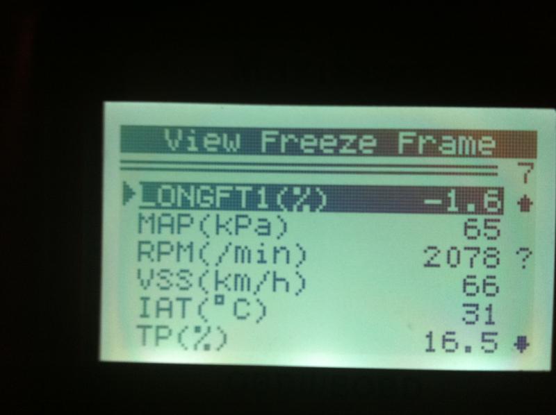

Re: Car is throwing off P1163 again
Ok so following are the pictures from the OBII reader. So can you guys let me know if my ECM/ECU is good or if this ECM needs an update?
Also, do you think the dealership will be of any help?

Old Jun 23, 2013
https://www.civicforums.com/forums/2...ml#post4633935
All the info needed is in that post. Even better if you can get an actual copy of the bulletin, but it's all there.
It looks to me like you are a candidate for the computer replacement. If you can follow the directions in the bulletin to obtain the correct replacement computer, you should only need a dealer to get it for you......IF it is even available. I can't tell you if they are still available or not.
