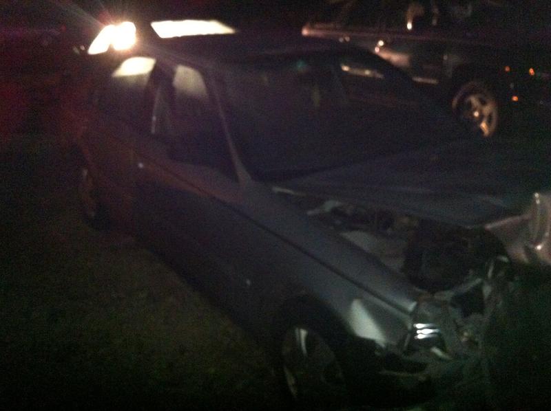

Sorry it's so dark

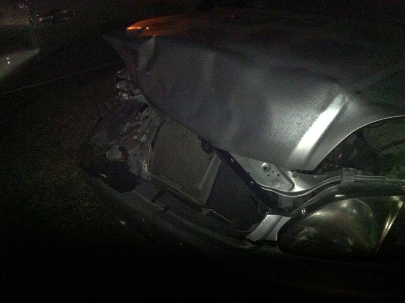

It missed the bumper mostly

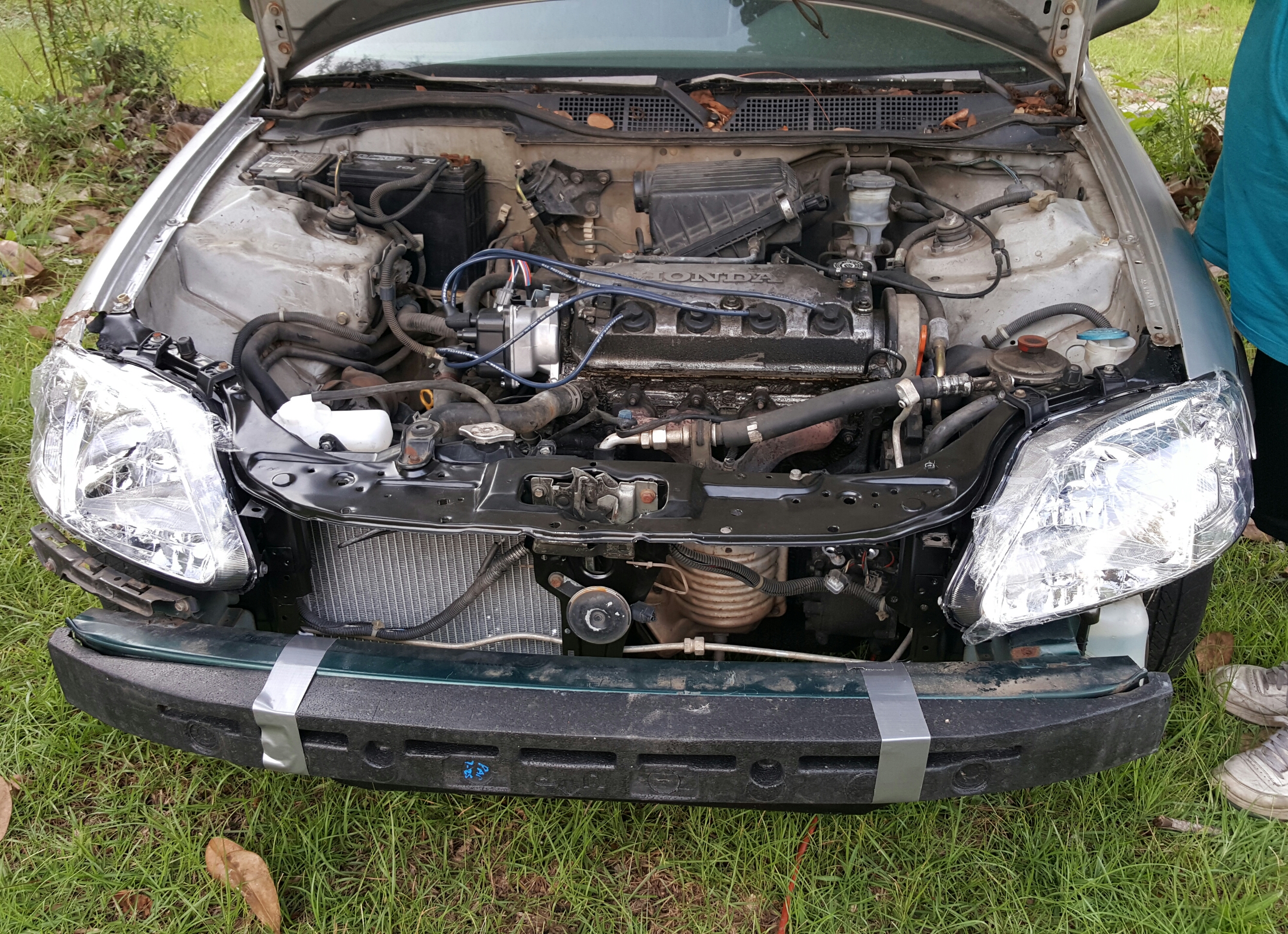

Here's Here's my handy work.
Note the duck tape is temporary

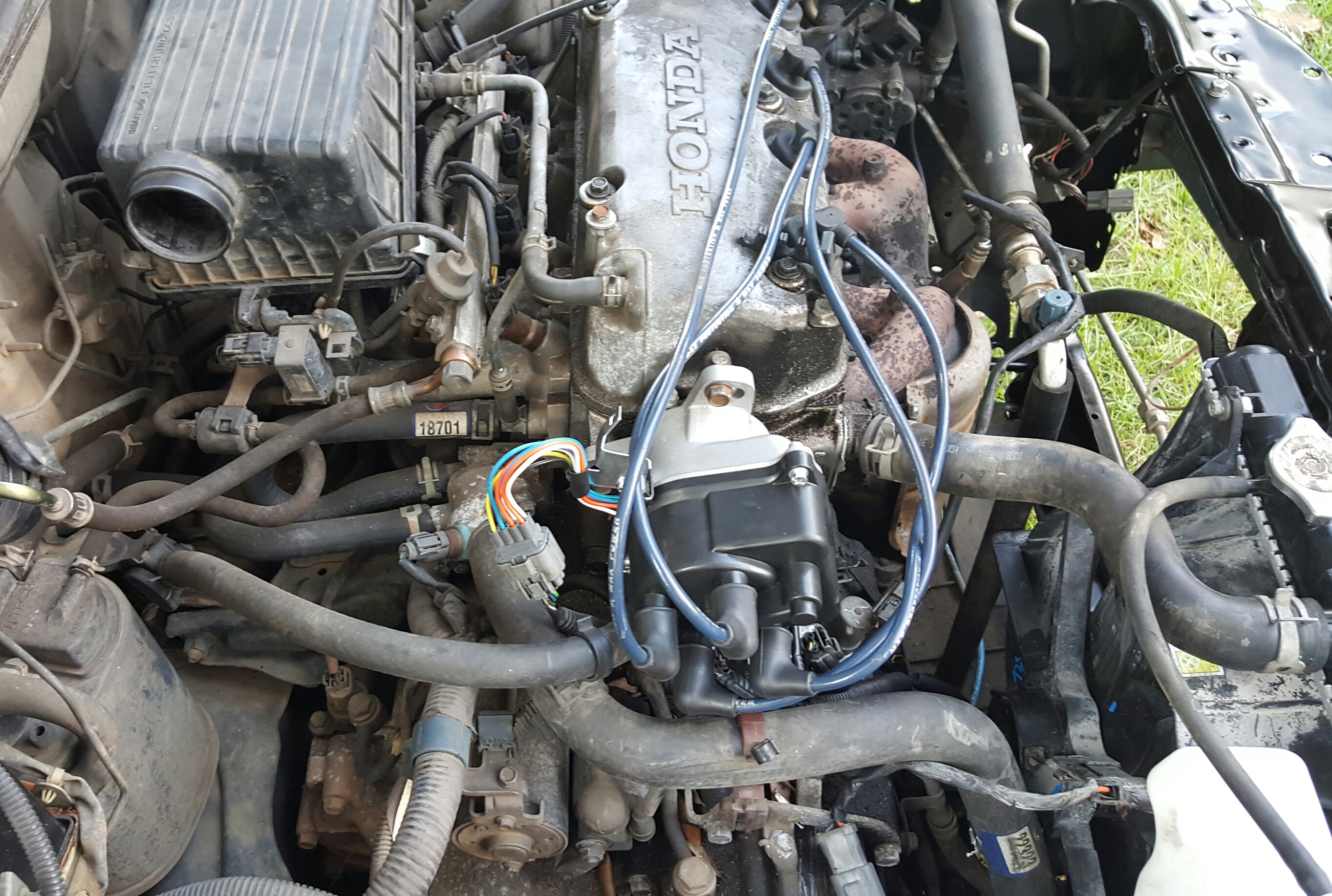

Please tell me the wires are on right...
I'll feel like an idiot if that's my problem
It would make my day if it was NY pr
Old Jul 27, 2015
Re: Wrecked it now fixing need rattle can advice
You would probably have low rpm and bad miss if the plug wires were out of sequence
Vacuum leaks? Low coolant?
Dist timed slow? Did you time it at all?
I see it's turned to the end of the slot instead of near the middle... Wrong dist for the engine? Cam timing off by a tooth and can't adjust ignition timing to the right mark?
