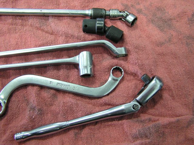

I like to look at the tools of a tech who claims to have a certain amount of exp. That says volumes about what kind of tech they are.
Someone asked how to remove a VTEC solenoid. I said I have an arsenal of strange, small 10mm tools to choose from....

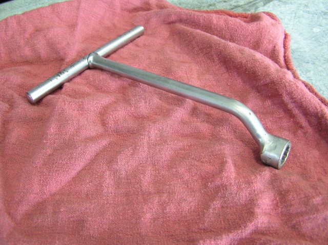

Were you around to see this one?
12mm, for removing one of the nuts on a carb on a 12A Rotor Motor. Real handy for Hondas EGR valves now, among other things.
You've seen my main socket drawer, it looks like a wreck but I know where everything is. It's kinda been like that ever since I tried to set a DeVille on that drawer LOL. It was an accident, I swear.
Toolboxes don't make money either. I didn't spend 15k on a nice shiny big name railroad car sized toolbox.
I've got a stack of Craftsman Industrials from 1997 and a stack of Craftsman standards from...early/mid 80s I think. Couple of tool carts. If I have to, I can haul all of my stuff in my lowrider in several trips.... I don't have to call a rollback in to move them.
I DO want to get a double wide bottom box to use as a portable, I scan CL from time to time.
The older stack of boxes holds the less used stuff, and toys. A laptop stays in one drawer, CDs/DVDs/cassettes in another, my fabulous collection of stolen office supplies is in a couple other drawers, 10 LBS of pocket change in a drawer for poker games, a drawer with a half-brick of firecrackers and bottle rockets, there's time sheets, digital camera, diagnostic test parts and sensors, enough special tools to rebuild the trans and rear end in my lowrider.....stuff like that.
