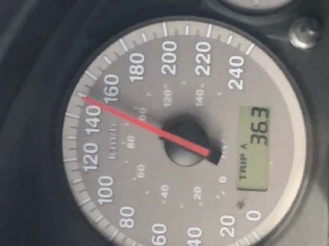

​I can still get about 95mph out of it
155km/hr

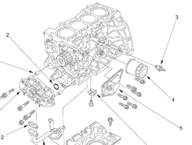

Did you forget to plug the oil pressure sensor back in? It's number 3 in the diagram below, rear of the engine. If I'm remembering correctly it has some sort of jumper that plugs into the engine harness somewhere on the passenger side rear of the head.

So the vtech solenoid and the oil pressure sensor have same plug
one is green other is orange and white
i had them switched lol
problem solved!!
