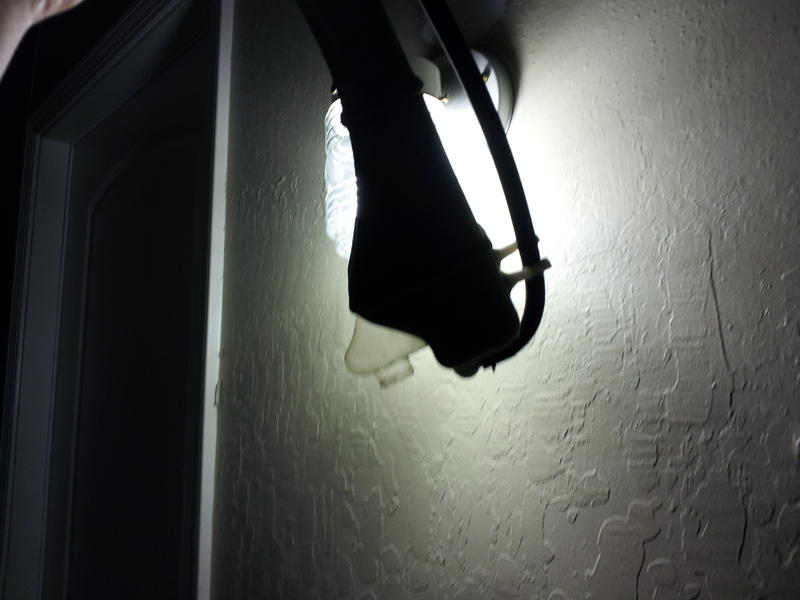

Black "tar" in coolant reservoir tank
I don't think this has been asked explicitly, so I wanted to start a new thread. Apologies if it has been asked, but my search-fu is weak.
There is a black tarry substance in my coolant reservoir. And I don't know what it is. Anyone ever come across this as well?
I had an epic thread with ezone (imagine that, I think all of this threads are epic if the op can keep up with him) and we touched on it lightly. We passed over it as this was not likely part of my main issue (see here) I just think it is a-typical. I have no basis for this, it just doesn't *feel* right.
It is not oil. I do not have milkshake-y coolant or oil. Cleaning the tank was a lesson in futility, so I replaced the coolant reservoir and the tar substance came back quickly.
So what say you. Eroded hoses? (Not sure when or if the hoses have been replaced) Oil in the coolant? Combustion gasses in coolant? At work now, can post pictures later.

not sure either but i recently cleaned out mine too and found all sorts of blackish stuff and some was stuck to the plastic inside and wouldnt come out. i think the issue is this coolant is not really circulated so it has a chance to grow stuff, have oily film buildup, and other things. should be changing the tank coolant every couple yrs when you do the regular coolant flush. im thinking some nasty buildup in there is normal. i think most comes from the rubber coolant hoses. when i had the res off, i decided to change the lil breather hose from the res to radiator and when i stuck my finger in, black stuff started coming off.

I don't like the post you picked out of that thread LOL. I prefer this one.
https://www.civicforums.com/forums/3...ml#post4581739
Quote
"In short: If there was not a thick layer of oil sitting on top of the coolant in the reservoir, then the residue stuck to the sides of the bottle is pretty average.
It happens with age and miles.
Yes, it coats the bottle and makes it hard to see through.
I have ideas of what it really is, but never have heard a solid explanation of it.
But it happens to many/most of the cars in time.
Oil would float on top of the coolant. It should have been obvious if it was there. If it was there long enough, it would be thick like gear lube, and probably dark brown or black.
Good luck cleaning that crap out, let me know if you find something that works. (I think the residue may be the sealant that was put in at the factory.)
No updates that I know of since that thread.
Not sure I buy into the hose theory either.
Especially since hoses can last the life of the car now, they have improved tremendously over the years.
Still no definite answer though.

Sorry guys, been super busy.
That's the stuff. It literally coats the inside of the tank.(pics of old tank here and here) Definitely not oil or floating. Makes me think it liquefies, or is at least becomes mobile, when hot then get tacky and sticks once it cools down. Which is good I suppose if it is accumulating in the overflow tank. Easy to change and a cheap part, I suppose. I have not seen any degradation in the hoses. They *seem* nice and thick with little to no inside wear. (Coming from an untrained eye.)
lol. Selective memory! Plus that is a marathon thread and who wants to re-read all of that
Yep, your quoted post here is spot on, still. Cleaning it was impossible, so I just replaced the tank.
Even if the hoses degrade or erode just slightly, could that still be the culprit? Or perhaps it is one or more specific hoses. For example, the small throttle body coolant lines may be susceptible to erosion. This is just speculation of course.

Re: Black "tar" in coolant reservoir tank
Originally Posted by 04 Honda Civic
Im curious now, can you take a picture of the gunk?
Still at work. Will try to grab one tonight or tomorrow.
Did you see these?
