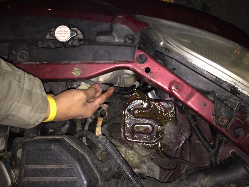

the black hose that goes out of the coolant fill valve (the small 1/2" diameter outlet facing the engine), doesn't stay intact... It burst opens after every drive... At last I kinda locked it with a copper wire. I'm about 200 miles away from home... Is this ok to, lock down the hose that way and drive?
Why is it happening all of a sudden? When I locked down one end, the other started to do the same... Any reason why this started happening now? Should I change the hoses?
The attachment might help... Thanks

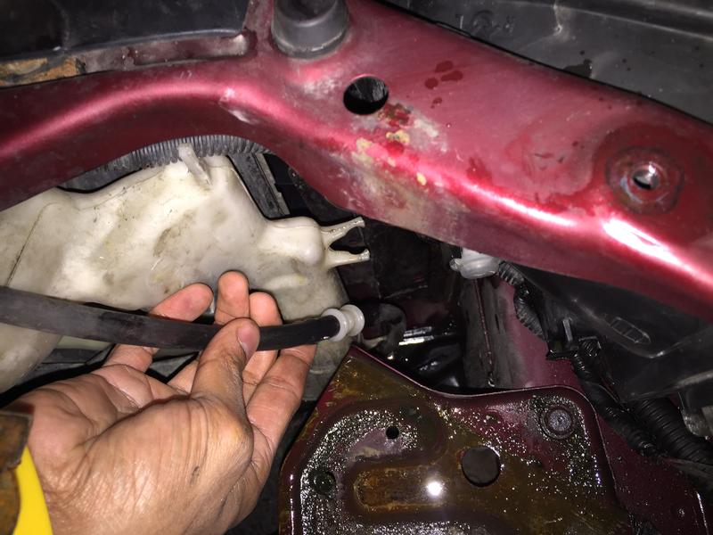

Couple more pics...

The hose must be open and free to flow liquid between the radiator and reservoir.
The cap of the plastic reservoir must NOT be sealed, there is supposed to be a hole in the side of it. If that got sealed up with an incorrect cap, it may pop the hose loose as pressure builds up.
You may clamp the hose ends if necessary,
and you need to be aware that the engine may have a blown head gasket.

It shouldn't, but if a head gasket leak were rapid enough I suppose it's possible it could pop hoses off.
It's certainly not normal to pop that hose you have your hands on, so what other possible cause have you come up with?
If it hasn't already had one, the car is a candidate for a blown head gasket just because of what it is.
I can't help but think there may be another reason the hose is popping off. It's quite unusual even with a blown head gasket. Are the rubber hoses swollen and mushy? Clogged?
