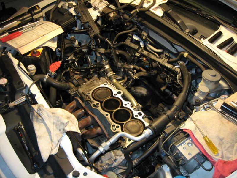

Well it is done.
I replaced the gasket/head, timing belt/idler and water pump for a total purchase price of just under $800 plus about 32 hours of work. It would probably take me a little less time if I had to do it again but I hope I never have to find out.
It is running great and I am not losing any water. Woo Hoo!!
In the attached photo you can see where the #4 cylinder sleeve overall has a lot of corrosion on the top and a lot toward the intake side. I think that is where the exhaust was forcing its way into the water passage.
