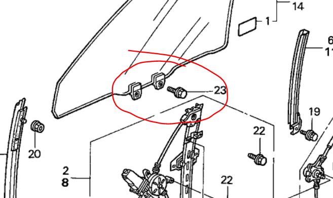

Passenger window not working and came off regulator
Motor works but no response from the switch.
The window simply fits into two 3/4" slots on the regulator - no bolts are attaching it. Does it need an adhesive to keep it in there?

Check the driving door harness for broken wires. Specifically right where it bends every time the door is opened. A wire can break there and prevent the passenger window from working. Unless you have verified the switch itself is bad.
There should be two bolts in the center at the very bottom of the window.

Thanks, I will check the wiring where it bends. There are no bolts crimping down on those slots for the bottom of the window. It's just a slip fit - adhesive must have dried out.

There should be bolts, might be rolling around in the door
