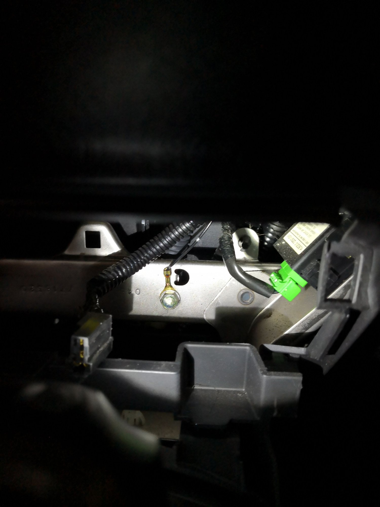

Thanks. Checked the fuse on that too. Fuse is good. Just removed shifting boot and cigarette lighter assembly.

Duh on me. Aux power works - tested at 12v. My testing units, a phone charger wasn't long enough to reach the power, and my powered flashlight's bulb was burnt out. Arrgghh.
So tomorrow, pulling the stereo. As earlier posts suggested, I'm betting stereo is bad.
Thanks everyone for the suggestions. Appreciated.
I'll report back with radio/CD player unit update.
