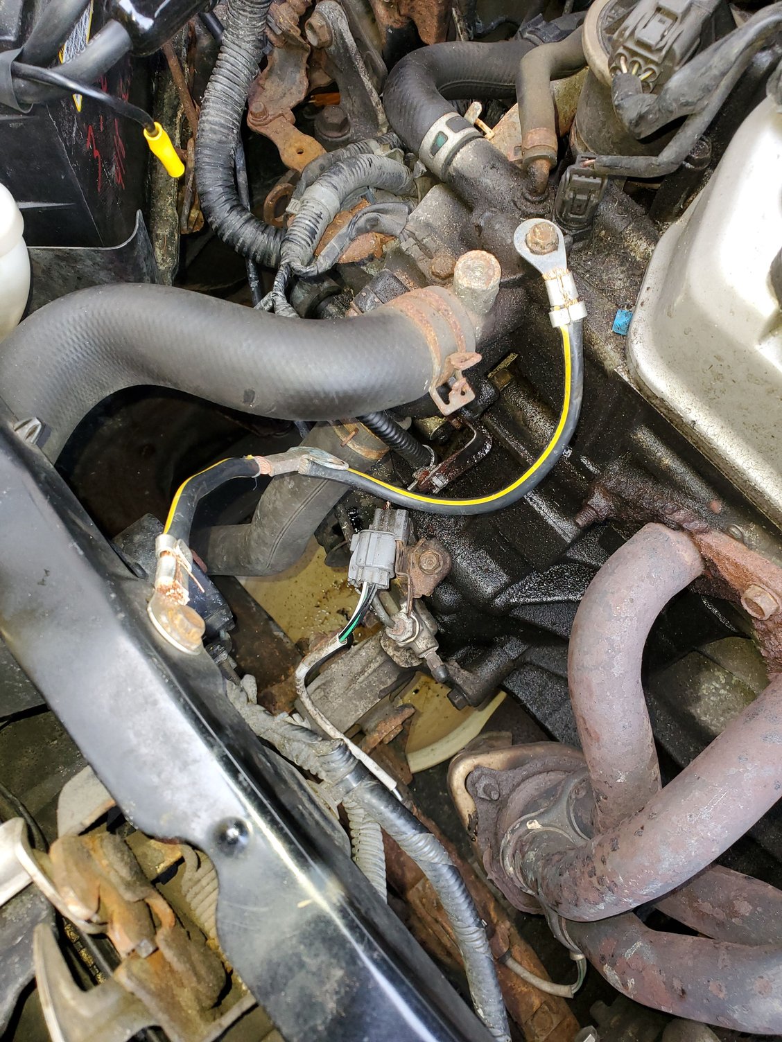

Check the ground connection on the thermostat housing. If the car starts only with the OBD reader connected it is supplying the missing ground.

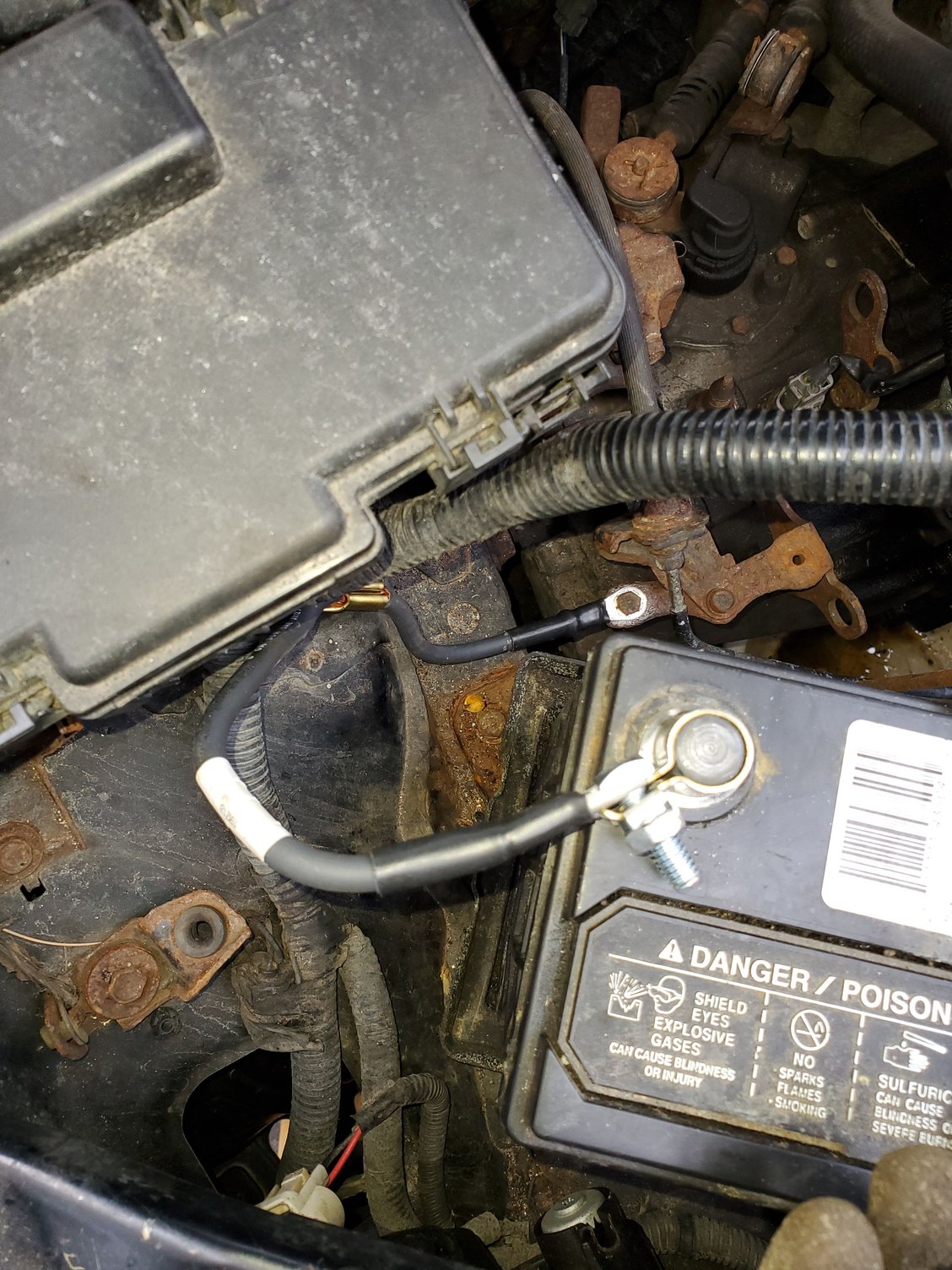

it was the ground I installed off the battery is not supplying a good ground even though I cleaned the surface up. My ground strap from radiator support to thermostat housing was broken since I owned the car so I replaced it and it's all good. Thanks for the help people.

Re: No crank, nothing at all
I hope you cleaned some of the rust off before tightening those down, won't make a good ground if you didn't.
Old Feb 5, 2020
Rep Power: 512
That was my first thought with those pics. Do yourself a favor and take some sandpaper to some of those ground connections, especially that transmission connection. A dremel with a flap wheel would be very helpful, too
Yea I plan on it..... next chance I get I'm going to sand blast and paint the trans one , leave clean spot for ground. I just ordered all new motor mounts
Old Feb 5, 2020
Rep Power: 512
Just make sure you have a bare metal connection for that ground.
