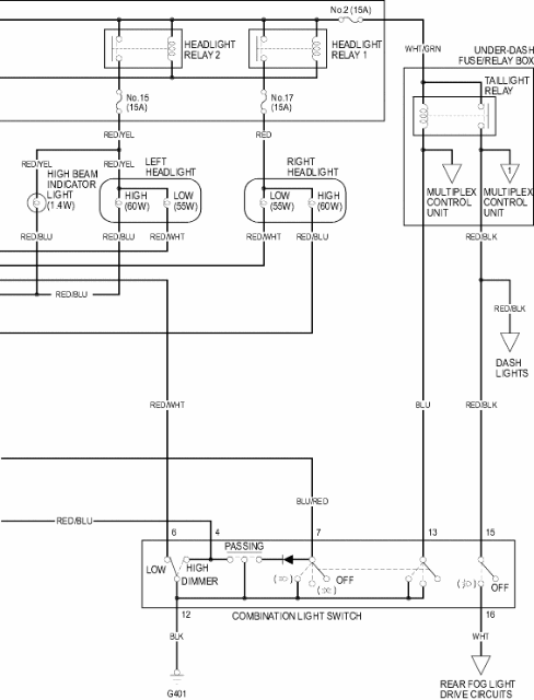

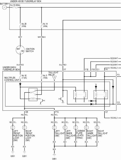

Do your high beams work?
Some scat's for you to mull over. The last two go together.

Old Dec 2, 2012
Re: 2001 Civic LX with no Low Beam Headlights
A cheap test light and a wire diagram can be your best friend, if you know how to use them.
Although the Multiplex unit is wired in with the headlight system, the Multiplex unit does not affect actual headlight operation. It could be dead to the world and the headlights should still operate normally.
(According to US wire diagrams... I did not look at Canadian versions though.)
Recheck the wire modification done for the headlight recall. I don't care who did the recall, a human did the repair. The crimps could be loose.
Inspect wiring to pin 6 (RED/WHT) in the harness to the switch you replaced.
Originally Posted by sdemeyer
Yes the high beams still work.
That eliminates a lot. If that's the case, do what CraigW said because it's about the only thing it could be at this point. It has to be common to both low beam portions of the headlight circuitry and that wire looks about the only thing it could be at this point since you replaced the combination switch already.
Thanks for the help. You schematics were better than the ones I had. I'll check this when I get back home in a few days.
