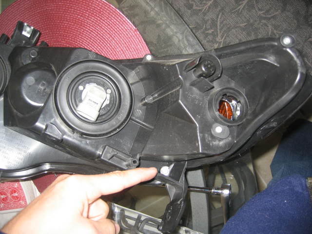

now use the star bit, not sure of the size, i have a set and just tried it until i found the right one., remove the four star bit screws on the back of the headlight. now remove the bulbs (headlight, hi beam, blinker,)

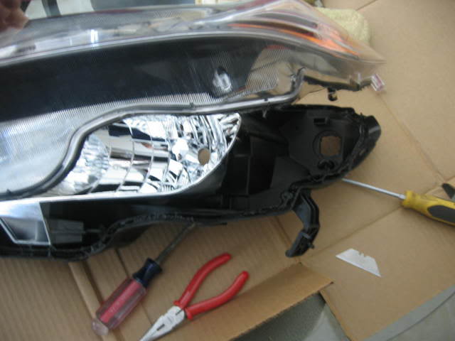

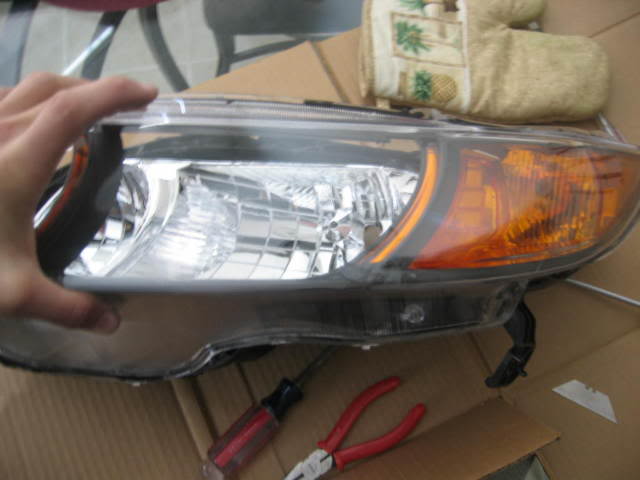

cook the headlight at 275 degrees for 6-10 minutes and make sure that you dont leave it to long. once you take it out of the oven, use the flathead screwdriver to start prying the headlight assembly away from the clear lens cover.

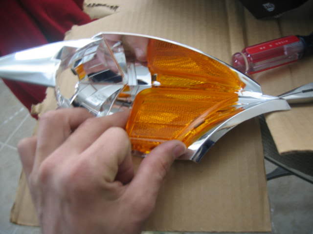

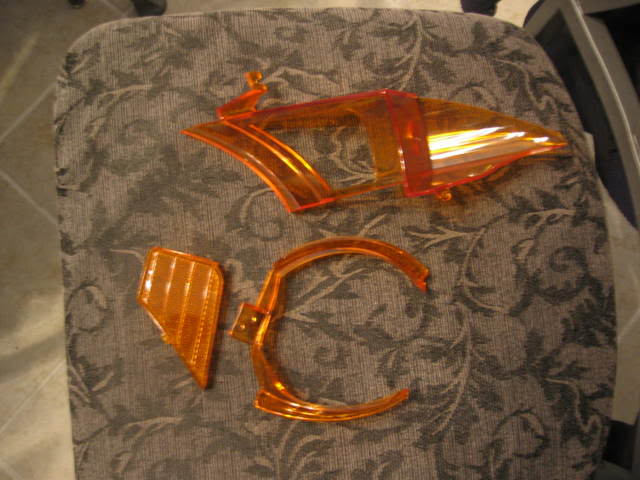

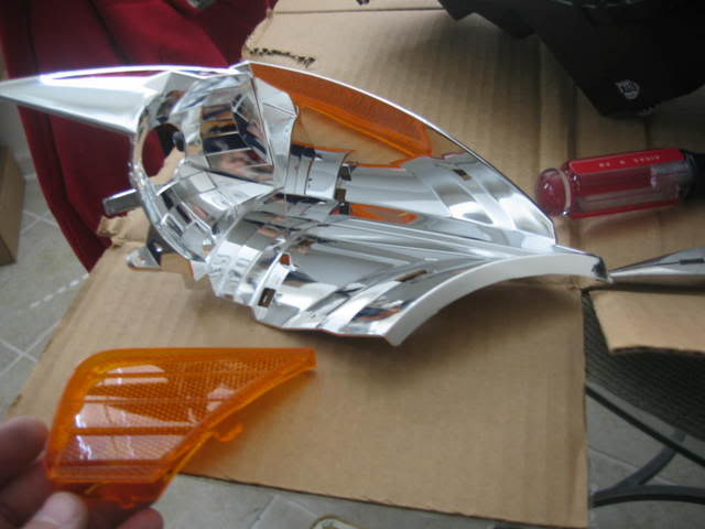

when you get to this point look at how the amber peices are held on the the chrome assembly. it is very easy to just pop those peices off

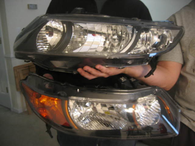

next remove the old sealant from both the lens and the back cover with the razor blade and clean the surface good for resealing. put the haeadlight assembly back together just how you took it apart, minus the amber peices, and then reseal it with a flexible clear sealant from any auto parts store.
then reinstall the headlight, and repeat for the other side.
