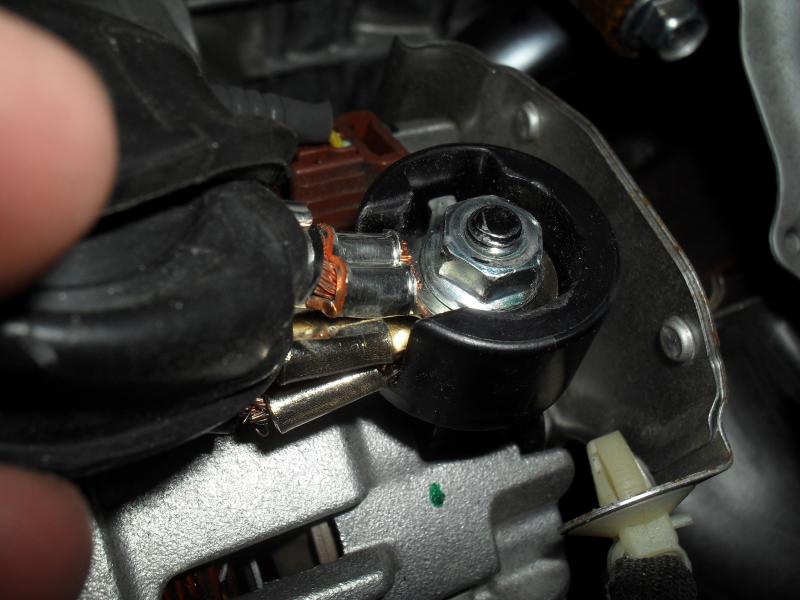

Anyways, for starters there are 3 wires to be upgraded.
I chose to leave the stock wire on, in addition to the new wires for added security, in case I did something wrong, the stock wires are there to keep the car running.

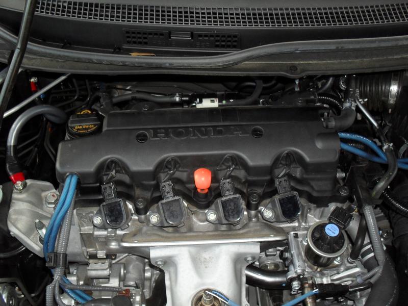

The first runs from the alternator to the battery, for the alternator to charge the battery(duh)
On the 2014 there is a bracket in the way, so any ring you use must have a diameter of 3/4in or smaller, and the neck of the ring, where it attaches to the wire must not be larger than 1/2 inch.
This is troublesome for 0 gauge wire, so for this part I ran two separate 4 gauge wires.

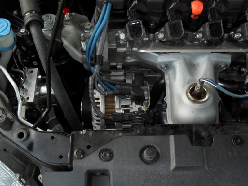

I was actually able to fit the two 4 gauge wires under the cover on the engine.

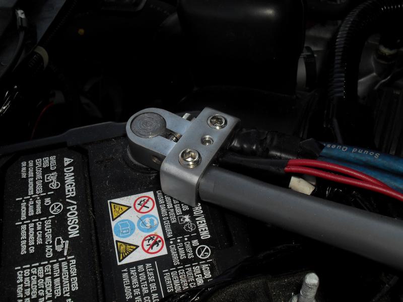

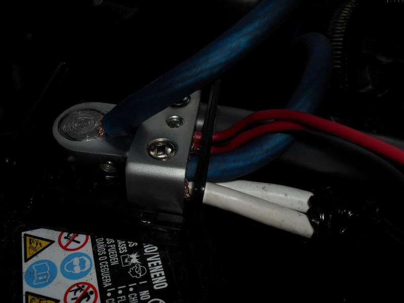

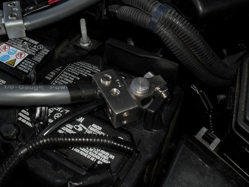

Run the wires to the battery and connect them to the positive.
Here you can see 7 different wires attached to my positive terminal.
The two white are the stock alternator wire, and the positive going to the rest of the car.
The two blue are the 4 gauge wire I added coming from the alternator.
The two red are connected to switched, which in the future will allow me to turn my amps on and off when wanted(Once i hook up RCA cables)
The giant grey cable runs the subwoofer amp.

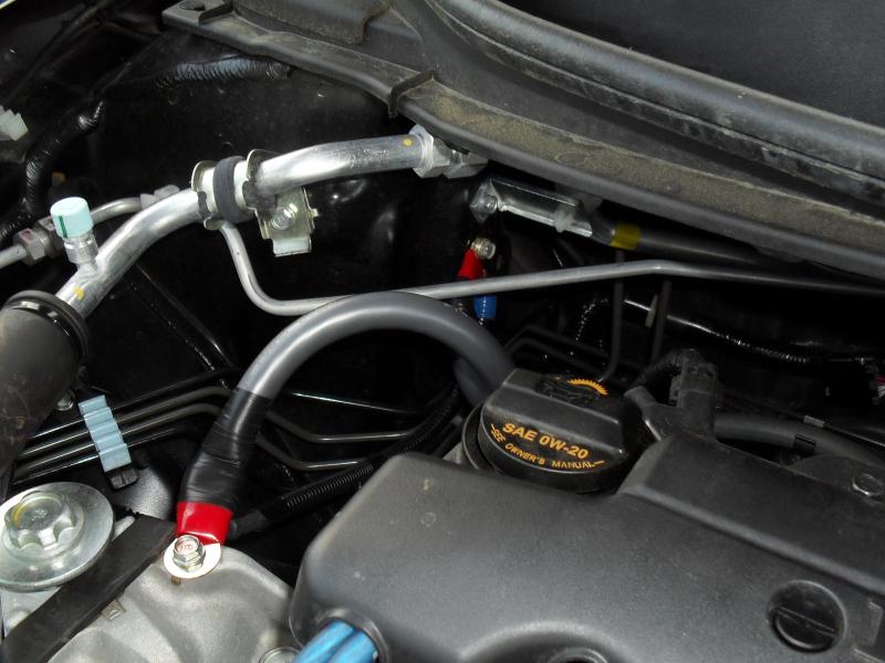

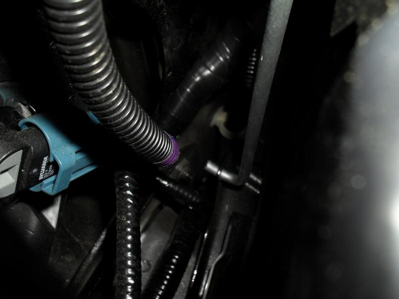

Next wire runs from the engine block to the chassis.
This one is a pain because the AC hose gets in the way,the bolts are tight so don't be surprised when the bolt finally turns and you slam your hand into something.

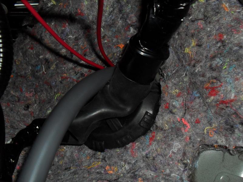

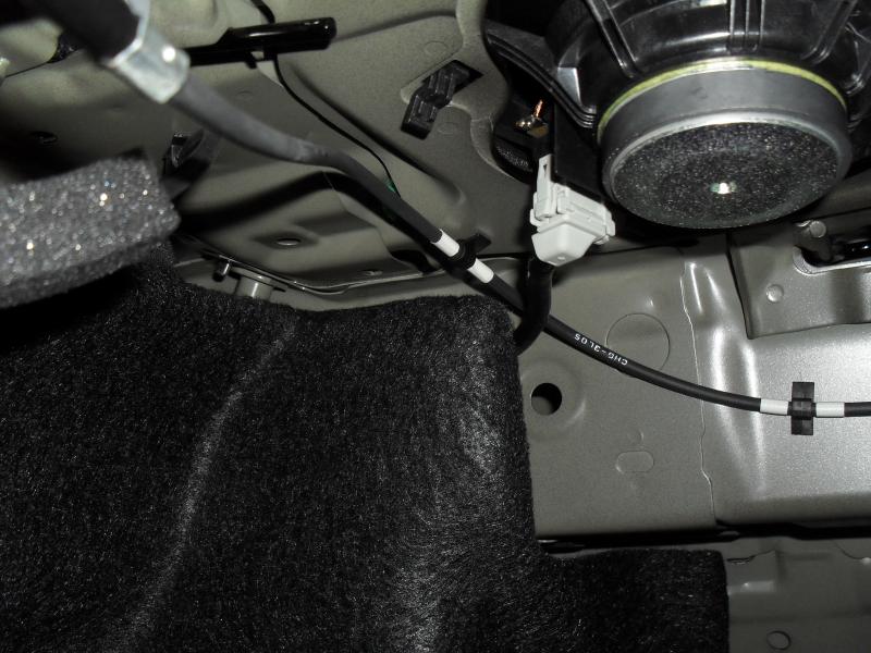

So here is the set-up inside the car.
Where the wires come through the firewall(Was a huge pain to get the 0 gauge around the rubber)

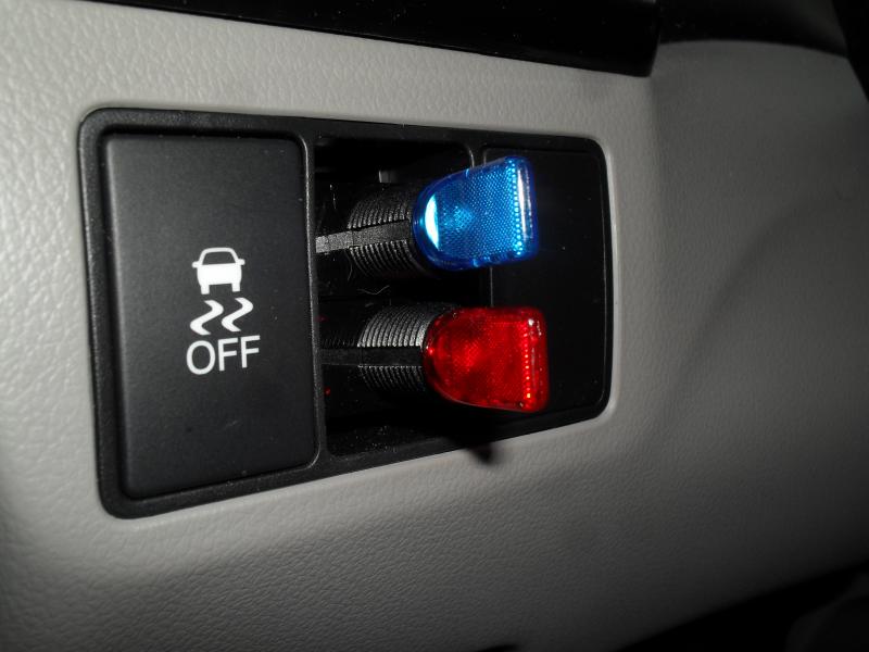

The two switches to tun amps on/off.
(eventually, currently server no purpose)

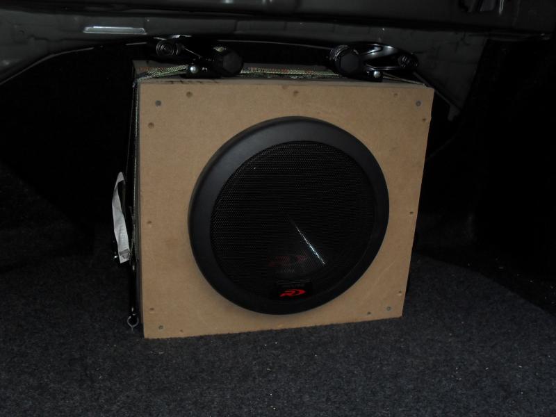

I went for a completely clean look(and built my box myself)
Amp is hidden where the spare tire would be.
The wooden block holds up the platform(just spare wood I had left over after building the box)

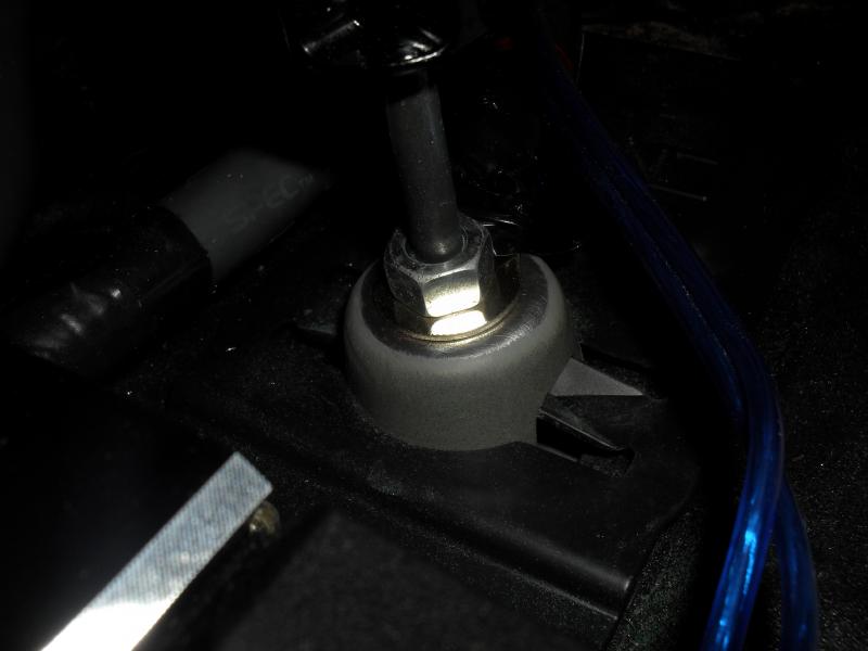

Ground wire fits perfectly using a bolt i had laying around, and the screw for the spare tire

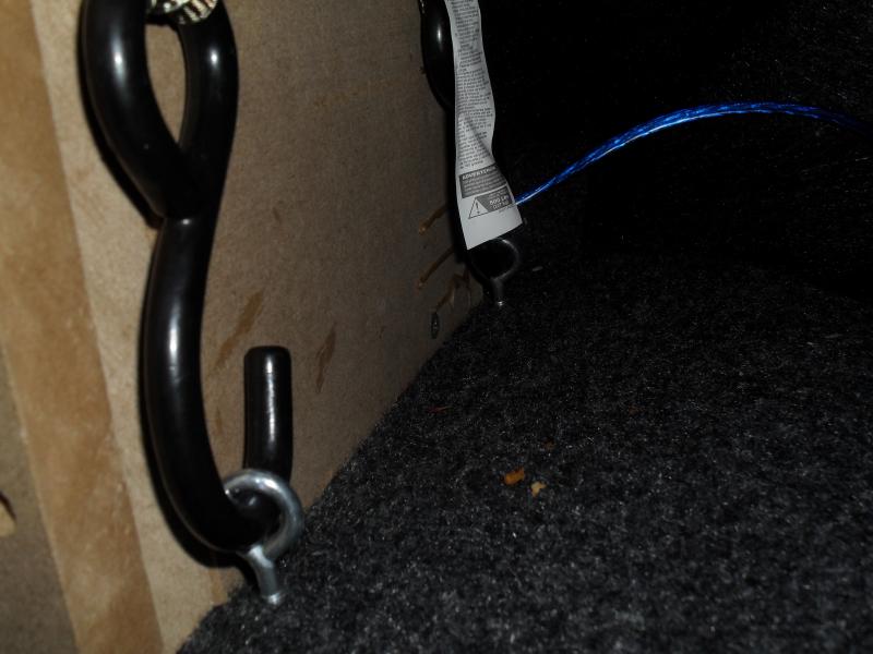

It's held down with cargo straps, so it doesn't go anywhere if I take a turn

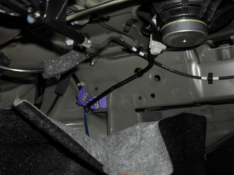

Wires are hidden

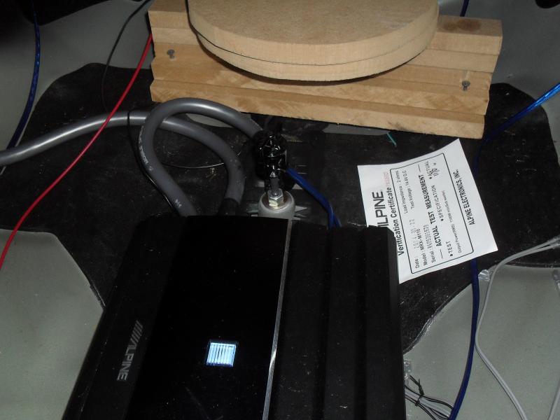

Test slip for amp:

Forever and a day late, but here are some updated pictures with a cleaner job, and the new negative terminal:

Where'd the battery current monitor go? Warning messages on now?
Old Jan 23, 2015
jordan1794's Avatar
Joined: Jun 2011
Posts: 539
Rep Power: 188
jordan1794 is just really nicejordan1794 is just really nicejordan1794 is just really nicejordan1794 is just really nicejordan1794 is just really nice
Re: Big 3 Upgrade 2014 Civic
Yeah, didn't want to go through the hassle of trying to pry the bolt up enough to get a ring around it and everything.
Says "Check charging system" every time I start the car.
I checked before hand to ensure the alternator would still behave adequately without it, and it does.
From what I read elsewhere the primary function is that it sees the amperage being pulled and gives the alternator a heads up so it can kick on before the voltage stops dropping.
But when I'm pulling all of what the alternator can make it hasn't made a difference for me.
(Tested it with a meter before and after; voltage behaves the same way with and without the sensor)
Of course, I did TRY to tinker with it, and ended up cracking it...got very upset when I saw that damn little thing is like 80$
But I guess it is a very specialized sensor, most likely built only for honda by one company.(I think it said bosch?)
