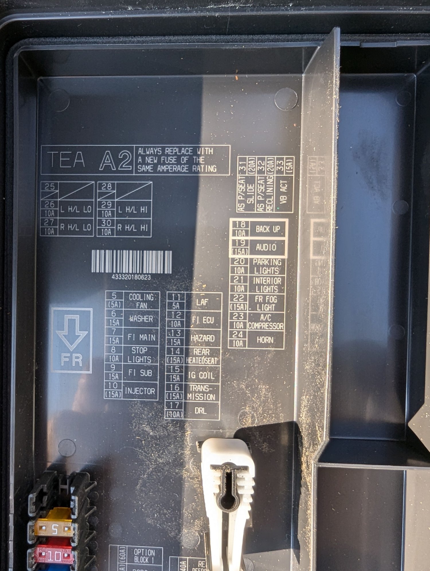

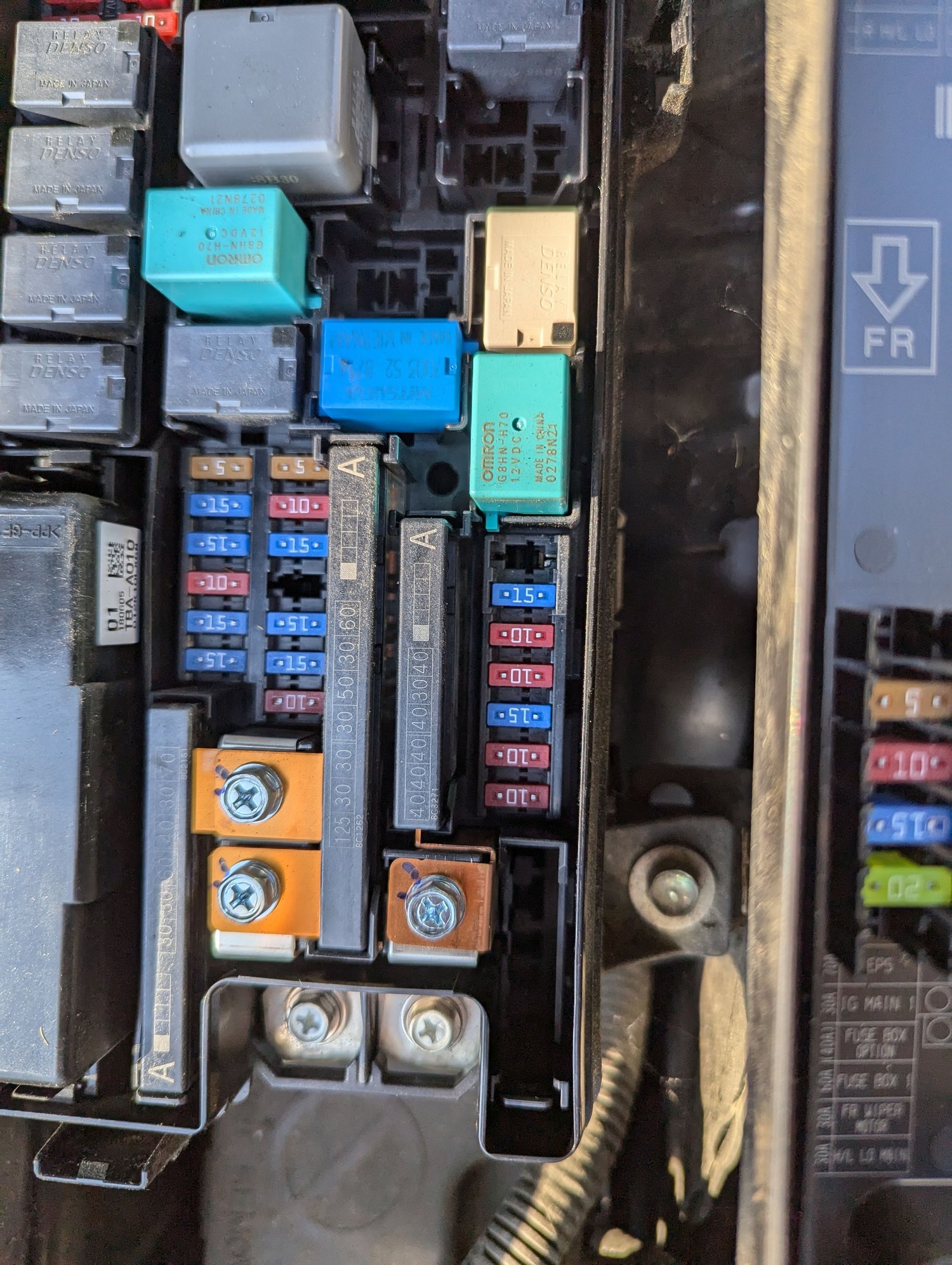

Re: Battery drains in 3 days while off
Update 2: what should I do next? I pulled a 10amp fuse that looks like it's a backup light or camera, probably the light, and my multimeter went dropped significantly, .7a to .054a... See top right hole, there was a 10a fuse there. And then corresponding diagram below.

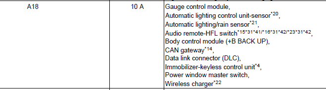

Here is everything on fuse A18.
