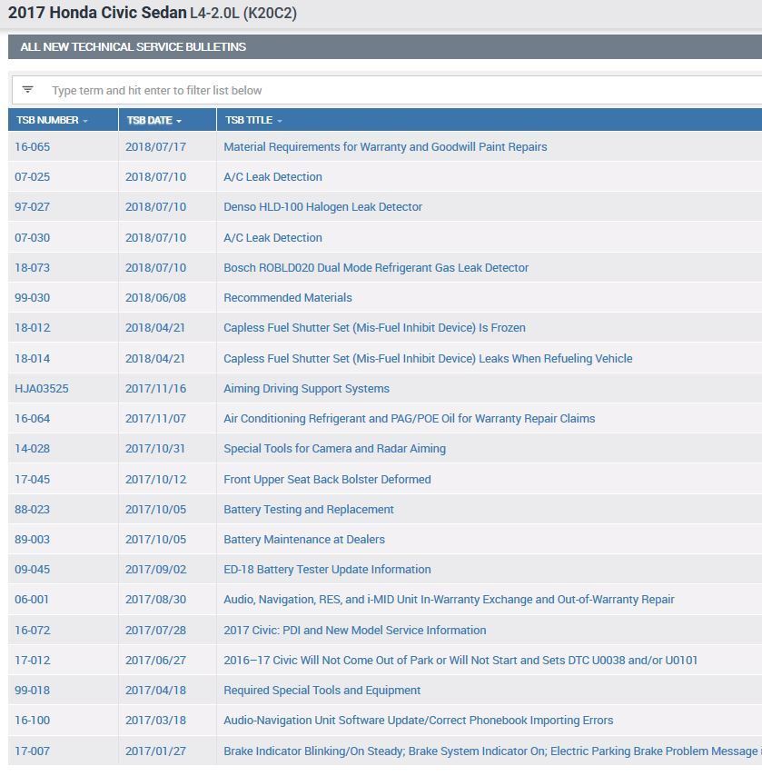

i don't see anything recent relating to brakes that applies to a 2017 civic. my system only shows ME what is relevant to the car i enter in. it would be a lot of wasted time searching to start flipping through different years and models looking a TSB which won't apply to you anyway. a TSB isn't a voucher for free work, so what's the point?

ok. well, i will second what the dealer said, the bulletin does not apply....or it would be on the list.
if you know exactly what kind of car it DOES apply to, i would be happy to post it for you.

As of this moment, there are no technical service bulletins issued by Honda regarding brakes on 2017 Civic.
EDIT: No bulletins issued for USA. Canada could have different info available.
