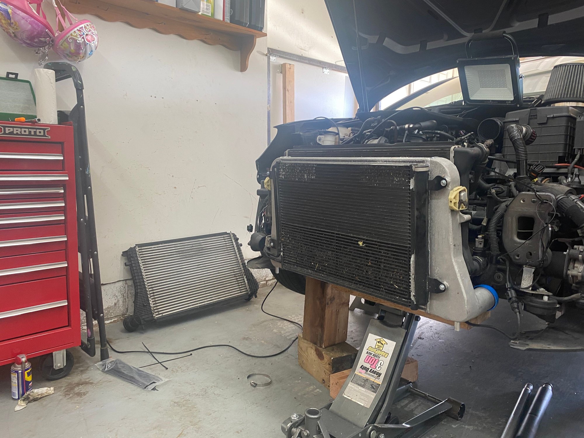

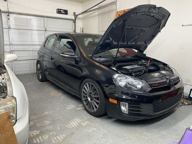

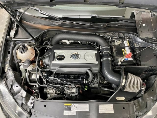

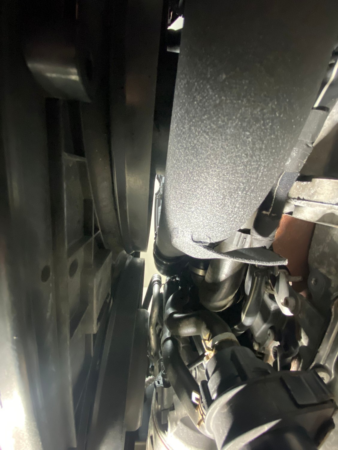

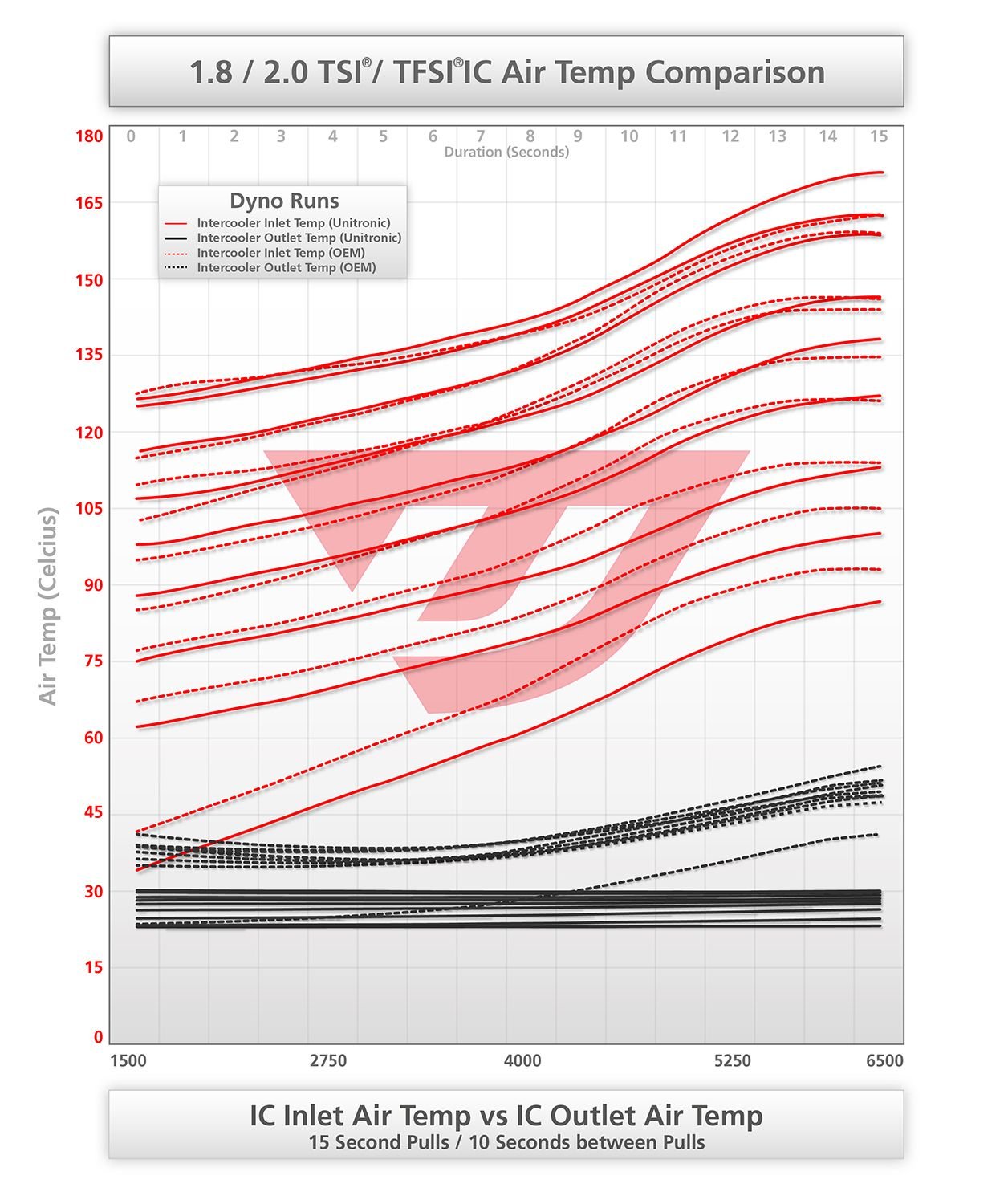

Finally got around to installing the Unitronic intercooler. Had to basically take off the front of the car. Everything fit up nicely and heat soak is greatly reduced. Also installed a larger throttle pipe (intercooler exit to throttle body). Have one more pipe to do and that’s the one after the turbo to the intercooler.
Also did an oil change. Redline 5W-40 and Mann OEM filter.
The throttle pipe comes very close to the fan. Had to cut the mounting bracket as it didn’t line up and pushed it closer to the fan. That’s what I get for buying a cheap part.
Unitronic’s testing. I wanted to keep it factory looking so I went with an OEM location one. The front mounts do look cool tho.

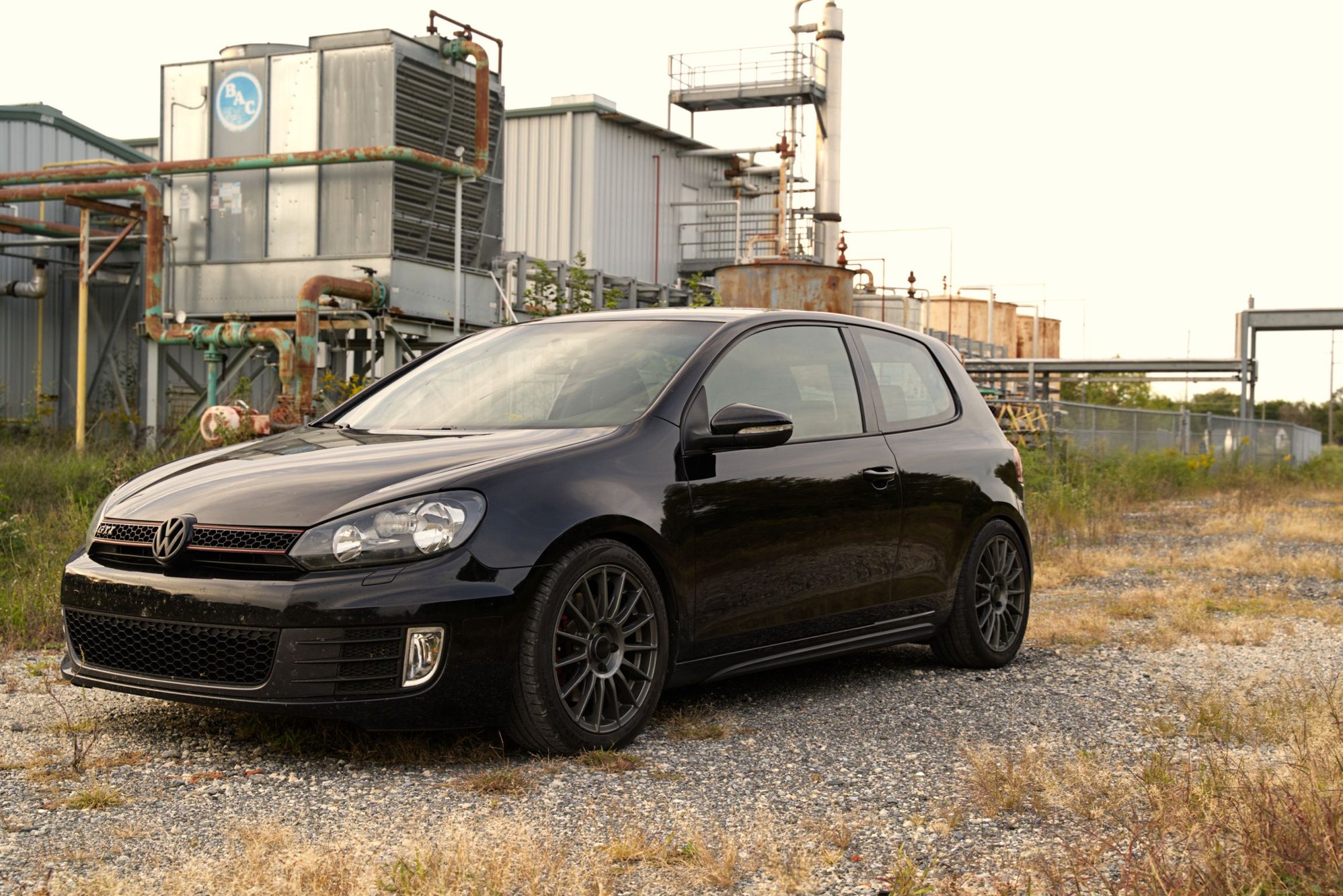

Went out to take some pictures the other day. Light wasn’t great but I got a few shots.

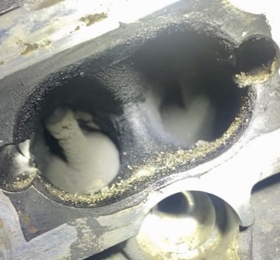

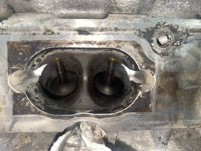

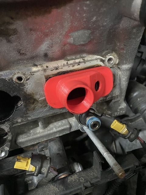

Well finally took care of my faulty intake manifold (common issue on the MK6). While it was off did a good carbon cleaning of the intake valves. They were very dirty. After that I had some issues getting ready status for emission's. After trying to complete the drive cycle I flashed it down to stage 1 and was able to get everything to pass. Good for another 2 years. Flashed her back to Stage 2+ and gave her a wipe down inside the engine bay and out.
3D printed adapter that helps seal everything while you blast it with walnuts.

That 3d adapter is pretty neat
