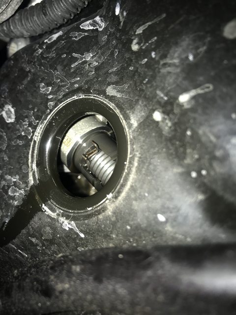

Changed the oil last night and it was just as easy to do as it is on a Honda. I did make a mess as the oil started coming out of the drain hole as soon as the T-45 bolt was loosened. With both the Fit and Pilot you have to damn near remove the plug before the oil came out. My Honda 14mm aluminum crush washer is not superior enough for the VW. Had to go the dealer to pick up the appropriate crush washer ($1) which is rounded and seems to have some sort of rubber inside it. While I was there I grabbed a normal 19mm hex drain bolt ($4) too.
I have a Blackstone oil analysis kit that I will be using at either 5k or 10k miles to see how the RedLine does. I also am going to send in some Honda Semi-Synthetic oil from the Pilot when the Pilot tells me it needs to be changed.

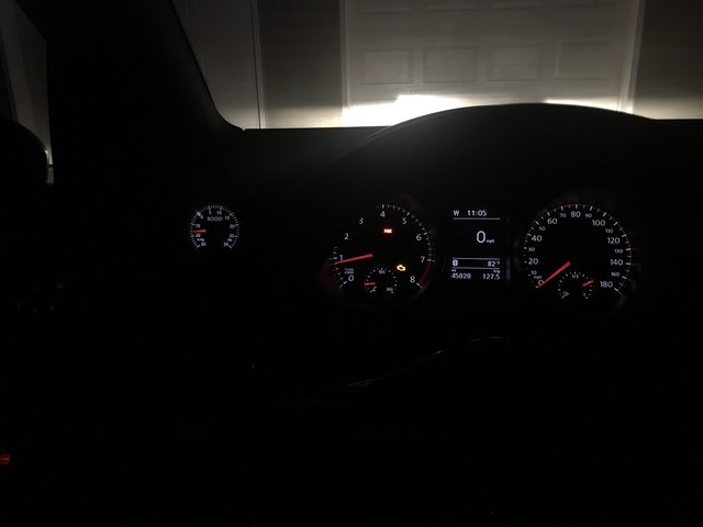

I added a boost gauge because racecar but don't like it. It is not one of the popular choices for mounts and gauge and I wanted to be different but I don't like it. Bought it used so don't have too much invested. When another used gauge comes up at a good price I will replace it.

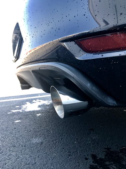

Got the resonator delete and the car sounds amazing IMO. On throttle lift off you can get some nice Chewbacca noises and can hear the turbo spool more on acceleration. Also got some new tips installed to give the OEM exhaust some bling.

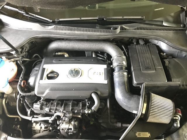

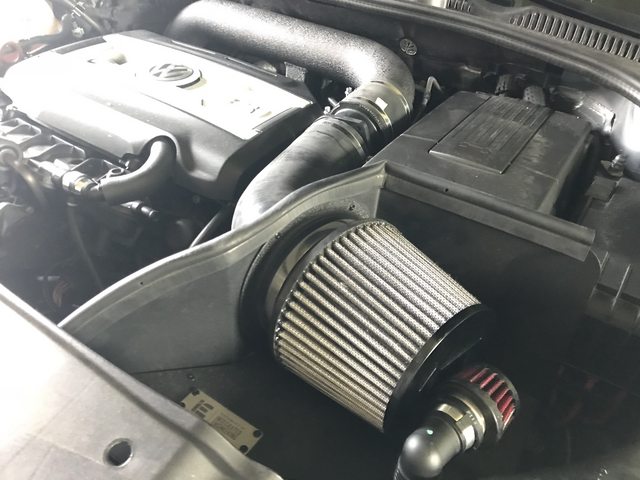

Integrated Engineering Intake installed. Very high quality part and makes the engine sound amazing. You can hear the turbo and diverter when you let off or shift. Even if it doesn't add much power for the stock turbo it is a great upgrade to enhance the overall driving experience. It felt like it might have shifted the power band up a bit. Don't get the cool Stututututu Subie noises but still nice to hear the turbo.
Scored the intake and secondary air filter used off of eBay for $225.
Instal took about 35-40min and everything fit very nicely.

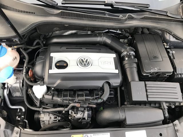

Got some little parts coming soon. A picture in the meantime. Washed and waxed with 303 Quick Wax/Detailer.
Need to get the DSLR out and get some nice high quality photos.
Cleaned the engine bay some too.

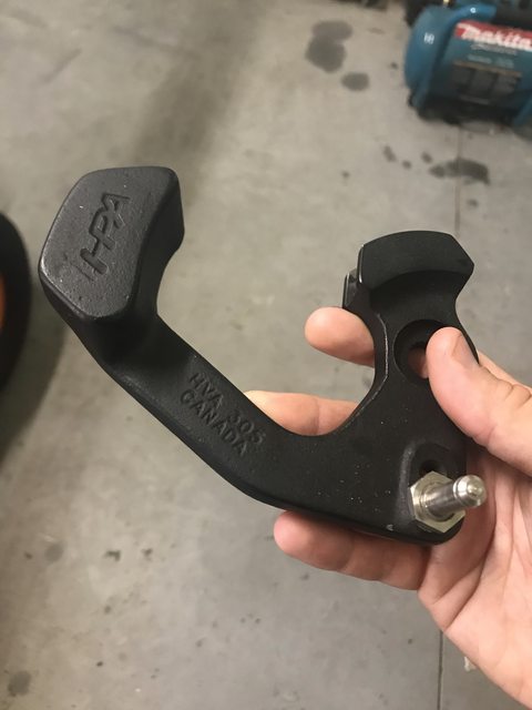

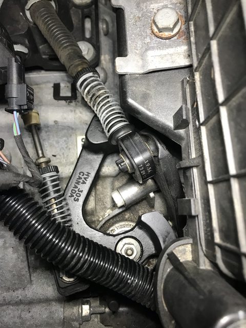

Installed HPA short shifter. Made a nice subtle difference. It advertises 20-30% in reduction and adds a little bit larger counter weight to increase shift effort.
While I was installing that I took a look at my secondary air pump valve and found a connector that was loose. Plugged it in, cleared the CEL and it has not come back since. Glad it was something simple.

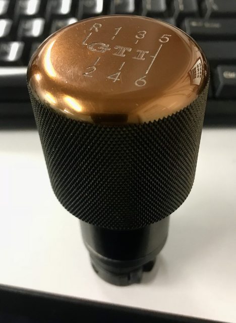

Installed a Euro Impulse shift **** and custom shift boot. Shift **** came off of eBay used. It was black but the sun has changed it to a bronze color which I kinda like. Boot came from StitchBoots which has a great selection of shift boot patterns. It is very well made and matches my seats perfectly.

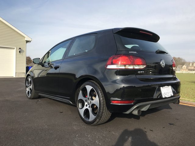

Had the kids in the car and they make such a huge mess!!! I don't know how they do it but dirt just gets everywhere.
Did an interior detail and took a night shot to add some drama.
Also I don't think I like my new shift ****. The OEM one was actually really comfortable and I didn't notice as much until I didn't have it. Will probably switch back even though this one does look nicer.

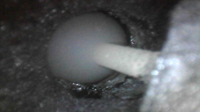

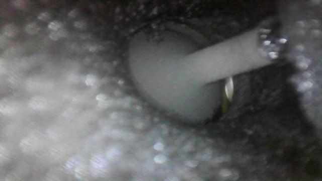

So I finally decided to take a peek at my valves to see what kind of carbon carnage I had with 48k miles. It actually didn't look too bad and I am relieved that it is not in need of cleaning ASAP. I removed the IAT sensor and inserted a borescope that works off a phone app. Worked well and I was able to check out the middle 2 cylinders.
I was thinking of doing a carbon cleaning next year and once that is done would like to install meth so that it keeps it clean (and for more power of course).

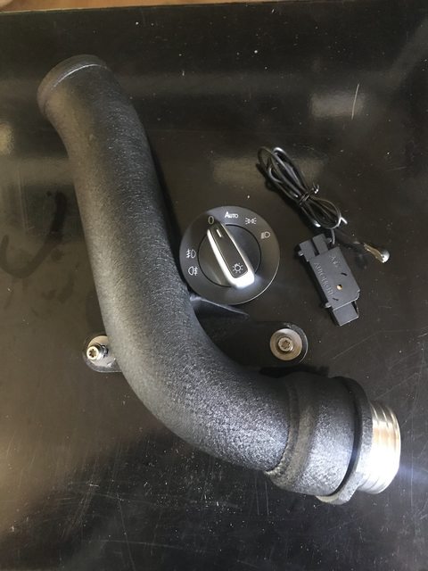

Picked up a turbo outlet pipe, euro switch and automatic light sensor used off the forum. Euro switch is not something I was originally interested in but it gives you more lighting flexibility. With the switch I will be able to run my parking lights and fog lights but not have my headlights on. For parking and fog I would like to add yellow bulbs to add some lighting style. The switch also allows for a rear fog light to be wired up so I might add that as well. Turbo outlet pipe is for increased flow and better turbo response. For retail price not worth it for minimal gains it offers with the stock turbo but as a used part yes!
Random Google image of an R with the City (parking) lights on.

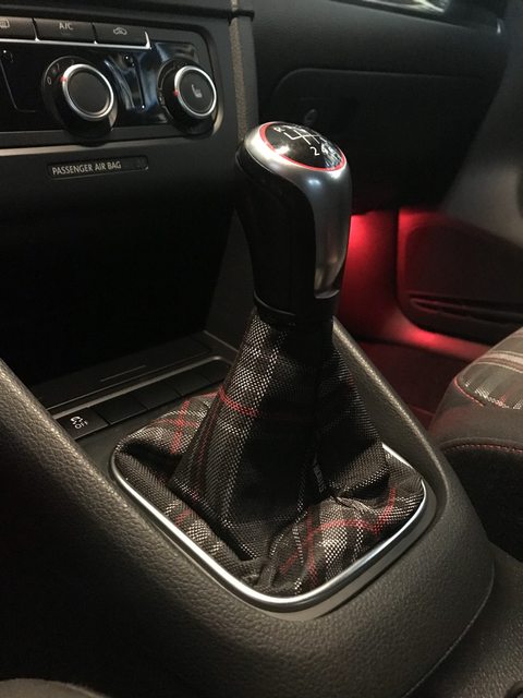

Back to the OE **** and I might cut an inch or so off the shifter to drop it a bit but haven't decided.

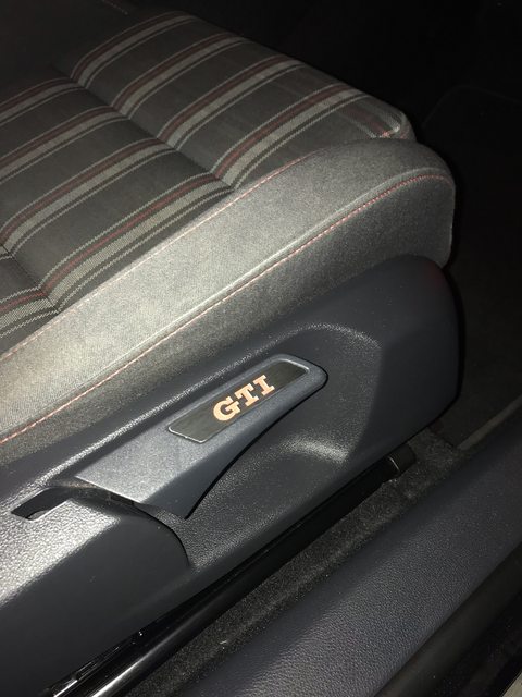

Added minor interior bits. eBay seat lever inlays and a vinyl graphic for the steering wheel logo. Tartan (plaid) of course to match the seats and shift boot.
Camera flash washed out the color but it's a darker red.

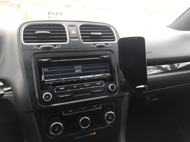

Installed a Rennline phone mount. Fit was excellent and put the phone in the perfect position to change music. Going to make a pop socket adapter so that I can mount my actual phone. When I want to data log then I can remove that and mount my android phone that is only used for changing car settings and data logging.

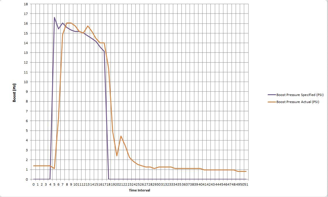

Did some random logs too just for fun.
