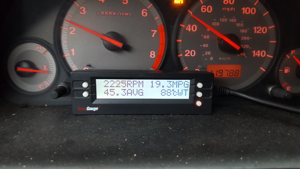

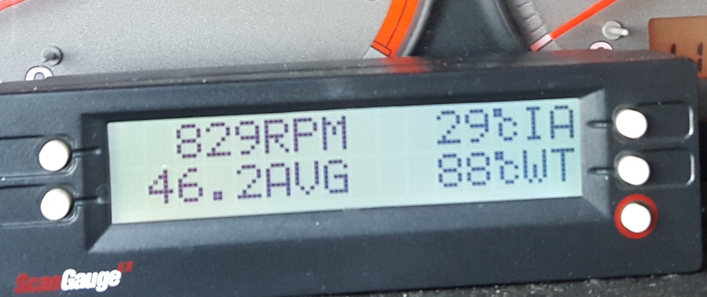

just realized i have not post the mileage I am getting with the cam still in there
this is the best ever trip, some 25 miles with HWY (70 MPH), so local (55 MPH) and city (35 MPH) - very short stretch
second best ever - today, so after the header install - it still can do it!
