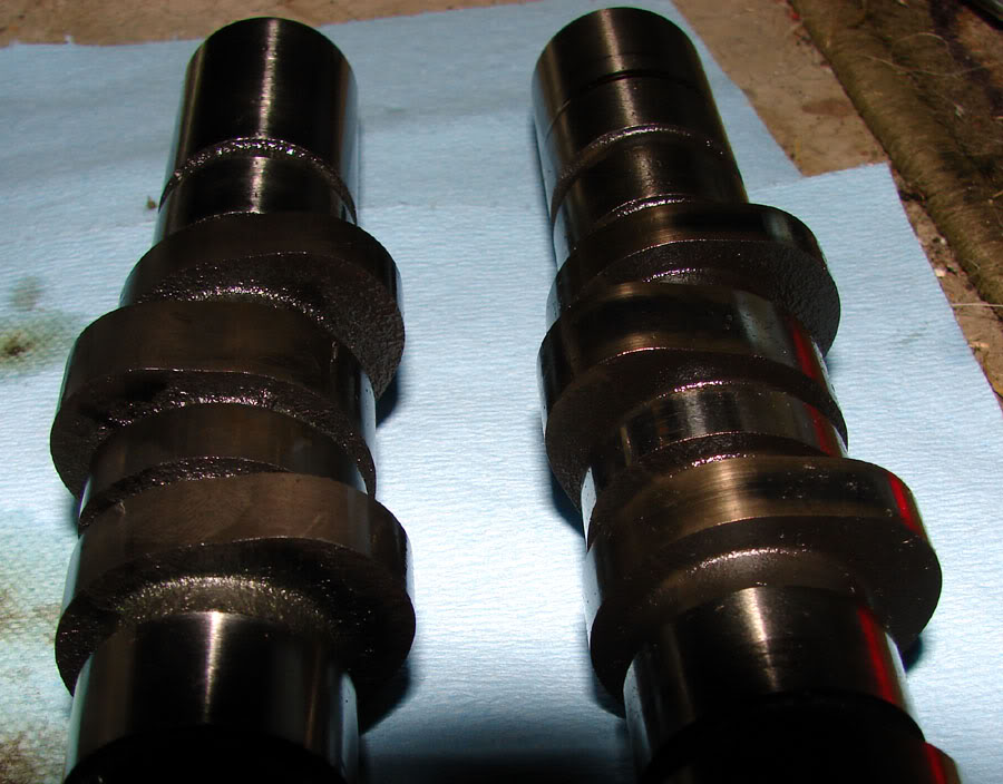

Old Jun 3, 2011
Posts: 15,190
Likes: 1,609
Re: Stage 1 Cams
follow a picture comparing the 2. Crower is in the left. There seems to be a slight wider cam top, and the lift is slightly higher.
Not very noticeable visually, but that IS the reason it does NOT require a EMS/springs/retainers.
Unfortunately, i could not find a better angle to compare them... Will try again tonight.

Re: Stage 1 Cams
I can barely tell the difference, they're almost identical! That's probably due to my untrained eye haha. Not enough experience in the aftermarket world :P

Added more info, excellent comparison pics sdaidoji.
