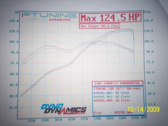

The dyno sheets and reviews are clearly posted in the thread.
The cam adds a significant amount of power for the cost and there are very little to no issues with idle or power loss, as would be the case with a more aggressive cam. If you want to mod the engine on a D17 without purchasing k-pro, this cam is the best possible option.

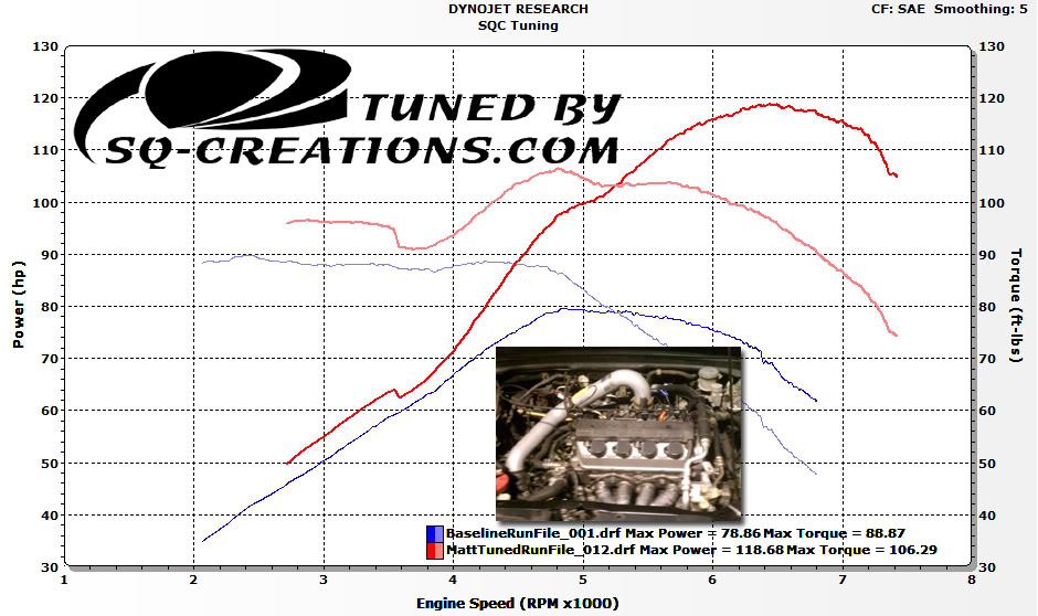

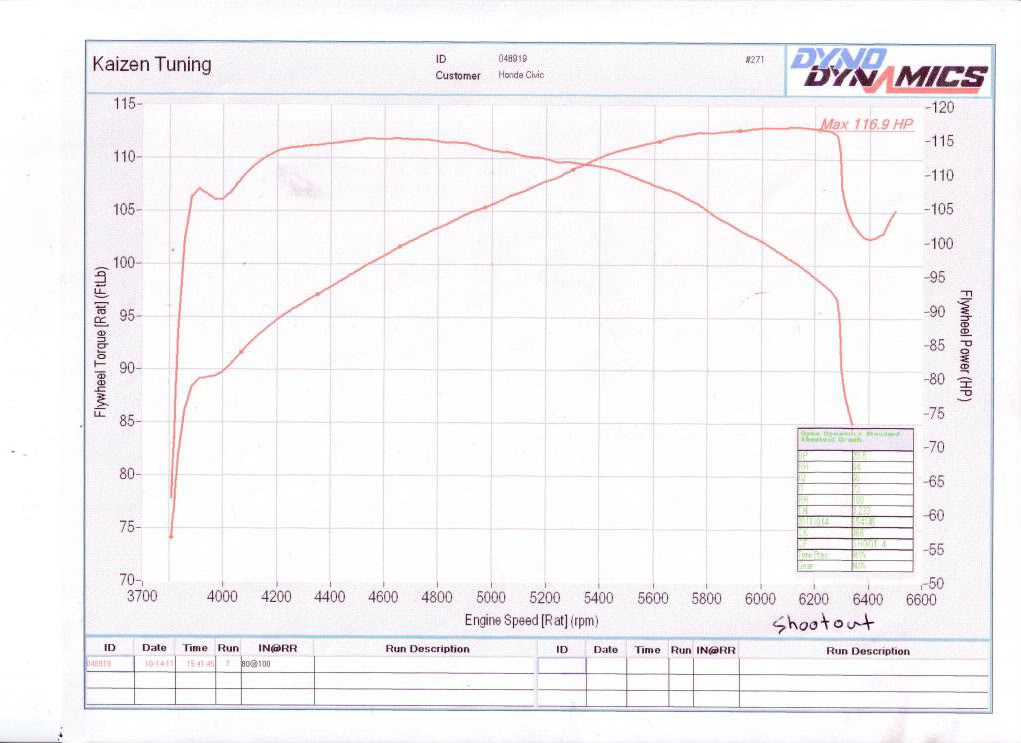

The photo broke, here they are again.
Automatic I think with I
5 speed with I/H/E at 6500'
5 speed with I/H/E

thanks. yeah see for me i would not even notice a difference driving under 3k rpms all the time. looks like nothing happens until 4k rpms. rarely do i rev past 3k rpms, and maybe handful of times a year above 4k rpms. its a good mod if you like to redline all the time, but i cant afford that anyway.
something also seems wrong with the second graph if the power starts falling at 5krpms. doesnt look anywhere near what a stock civic makes.

fact - ye don't lose on the lower range, but gains in the upper. And mine have the mileage now at 30-33 hwy/cty mix (haven't driven for long trips to tell how it is HWY only, though. up from the 28 MPG normal so i am pretty happy :P)
when i need it to pull more, it does
