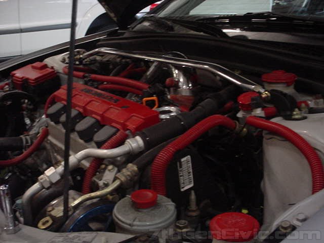

Im going through members rides and taking shots that may work. 1.

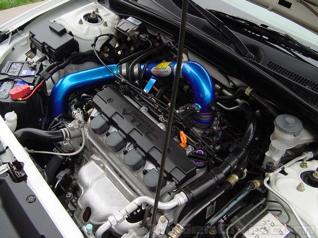

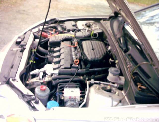

Sorry to the members that I scalped these from but hopefully we can make this work to benefit all of us. Punk, let me know if you want more.

Thanks blouisgod. If you find more post them.
The first one you posted would be one of the easier ways to do it.
The Strut bar that they use has a mount that comes out some.
You can make a bracket and secure it where the NUT and the bar meet.
Then bolt that end of the damper to it and make another bracket that is "L" shaped that can be bolted to one of the bolts on the motor mount and then simply mount the other end of the damper to that and your done.
It would work But I'm not sure if the Bar could hold the constant anount of presure it might have to endure.
I'll do a chop shortly

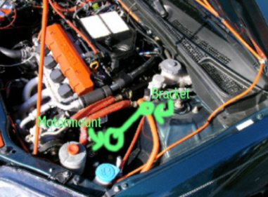

Here is crude example, I'm at work and did a quick chop of my rantings above.
I have the Neuspeed bar which is another challange in its self
I don't thing there is enough threading to add another mounting bracket.

I think that pressure will snap that bolt in 2 really easy. I was thinking of bolting it to the strut sleave near the fender well (bolting the plate onto the sheet metal). Where can you bolt the brace to the engine?

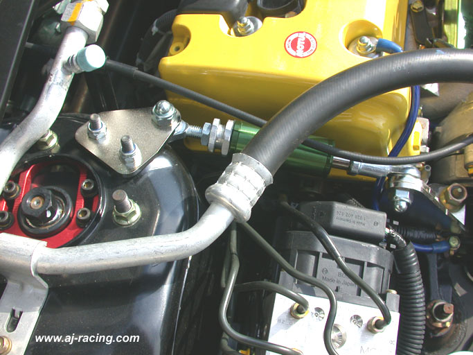

dc5 version on an ep3.
Ive read the dampner is more feasible than urethane mounts and easier to work with. Most arent adjustable, however, spoon is making one that looks like a coilover so its fully adjustable (K- series only).

true less work as well. for the JDM shiznit you'll pay $200 and up for the damper
the ep3 verison made by J's and sold on www.boomplustoys.net is $244

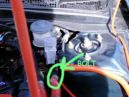

I have another Idea
The yellow area in the pic below, I was thinking might be a good area for mounting.
question, The red area in the yellow area in the picture, Is that threaded?
I know there is hole by looking at numberous engine pics.
Can someone answer this for me I'm currently at work and cannot go check.

the two sides are threaded thats where the stock intake bolts up... the holes are not big enough.....
I wouldnt suggest bolting oon that side... either ur gonna bolt it up to the coolant system which is right there.. or ull be bracing it to the cam on the head. either of which are not a good idea

here's what i was able to ge; i dont know if itll work so let me know.
the location of the first bolt is about 8-9 inches from the second.
