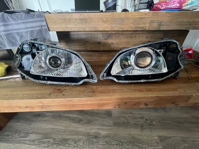

Left is H1 retrofit, right is mLED 2.0 retrofit.

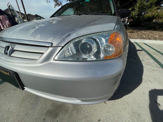

Here's what it looks like in the housing on the car:

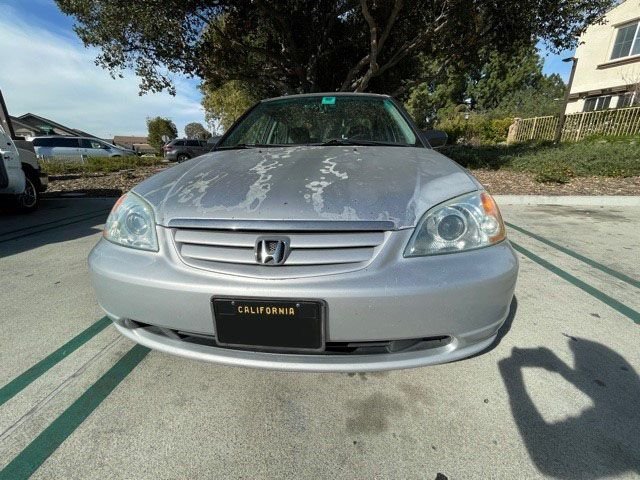

Here's the output:
I'll get some better cutoff pics soon.

That side cutoff looks great! Thanks for posting up. Pretty sure this is the first time I've seen an mLED retro posted up anywhere
edit: I wanna see what the cutoff looks like on a wall. lol. Also, not gonna lie, makes the 7thgen look more bugeyed than a regular H1/D2S retro. lol
