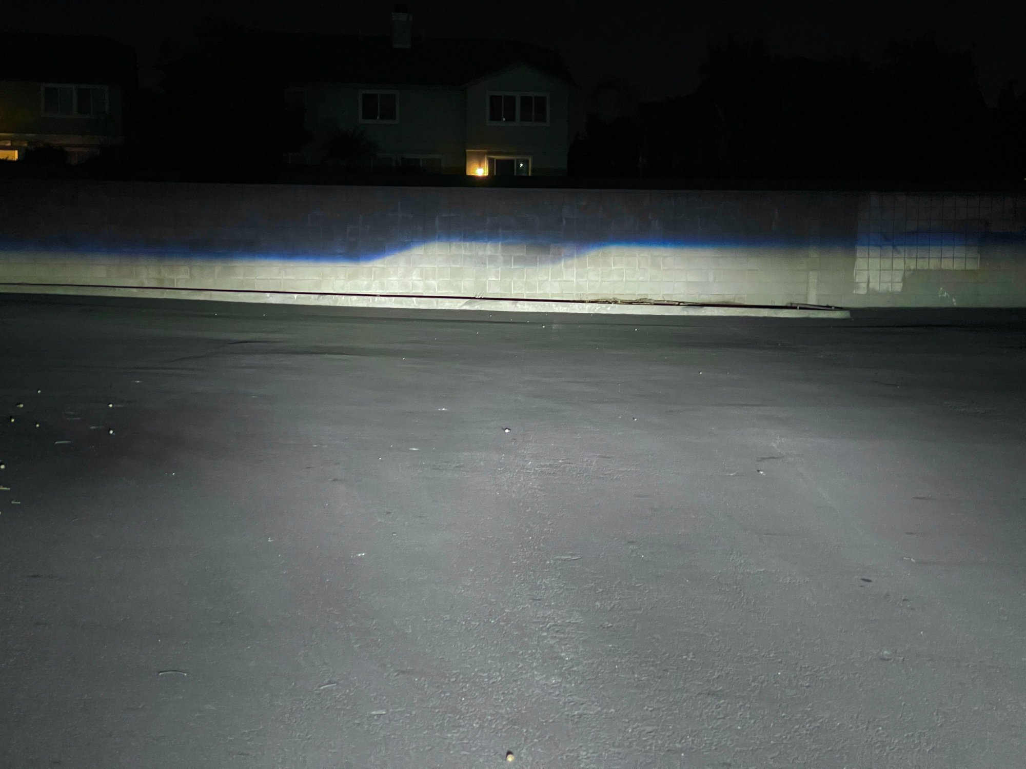

Left is H1 retrofit, right is mLED 2.0 retrofit.
the LED driver is mounted on the bottom side of the headlight. I 3d printed a mounting bracket. I uploaded it here for anyone to print: https://www.thingiverse.com/thing:4719201
Here's what it looks like in the housing on the car:

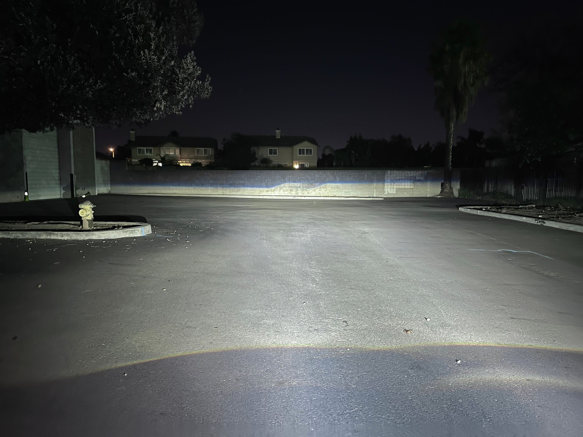

Here's the output:
I'll get some better cutoff pics soon.
This mod probably cost more than the car LOL.

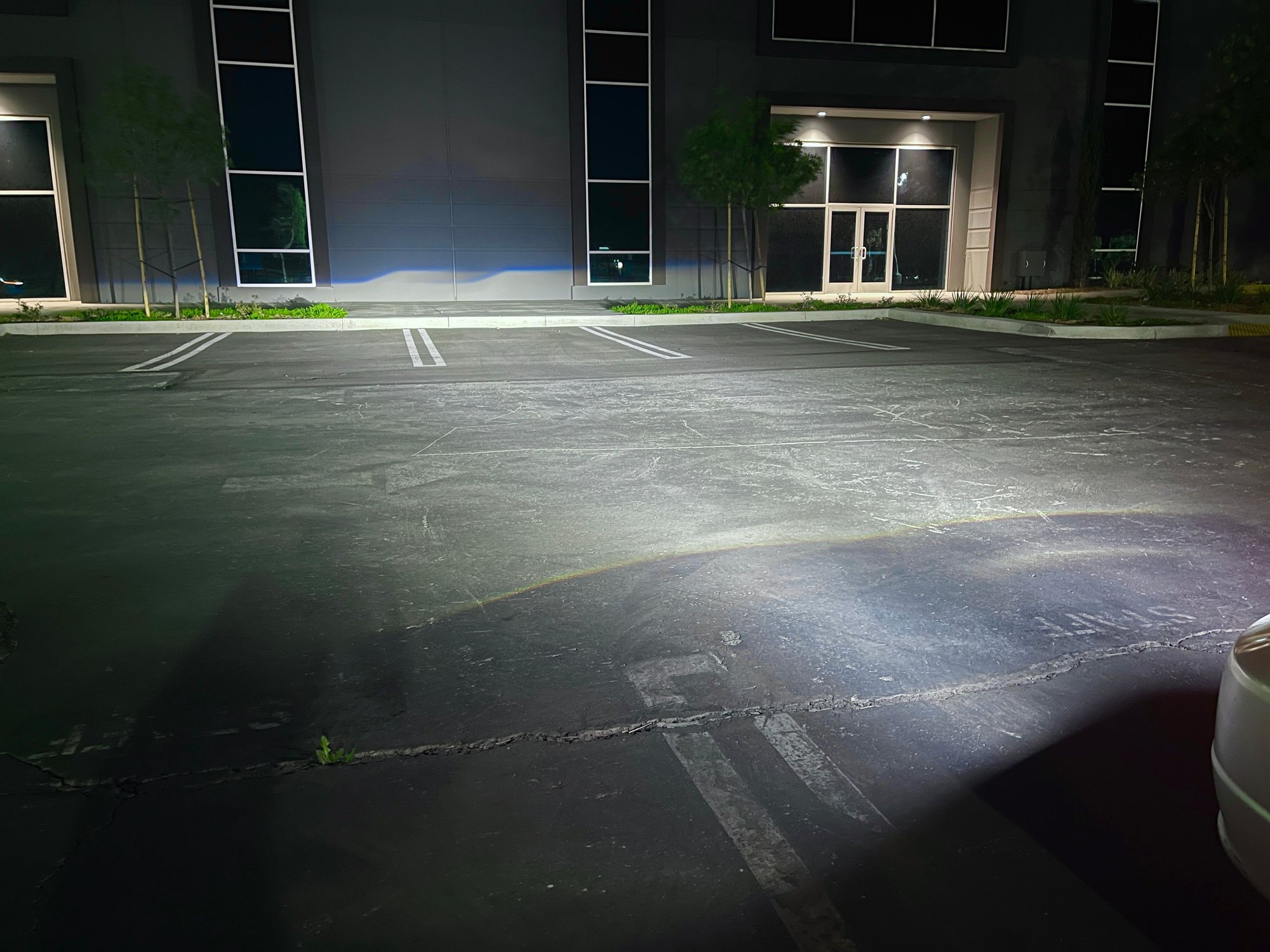

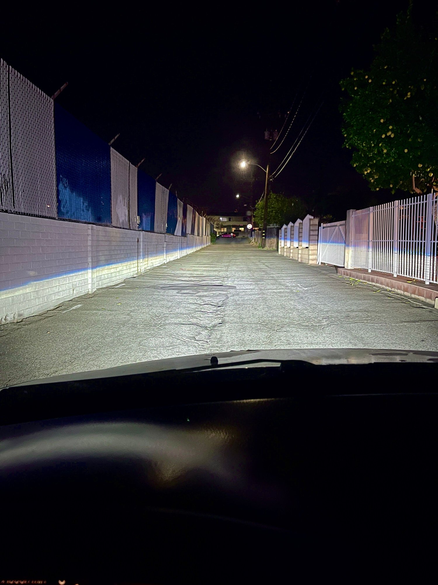

edit: here are some pics. So hard to find a dark place.

That side cutoff looks great! Thanks for posting up. Pretty sure this is the first time I've seen an mLED retro posted up anywhere
edit: I wanna see what the cutoff looks like on a wall. lol. Also, not gonna lie, makes the 7thgen look more bugeyed than a regular H1/D2S retro. lol

Thanks. yea now I can see much better at night.
