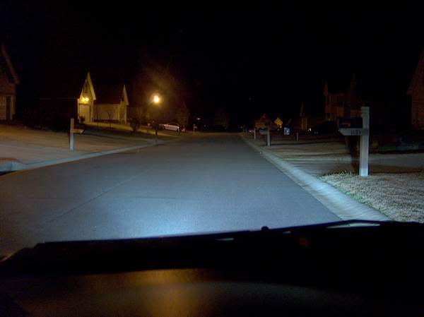

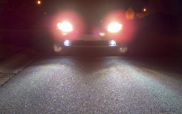

After researching on HID Planet for awhile, I bought these projector fogs made by Blazer and put a 894 4300K pnp in them. i'm very happy with the results so far.

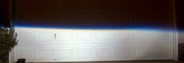

here's an output pic of the blazers. got the kit for $117 shipped off ebay. pic was taken at about 25 feet away from my garage door. the beam spread for a good 5 feet past each side of the garage. that's a 2 car garage so it's about 22 feet wide. i was holding the projector in one hand and the camera in the other, so things are a little crooked the projector and shield are unmodified. this was completely plug and play and here's the result.
here's what they look like installed on the car:

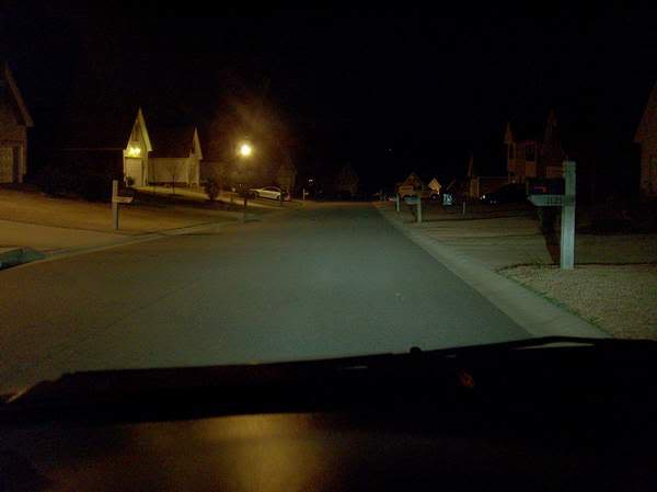

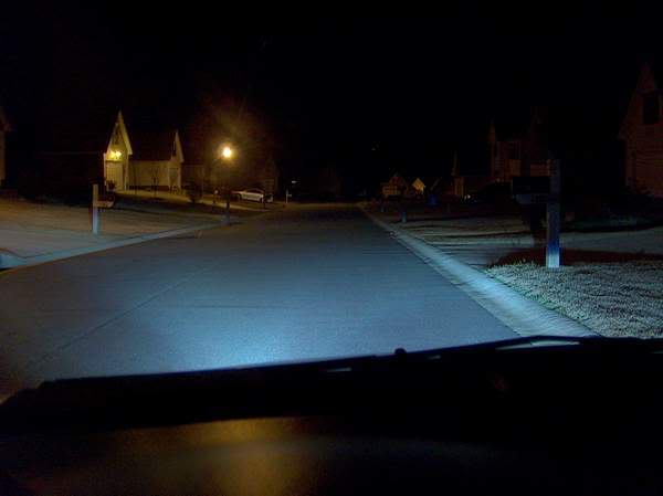

now for some street shots. output shots are on a lighted street because i tookd these real quick before going to work. i'll try to get some shots against a wall or something. i just aimed the blazers by sight down the street, so they're probably not aimed perfect either. anyways, here you go:
Sylvania Cool Blue halogen low beams:
blazers only:

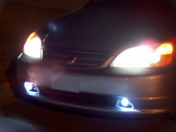

here's some shots of the front of the car that show the color difference. i didn't have a tripod so they're a little blurry:

halogen, yes. no modification needed. the stock bulb is an 894 halogen. the 800 series bulbs have a long focal point, so they're perfect for HID kits. i just bought an 894 HID kit and they plugged right in. any of the 800 series bulbs will work as they all have the same base.

no tips. buy the fogs. buy the pnp kit. mount them all up and plug them in. completely plug and play. no mods needed. i had to take my bumper off to mount the ballasts close enough for the wires to reach. but that was easy.

lol ur fogs are brighter than ur normal low's

i know! it's sad. that's why i gotta finish my TSX retro!

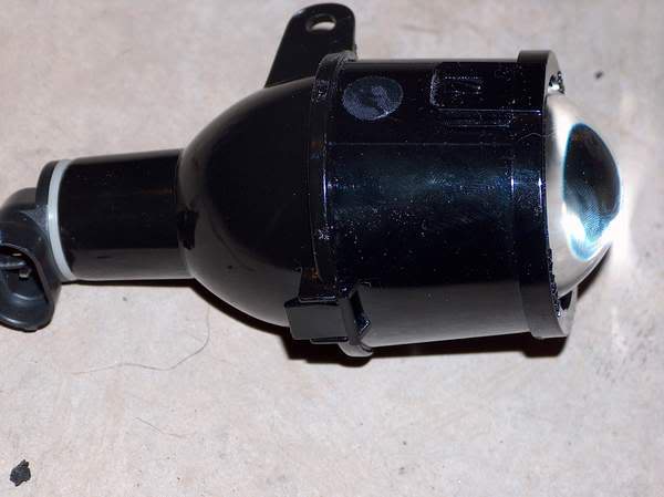

here's the fog:

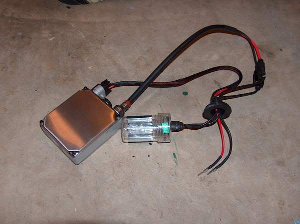

and the pnp kit

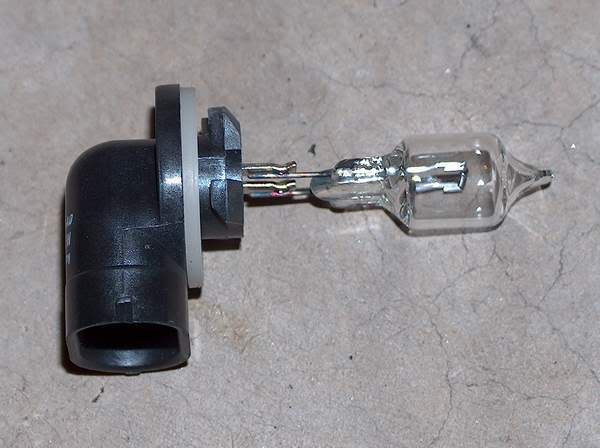

stock halogen
HID bulb
that big plastic ring has to be cut off. the small rubber piece is the gasket. don't cut that off.

the connector in the top left is the power connector. the ends are the bare metal leads on the bottom right. i cut those off and put some crimp connectors on mine to make connecting and disconnecting easier. the red goes to the power coming off the contacts of the relay (yes, you want to use a relay) and the black goes to the chassis for a ground. the switch inside your cabin connects to the positive coil of the relay and the other side of the coil is grounded. for power into the switch, you can either go to the battery, or a constant hot fuse in the fuse box. or you can tap into the parking lights power. i did the latter so the warning tone would alert me if i'd left the lights on (i killed my battery several times in my old car from leaving my fogs on during the day.) the power going into the contacts of the relay come from the fused power coming right off the battery.
