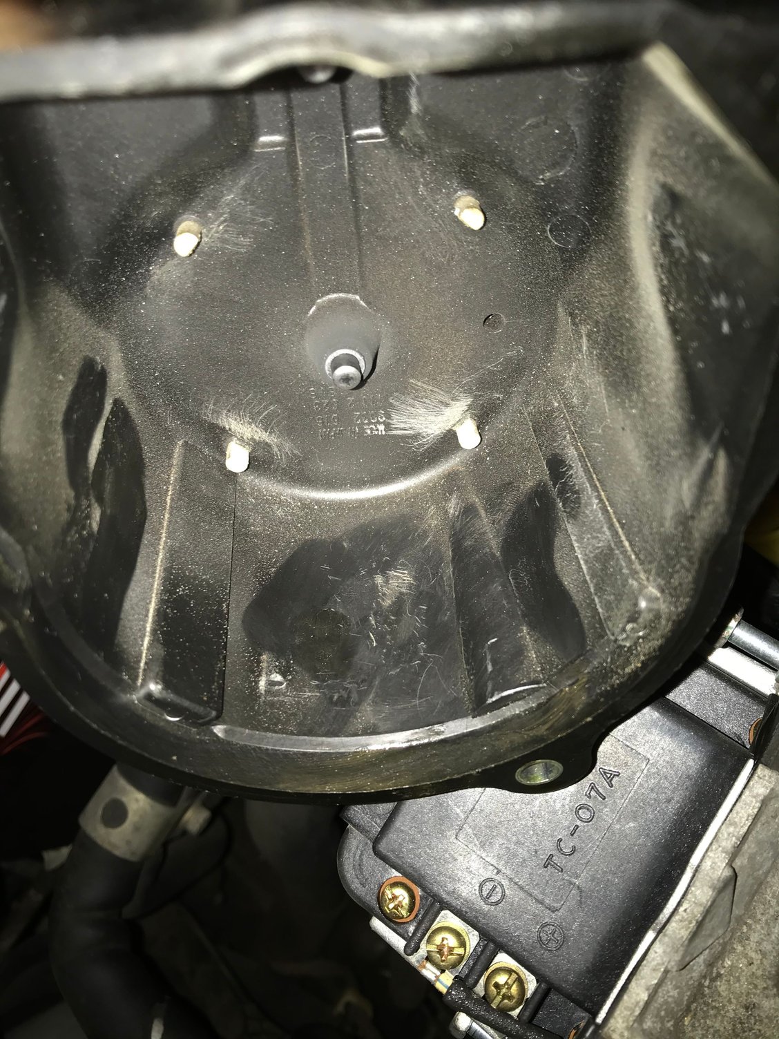

I have a 1991 Honda Civic DX that cranks but won't start. I tried starter fluid, and it wouldn't work. The battery is good. The fuses check out. I'm 99.9% sure the main relay is good. When I tested the ignition coils by putting spark plug in there, there was no spark in the plug. I was advised to simply replace the distributor, but according to ErictheCarGuy, you could usually fix it. He said that if the distributor was bad, the inside of the distributer cap would be covered in grease. When I took the distributor cap off, it was a little greasy at the bottom of it. Does that mean I should replace entire distributor or just simply ignition coil or some other component?
Keep in mind, I haven't checked ignition coil or igniter within the distributor. The distributor I plan on replacing it with would be of Nova Auto brand that costs $60 with free shipping and free returns but buyer pays return shipping.

I think the cap looks fine.
I don't know if you can tell, but there's that oil at the bottom that I was talking about.

OK, now that the most common issue we see is not the case (cracked cap), I will need to say I have never heard someone coming here in this forums asking about it, but after doing a quick google search, seems that oil in the distributor is fairly common on 6th gen honda (I am only familiar with old VW distributors, sorry)
https://honda-tech.com/forums/honda-...butor-3151269/
since your car is already not starting... Maybe the oil caused issues to the electric components inside.
Dismantle it and clean, replace the electric parts?
https://www.bkhondaparts.com/v-1991-...e--distributor
It could just be the igniter that is on its last toes... that is what caused issues on my old beetle.
