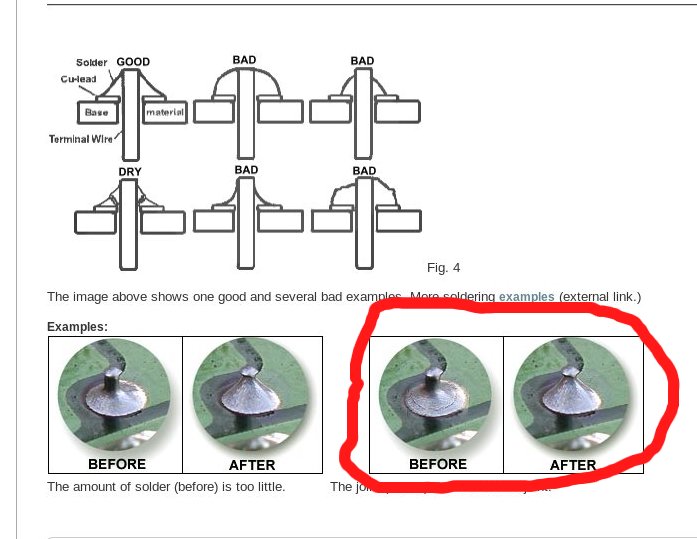

What you want to look for on the main relay is stuff like this.
https://www.civicforums.com/forums/1...ont-start.html
see the 2 broken contacts at the bottom?
This poster never replied again after suggesting soldering it so I can only guess that solved his/her problem.

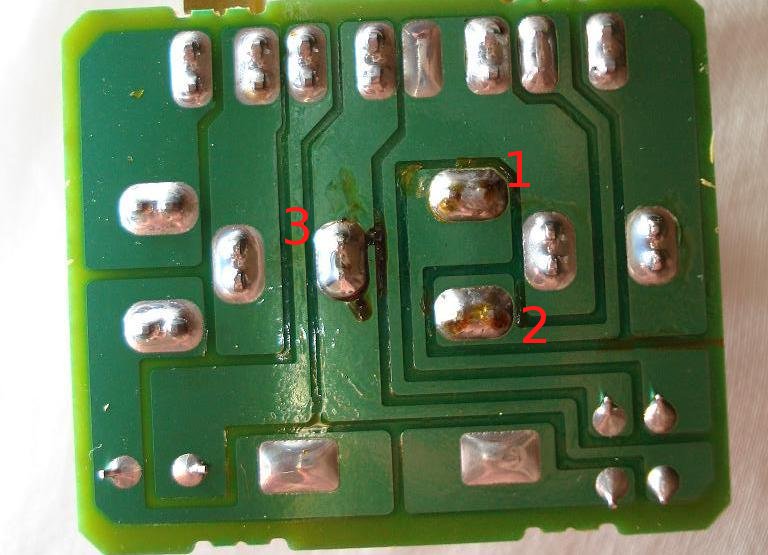

Solder on my relay looks OK- right? (click pic...)

It's kind of hard to tell from that resolution but it looks like 1,2,3 have been re soldered. 1 may be a dry joint but again hard to tell from that res.
