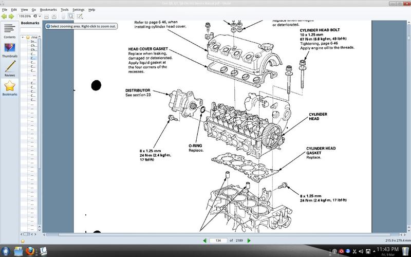

Yeah, I was just putting that out there. Tstat/coolant pressure being the major differences when it's warmed up. I don't know how the sitting for days factors in. The only thing I can think of is the gasket is still in early stages of failure. Generally the compression of the engine pushes into the cooling system and causes your coolant to overflow from the reservoir.
It would be helpful to know what model your engine is. Figure that out and get a FSM (Factory Service Manual) it will answer alot of questions for you.
I don't know if the 5th gens are stamped with the engine model # in the same place but this is where it is on the 6th gen...
https://www.civicforums.com/forums/1...vic-motor.html
This is a shot of my FSM with the exploded view of the headgasket. Cylinder bolts are torqued to 49 ft-lbs on my D16Y7

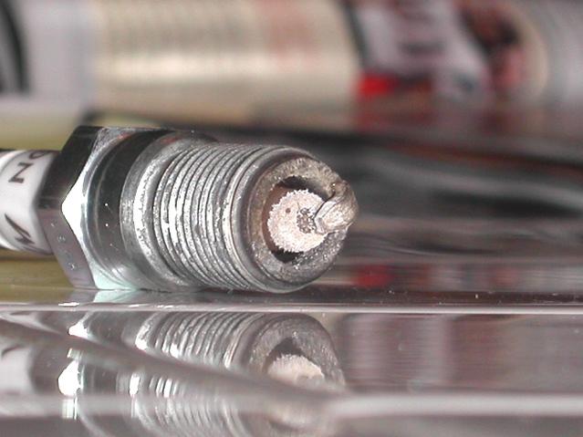

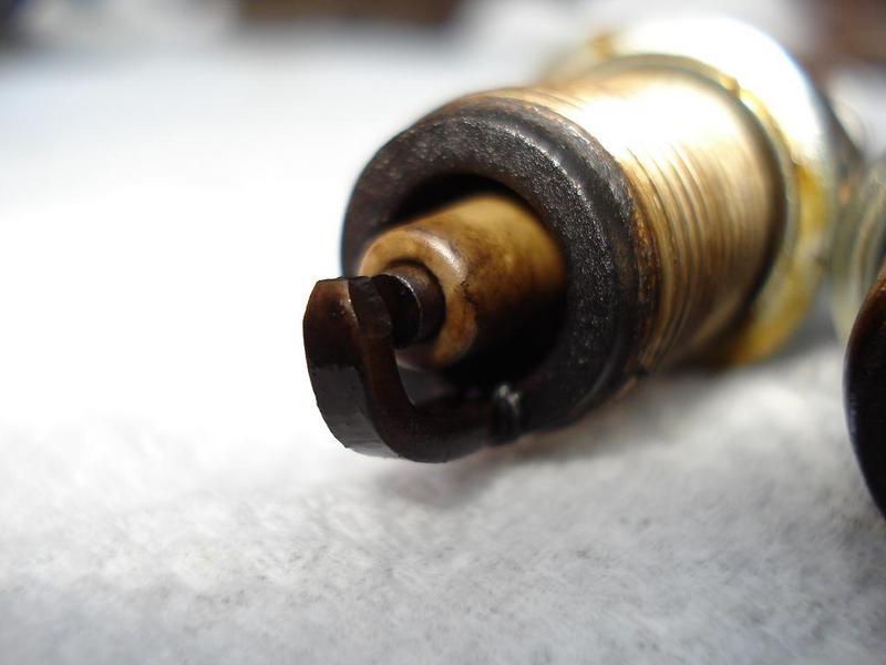

Instead of checking your O2 sensor just check your plugs. Pic below was a plug taken from a car burning coolant.
I'm always hesitant to say 'yes DEFINITELY' because I'm just some dick sitting at a computer on the other side of the continent in another country from where your car is located. Maybe there's some information I don't have that would lead to another conclusion but like I said before if your absolutely sure it's not leaking then it has to be burning coolant. Fix your leaks and see if there's a difference. It's possible that it's leaking on to your exhaust and evaporating off so it's hard to see. You can try putting a piece of cardboard underneath your engine after driving and see if coolant is leaking somewhere you haven't noticed as well. I would exhaust all my options before I started tearing an engine apart.
Mine definitely aren't furry like that. But the #1 was actually moist after a particularly large amount of bucking.

Status:

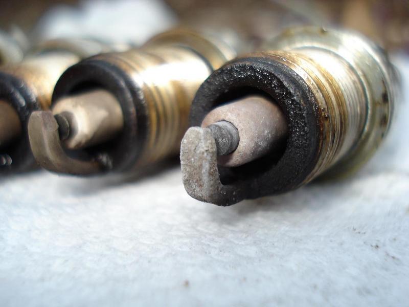

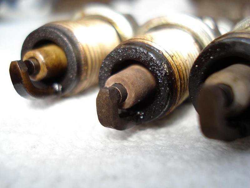

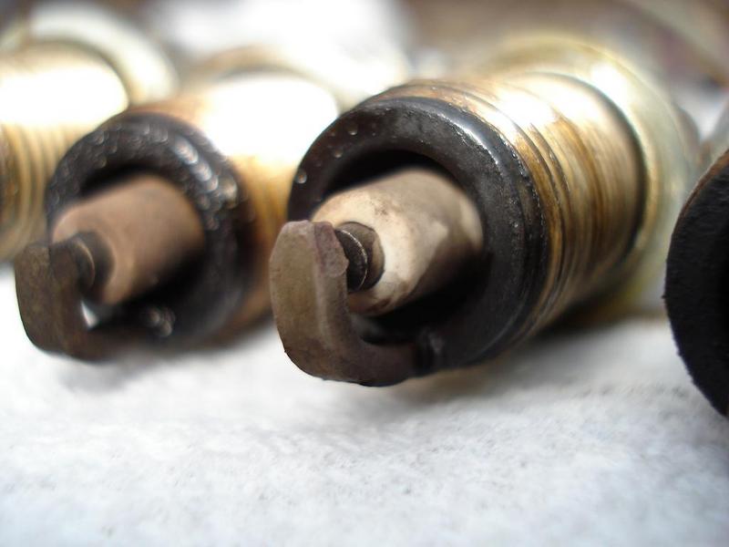

1) Car does not start at all now.
2) Main relay - passes first two tests, but third click is drowned out by starter motor so I can't hear it.
3) Ignition switch - passes all tests.
4) Plugs - Looks like there are white crystals on #1 after all (see pics).
Conclusion: Will keep testing spark/fuel problems... I don't think a slow coolant leak can prevent starting.

Re: Bucking/stalling/coolant issues after sitting 24hrs or longer
Fix your coolant problems before checking relays. the problems didn't start with electrical it sounds like it was mechanical to begin with. A warped head is going to change shape when it gets up to temperature. not sure how it wouldn't go back to crap after the head cooled. And now car doesn't run. check Spark compression and Fuel. if you have no compression the car isn't really gonna run. likewise with the spark and fuel

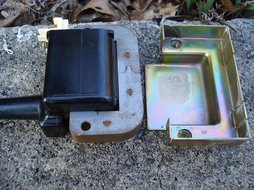

Seems I have a bad coil. Spark was weak and orange, coil has rainbow scorch marks (see pic), and positive-secondary resistance was too low- should be 13200 to 19800 ohms but it was 10000. A bad coil would explain the bucking/stalling when warm as well as the soot on the #2 and #3 spark plugs. It will be a few days until the new coil arrives...
As for the coolant, I will replace the cracked hose, backflush really well, and also flush with sodium citrate. Then I can see whether the sludge comes back and tell how quickly coolant is going into the engine. Is there any chance the sodium citrate could increase the head leak or cause a heater leak?

Originally Posted by dstroman
Strange it was only acting up on a couple cylinders.
I'm sure all four were affected. The soot is just more visible on 2&3 because they don't have additional problems confusing matters like 1&4 do. You can see what I'm talking about if you look at my pics of the spark plugs a few posts back...
Thanks for the tips on chemical flush and on driving with a leak. I'll post again after the parts come and I've had a chance to see if they helped.
