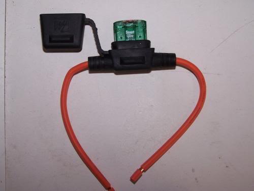

You aught to have my job. We cut 1-2 inch holes in brand new vehicles. There should be like 4-5 places to put that wire thru.
Do not hook any wires to the battery without an inline fuse. That fuse needs to be within 6 inches of the battery. I use something like this and put the ring connector on one end of it and the wire on the other side:
