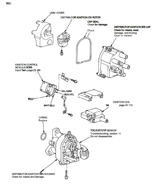

Igniter = ignition control module inside the distributor, it has 4 or 5 wires attached to it. It controls the ground signal on/off (trigger) for the coil, based on what the ECM tells it to do, based on what all the sensors tell the ECM.
See if you have spark, or not, at the coil....before worrying about the cap/rotor/wires.
