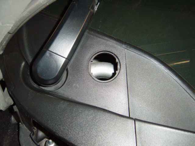

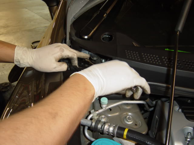

1) Put your window wipers up to take off round cover to better access the strut tower.
2) Take out cover to access strut tower.

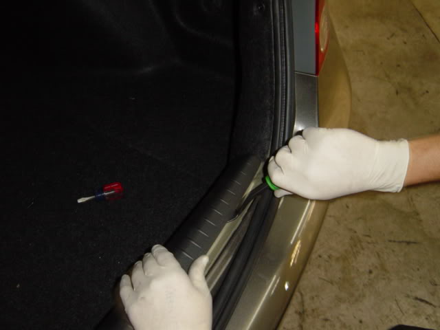

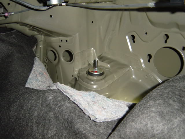

3) Take off back trunk cover.

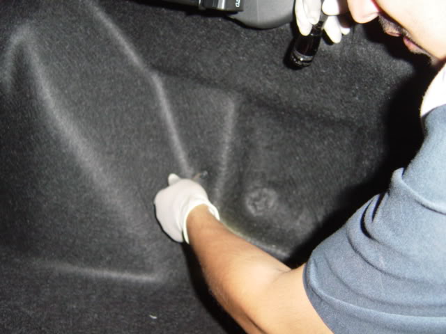

4) Take off tabs holding trunk carpet molding.
Here is what to get after step 4. It gives you better access to the rear strut.

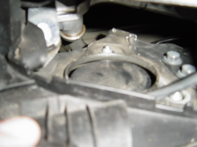

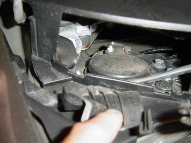

5) Loosen the three bolts for front strut.
Here are the three bolts I'm talking about in step 5.

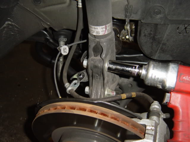

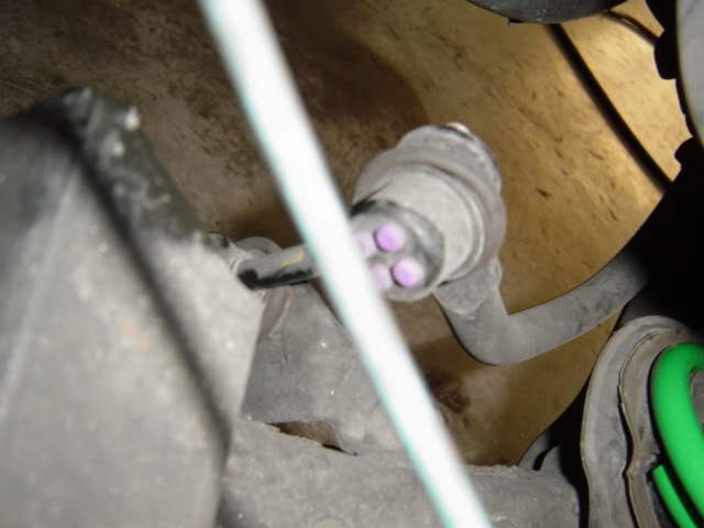

6) Unbolt break line and clip off ABS sensor.
Here's what you get after completing step 6.

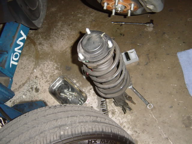

8) Strut towers should come down. Just take it off.
Here’s what the strut towers look like.

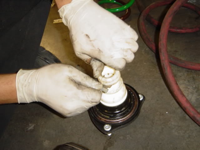

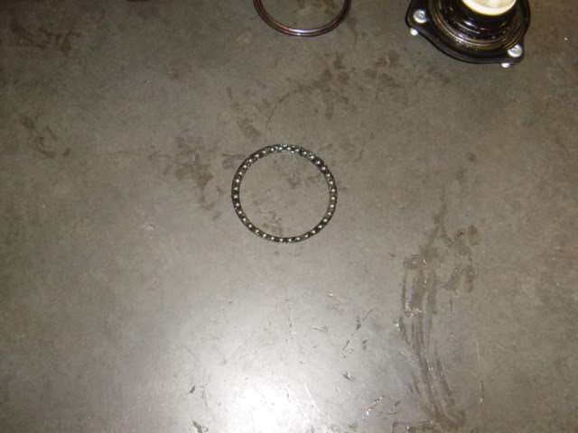

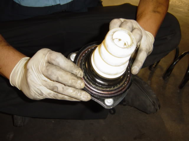

Be careful when taking off the assembly for the bump stop. We had to pick up 30 ball bearings from the floor and took a long time looking for them. My suggestion is taking it off upside down.
Here is the bump stop.

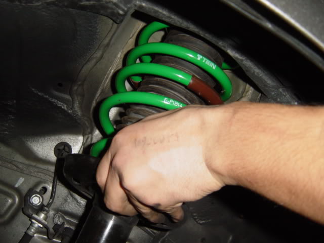

12) Assemble spring by twisting it into the strut cover.

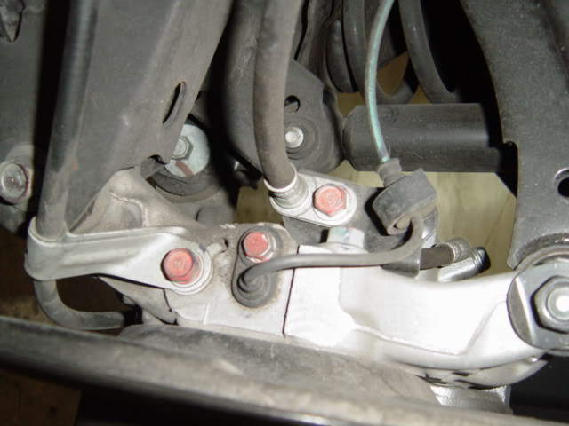

16) Take off bolt holding break line and unclip ABS sensor.

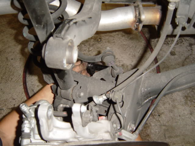

Also take off sway bar link.

20) Assemble everything back together.

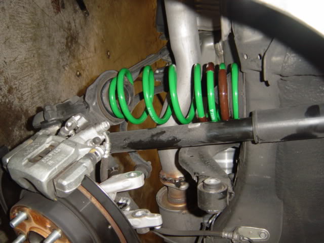

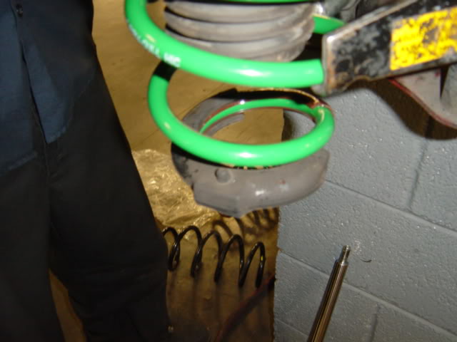

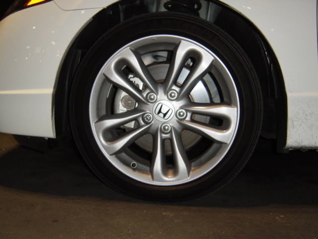

Difference between stock and Tien springs.
Initial drop is pretty decent. Wait +/- a few weeks for springs to settle.
The ride comfort still feels like stock springs, which is what you want.
Camber kit is recommended.
Project time took about an hour to an hour and a half.
