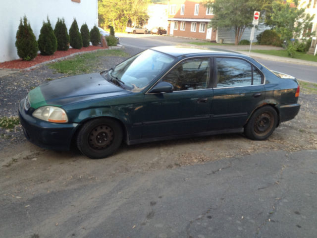

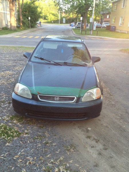

So ive finally decided to build a civic. Got a dirt cheap 96 ex its dented and rusty but i love to make ugly old things look new and purty again. So far ive started un-denting it ive lowered it with skunk2 springs and some struts ive got a skunk2 camber kit installed but not cambered yet a 4-2-1 header/exhaust system but stock muffler ive started cleaning out the engine bay and ive cleaned out the head.there will be plenty of updated during the rest of the summer. next step will be the body work

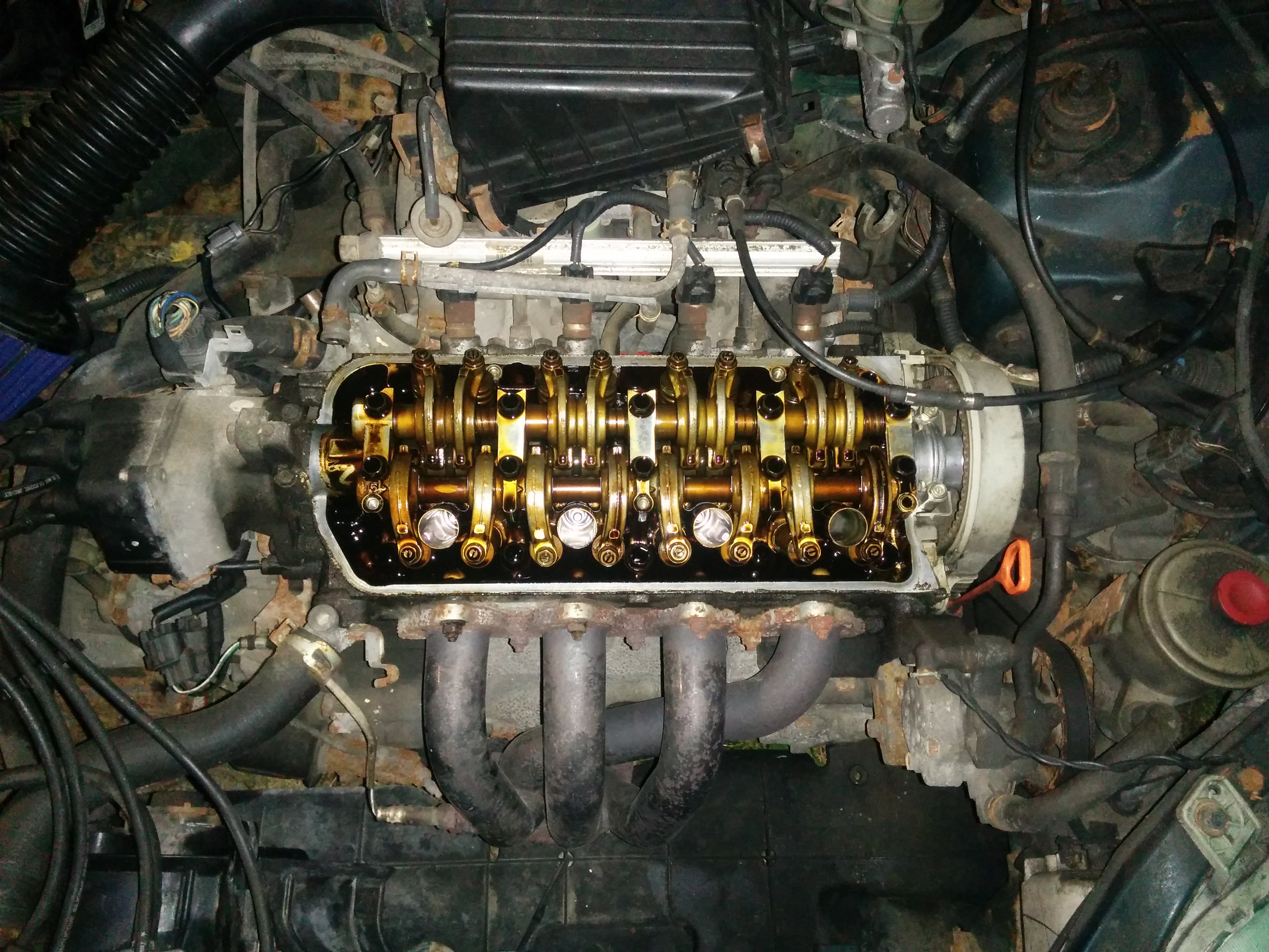

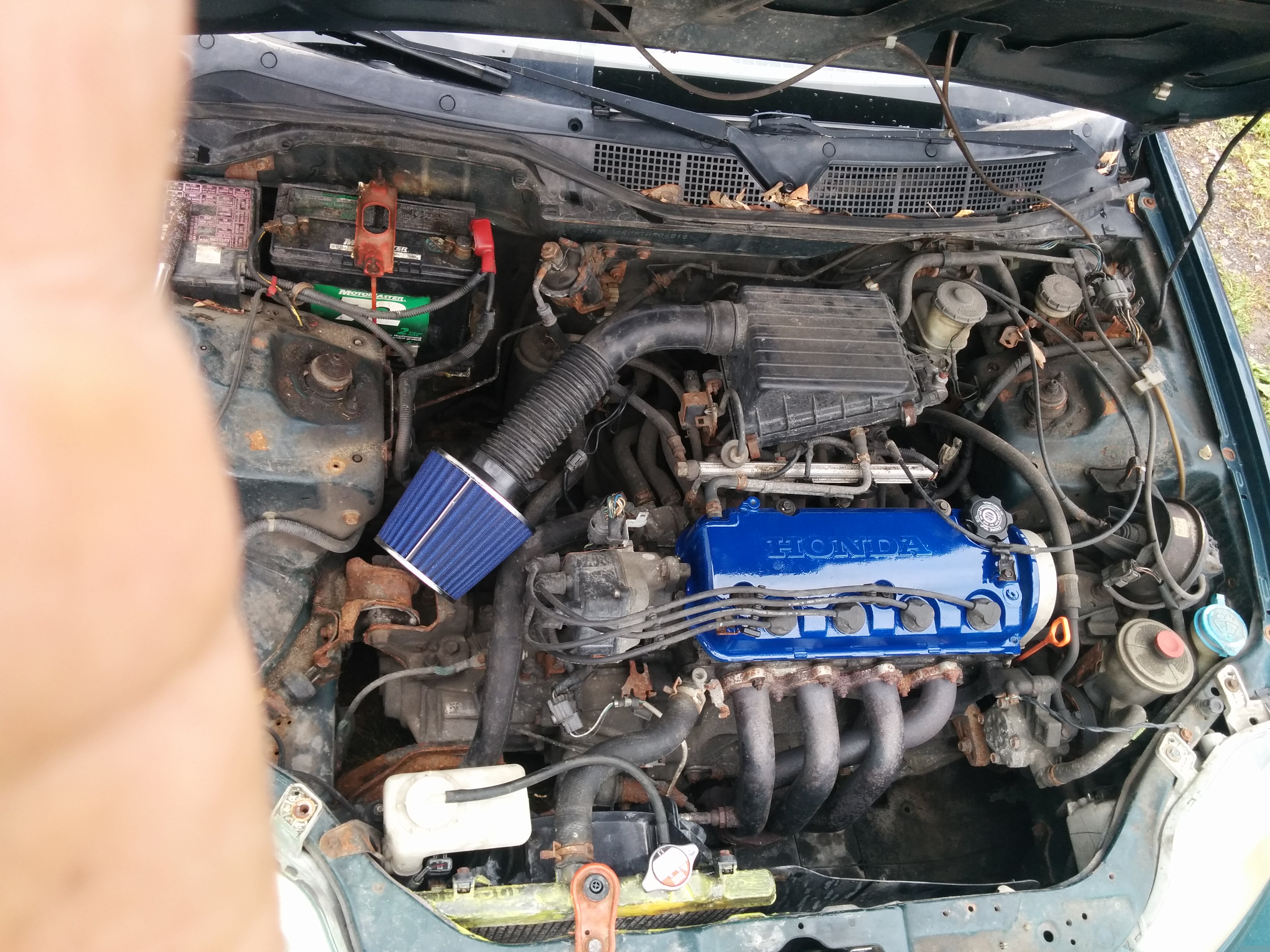

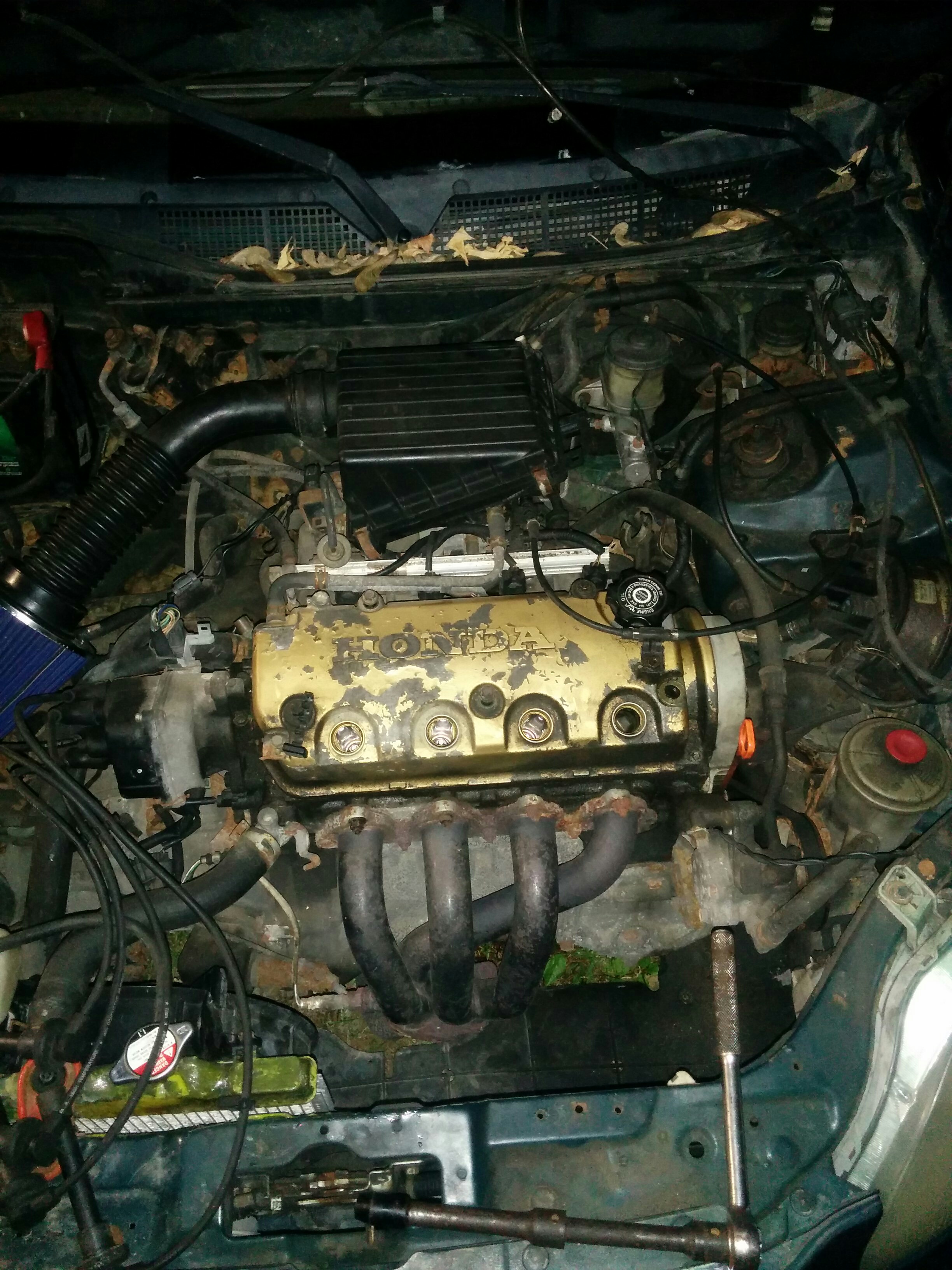

sanded and painted the vlave covver after removing grime from the head

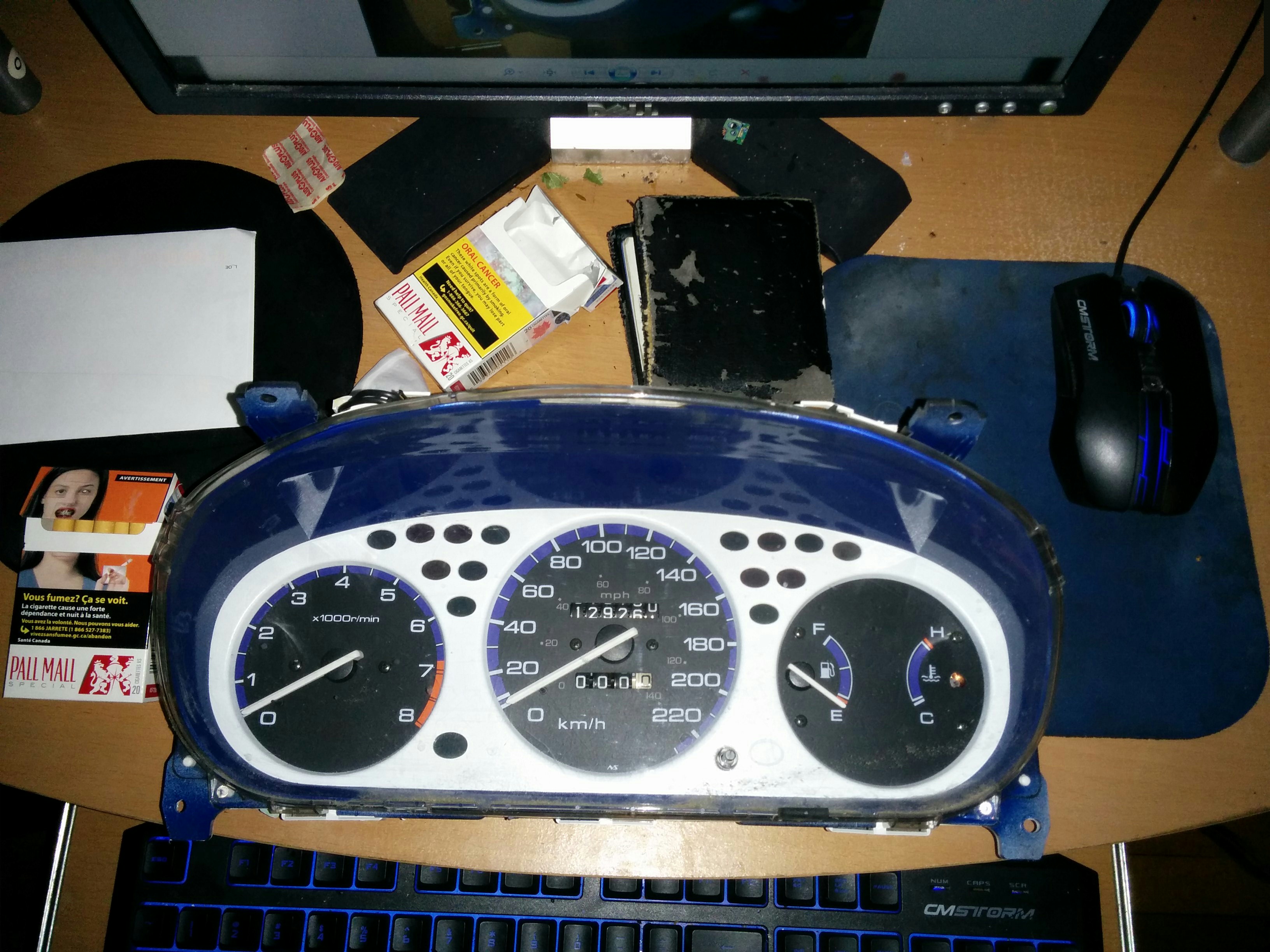

Got abit distracted and got into the inside while i was checking on my passenger side window malfunction and did some sexy work on my clauster.

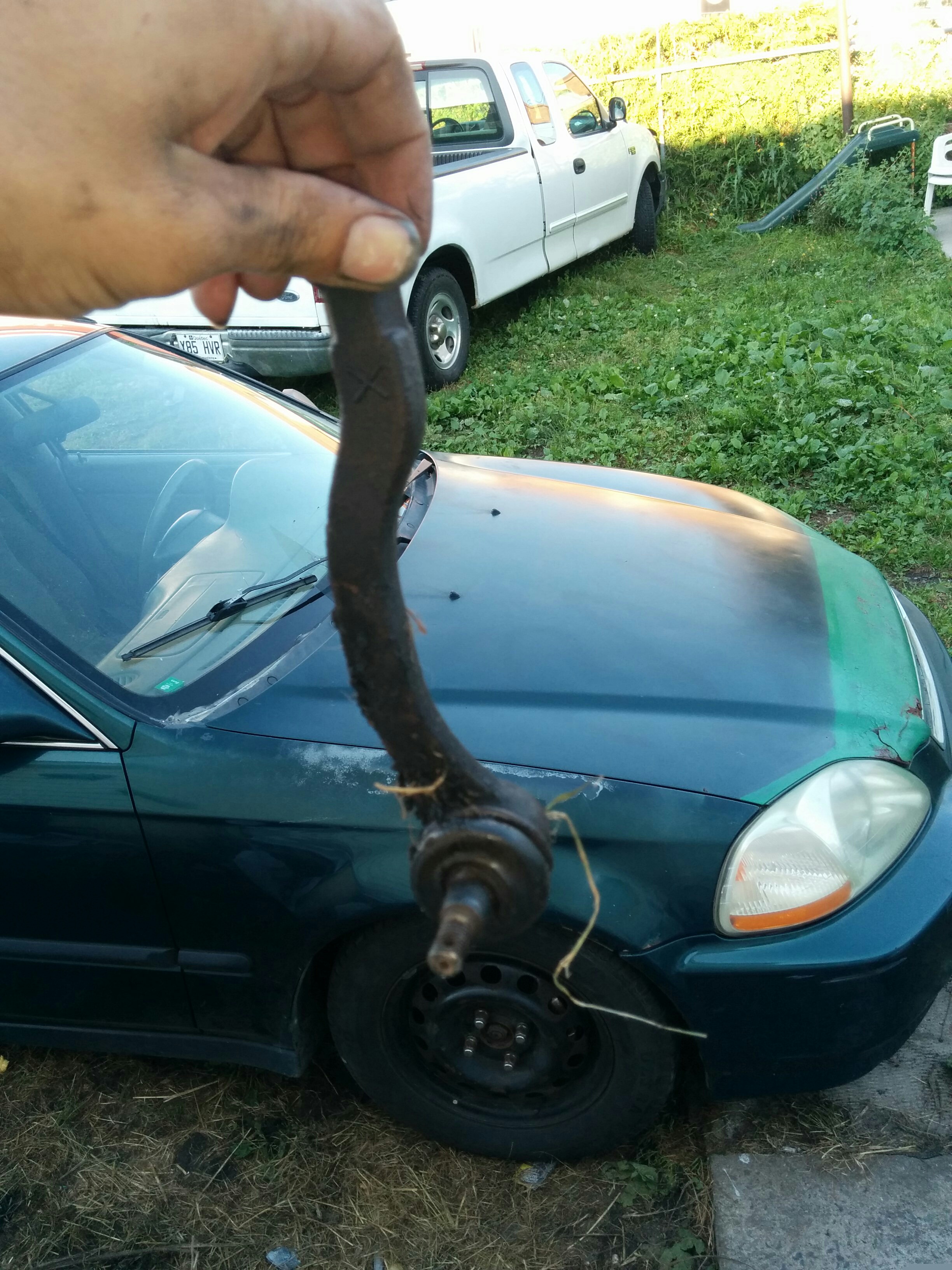

Re: my 98 ex build log in the worx (Pic heavy)

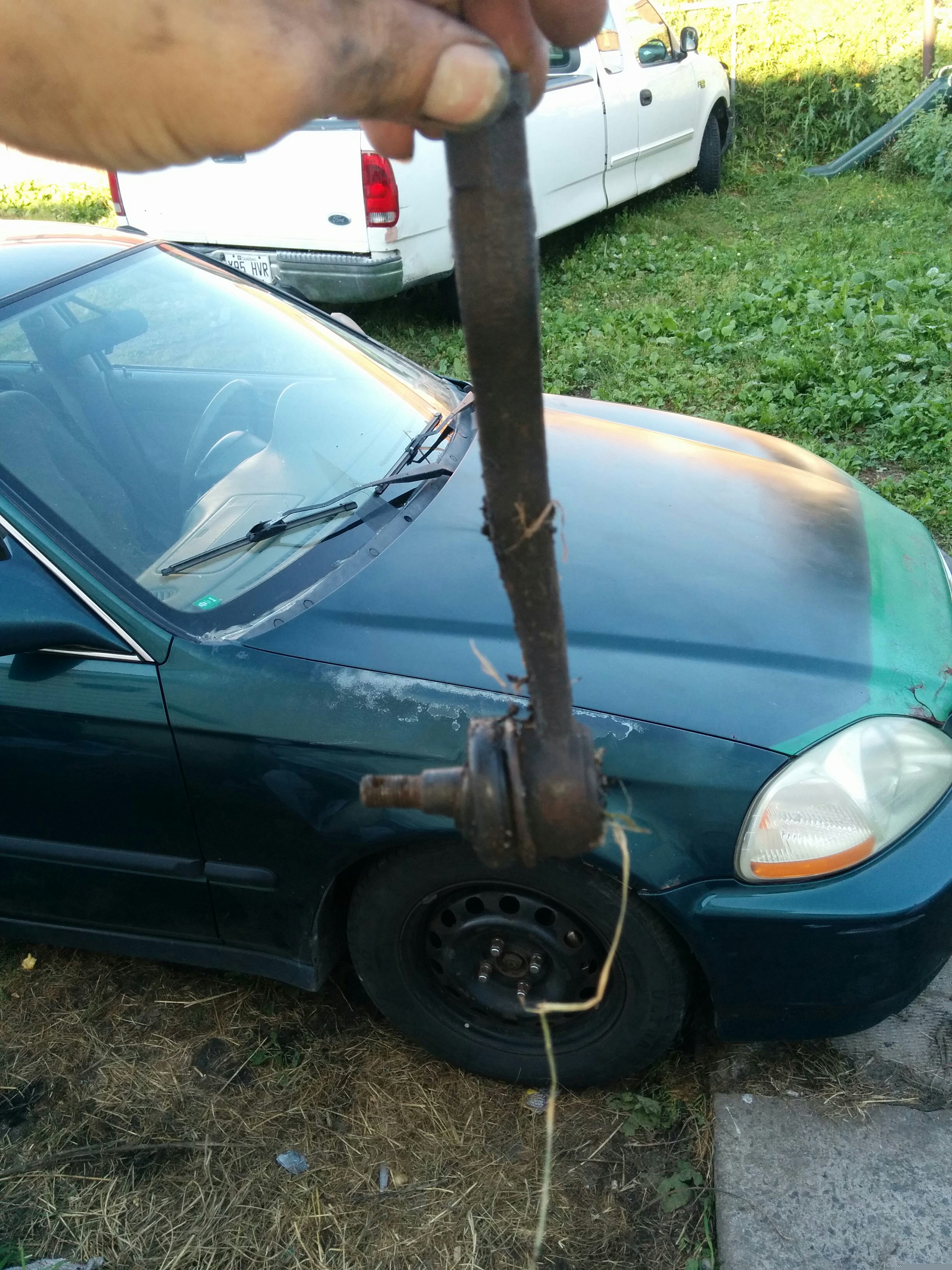

Changed out my tierod ends today they were so loose i could almost pull the ball out of the rod XD now that thats over with i can move onto more important matters like the windshield and swapping that head over.
Nice work.
You had better go and get it aligned if you haven't already.
Old Sep 15, 2015
Dave Brabant's Avatar
Joined: Sep 2015
Posts: 51
Dave Brabant is an unknown quantity at this point
Originally Posted by Mad Dog Tannen
Nice work.
na rod was the exact same size as the old one so i used my bosses(mechanic for 30 years) trick and used tire paint marker to mark off where to stop screwing in the tierod ends so the alignment should be the exact same as before.

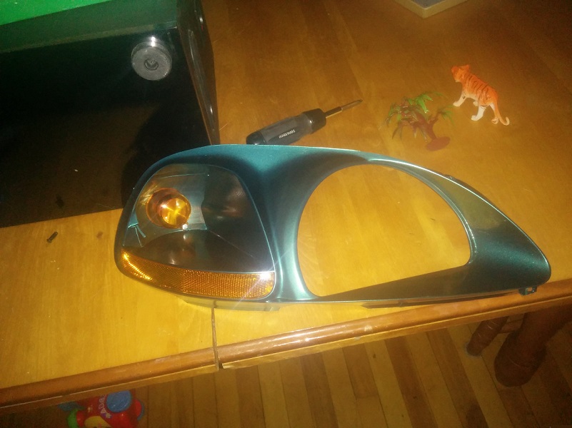

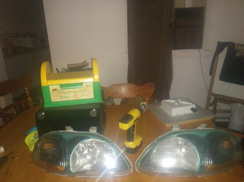

well as i had my headlights off for the body work and to clear them up i decided to go green housing! i find it looks cool what do you guys think ?
I got my boss to check the alignment and he said it was perfect so i shouldnt question his tips and tricks anymore haha :/

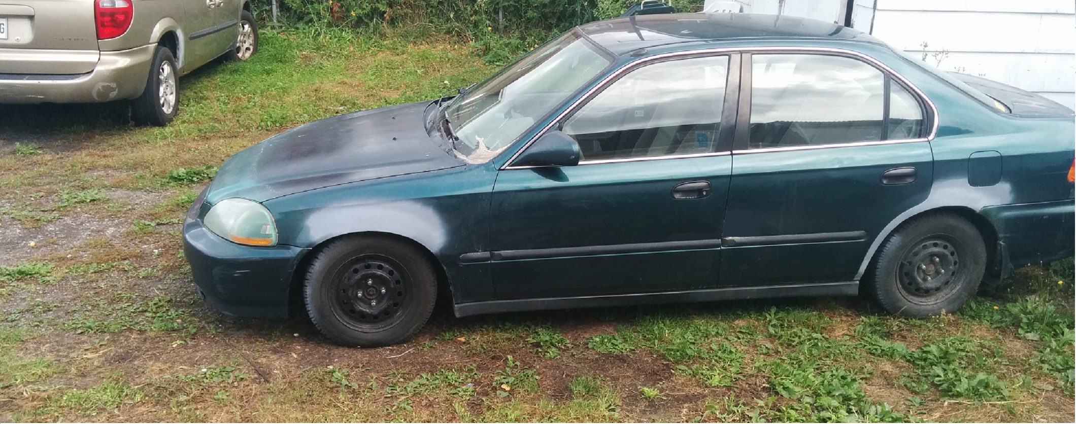

well did the body on the other side todayneeded to replace the rear fender and decided to undent the front fender from the fender roll the last owner did . the paint cracked up so i had to sand and prime it too. now the only rust left on the car is inside the gas fill compartment. im not the best at body work but i enjoy it.

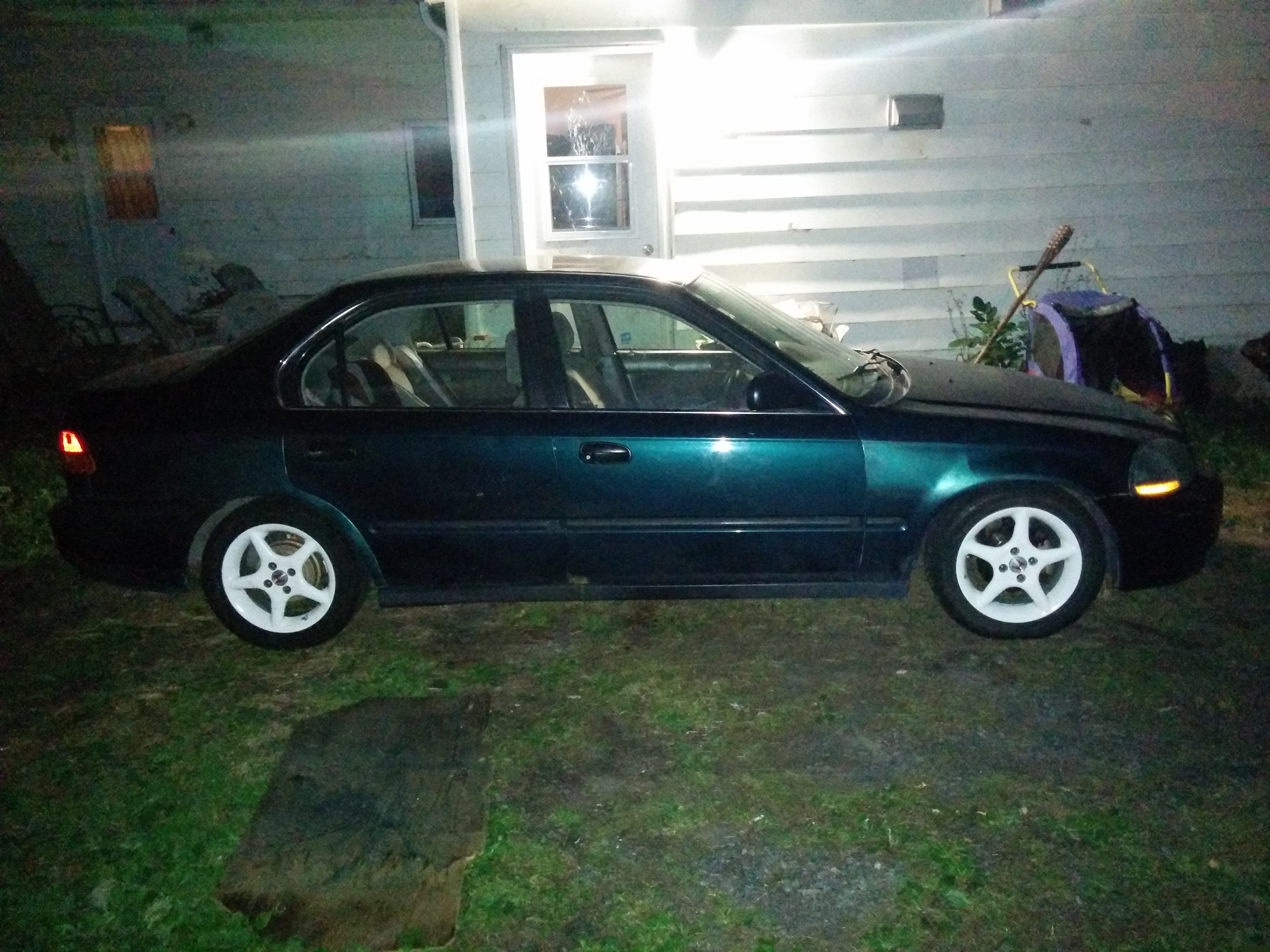

got my mags installed sweet find

Wheels look good!
Use an image hosting site like photo bucket to make pics bigger. Put IMG code pics into text fields.

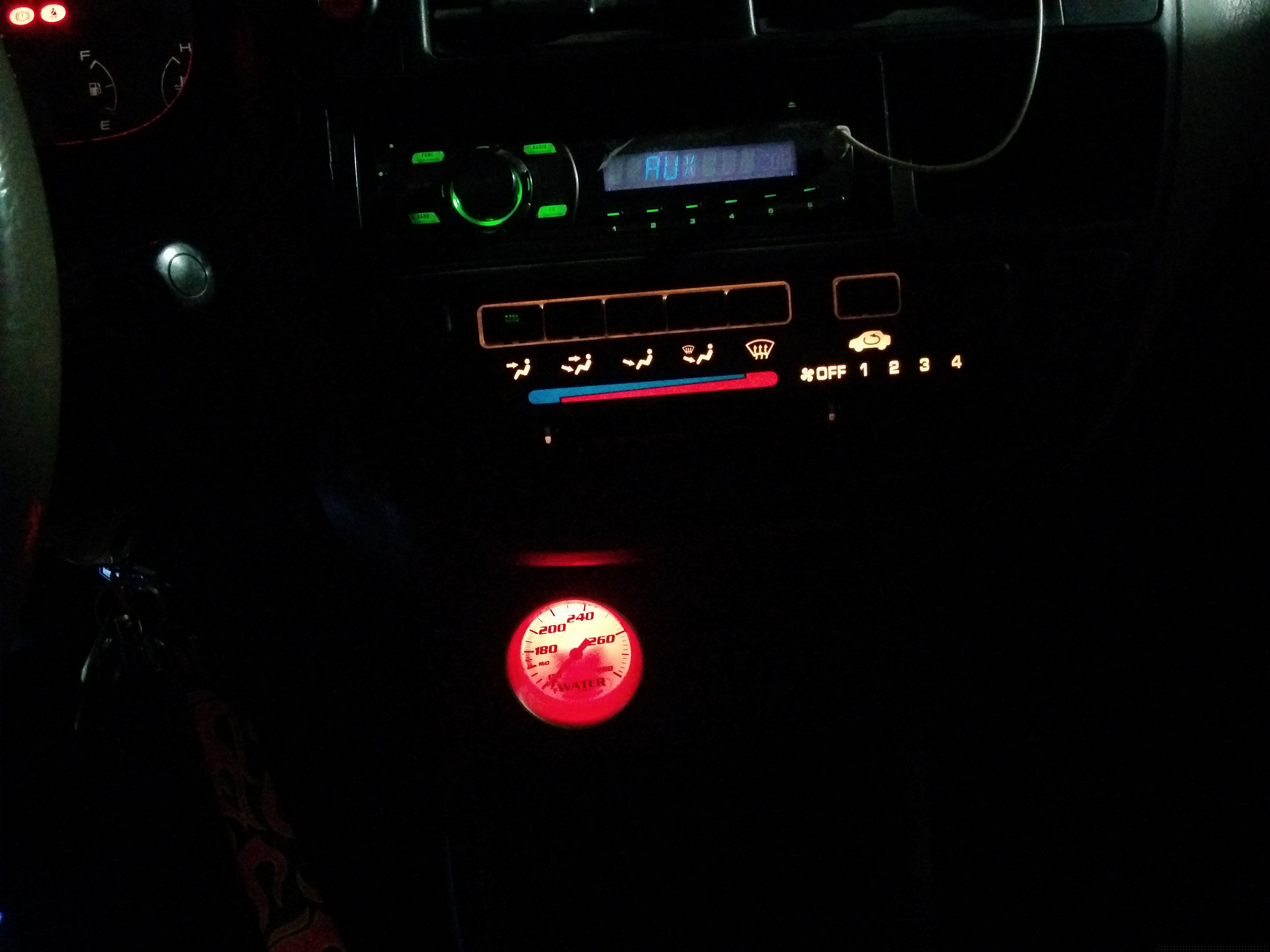

well gor my water temp guage installed today nice to have piece of mind while driving again. also found a kill switch that was previously installed

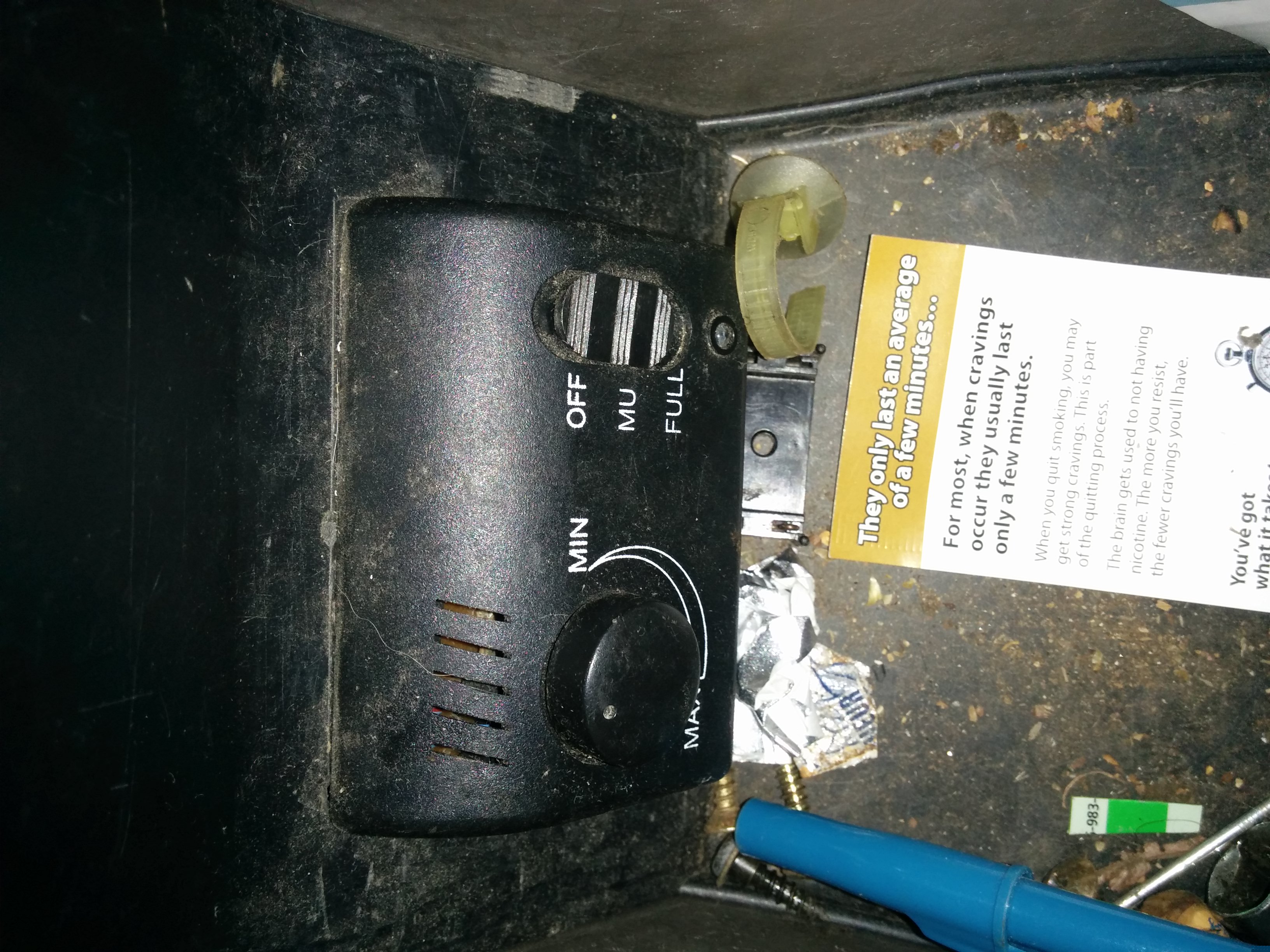

ahhh whats up with that? ^^^ click to see full size image i just wanted it to be in the forum. Anyways here it is Anyone know what the the module is for in the second picture?
