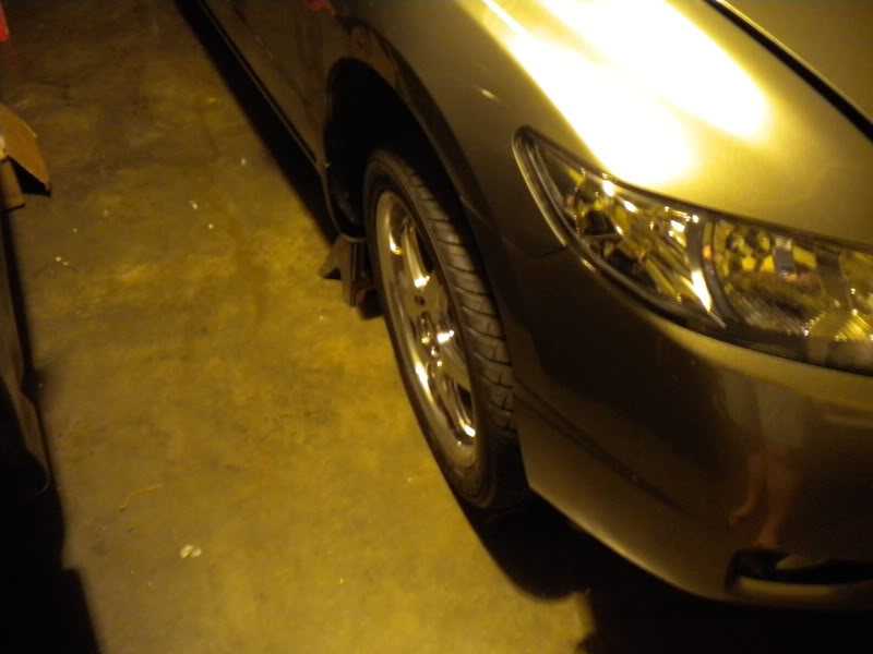

Jack up the car. Here is the jack point on the front of the car

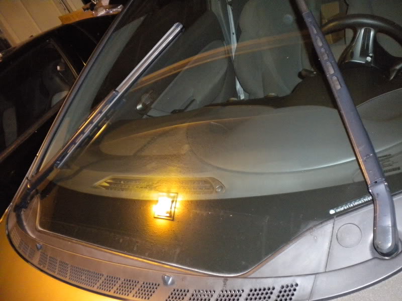

Get in your car and turn the key until the a/c comes on, but its not cranked. Flick your windshield wipers real fast and turn the car off so they are stuck upright

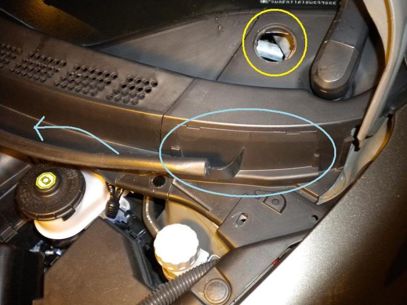

Take your flat head screw driver and pry up on both the circled panels, on the bottom one you will want to pull it in the direction of the arrow a good 8 inches to keep the weatherstripping out of the way.

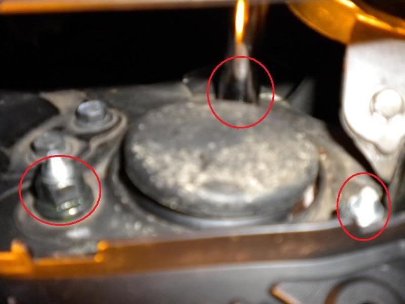

Go ahead and loosen the three bolts you see circled in red. For the front two you want to use your 14mm short and for the back you will need to use the long 14mm socket with the 3" extension. (In the picture the 14mm long socket is on the back bolt to show you where it is)

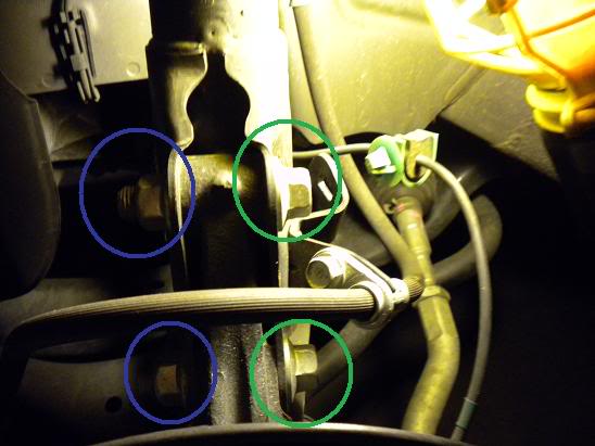

Now you need to undo the clip that holds the abs sensor on to the strut tower. JUST UNDO THE CLIP, DON'T DO ANYTHING ELSE TO THAT WIRE. You also need to use your 12mm long socket to undo the brake line from the strut.
Now your going to want to take your 17mm wrench and your 19mm 1/2" drive socket and ratchet and undo the four circled nuts and bolts. Your hub will not fall on you so don't worry.
Pull out the strut and install the new one. I loosely put the nuts on the top of the tower on first and then put the bolts on the bottom. You may need to put the jack under the caliber and jack it up to get the knuckle to the right height to go in the strut. The torque specs for the two NEWLY SUPPLIED lower bolts are 67lbs/ft. The torque specs for the top bolts are 33lbs/ft. VERY IMPORTANT. You need to put the jack under the knuckle and jack it up a bit to put load on the springs when you torque them to spec. Put it all back together, repeat for the other side. Put your wheels back on. Torque specs for the wheels are 80lbs/ft

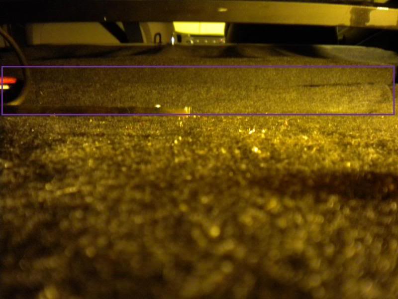

Open the trunk and pull the back seat down. Grasp the panel thats boxed in purple between the back of the seat and the trunk and pull up toward you pretty hard to pop the clips out, then remove the spare tire cover.

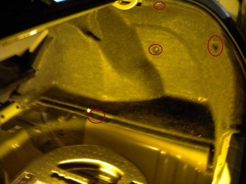

Pull out all the clips you see circled using a flat head or a special tool if your lucky enough to have one. Odds are you will break one and they are about $2.00 each from your honda dealer. You might as well do this on both sides, the clips are in the same place on each side.

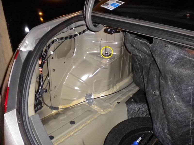

Pull back the panels and your going to see the top of the damper, since the threaded area is so long your going to have to use a wrench to get it off, see where the self-ratcheting part comes in handy here? Some people may need an allen wrench to take the bolt off, I didn't need one for either my tie-rods or my damper tops.

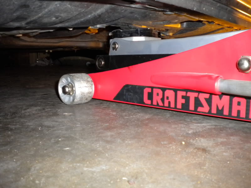

Loosen the rear lug nuts. Put the jack under the rear jack point and jack the car up, put jack stands under the rear of the car. (You want to jack it up sorta high to make things easier for you. Finish taking the rear wheels off and put them out of the way. Also you need to put something behind the front wheels, just to make sure it doesn't move while on the jack stands since the parking break wont help you with the rear tires off the ground.

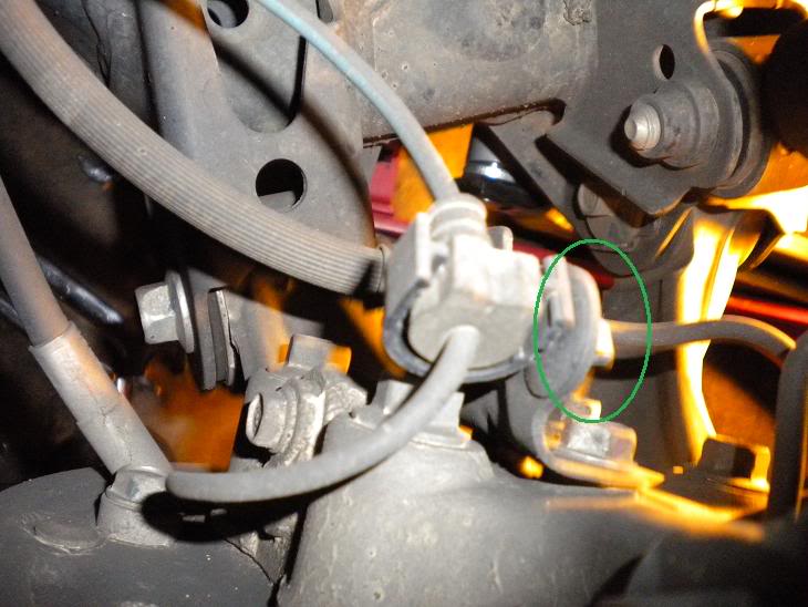

Unclip the wheel sensor here as well.

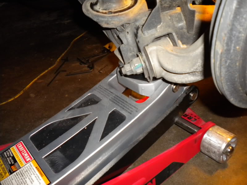

Place a jack under the wheel assembly your working on and jack it up a little bit.

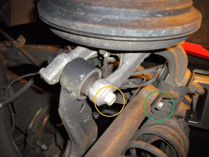

Undo the sway bar links, doesn't really matter which end, but I chose the end that attaches to the lower control arm. Using your 17mm 1/2" socket and wrench, undo both the bolts you see here. Its hard to get the one that attaches the hub to the upper control arm out, just keep working at it it will come.

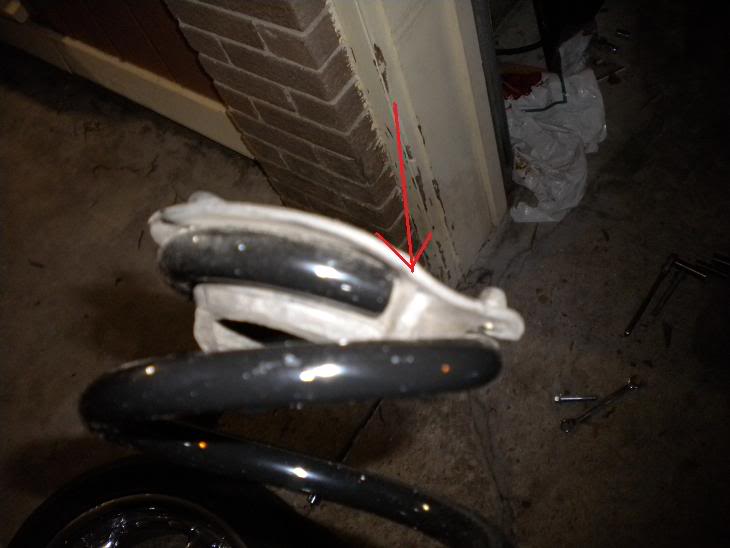

Lower the jack slowly. Remove the rear damper. You may have to pull kinda hard. Push down on the top of the hub and pull hard on the spring to get it out. Put the rubber things from the old spring on the new one. Make sure you line up the bottom rubber mount correctly like shown below. There is a stop that goes lines up with where the spring ends.
