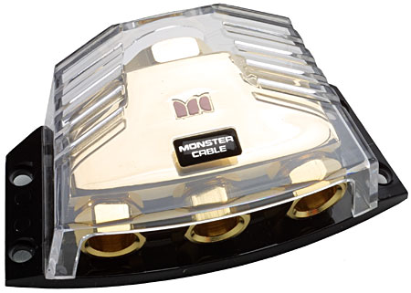

This is what you need. Its called a distrobution block. Even Radio Shack sells them.
It will take your existing power wire in the rear of the car and split it for multiple amplifiers.
Depending on the size wire you have run now you might be ok. Tell us your amps and then we can tell you what size wire you need coming to the battery the the splitter.
Good luck.

I have a Kicker 400.1 and a Kicker 150.2 in my car. I run 4 gauge to the back, then split it with the monster splitter I showed you earlier.
If you only had 8 gauge running to the back then you would wanna upgrade it to 4 gauge so it could handle the power needs of both amplifiers.

The point is if you have 2 amps that require 8 gauge there are two options. Two runs of 8 gauge or one run of 4 gauge to the trunk plus a splitter running 8 gauge from there to each amp.

I would go with a kicker kx300.4 amp for the 4 interior speakers. Run 4 gauge wire from the battery to the distribution block then 8 gauge from the block to the amps. Make sure you ground both amps with 8 guage wires. You can build an amp rack for your amps and mount the block by your amps for looks. Then if you want also put a neon stick to accent your amps at night.
