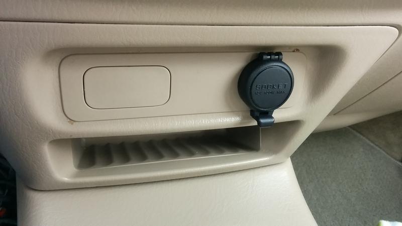

Buy a Type A to MALE TO FEMALE USB jack, and then mount it next to the handbrake where there is a small plastic trim that easily pops out. That is what I did alongside an AUX. the reason is you can upgrade your head unit to one of those touchscreens with the AUX and USB at the rear, and it will be a really clean look and convenient.
Then for wiring run a 6'ft USB and 6ft AUX under the plastic trim, and hook it up to the back of your head unit. Now this only works well if your head-unit has inputs at the rear.
I bought the 6 foot USB Jack and AUX Jack from this Malaysian website and it is nice and thread locking attachment procedure.
Here is my setup
