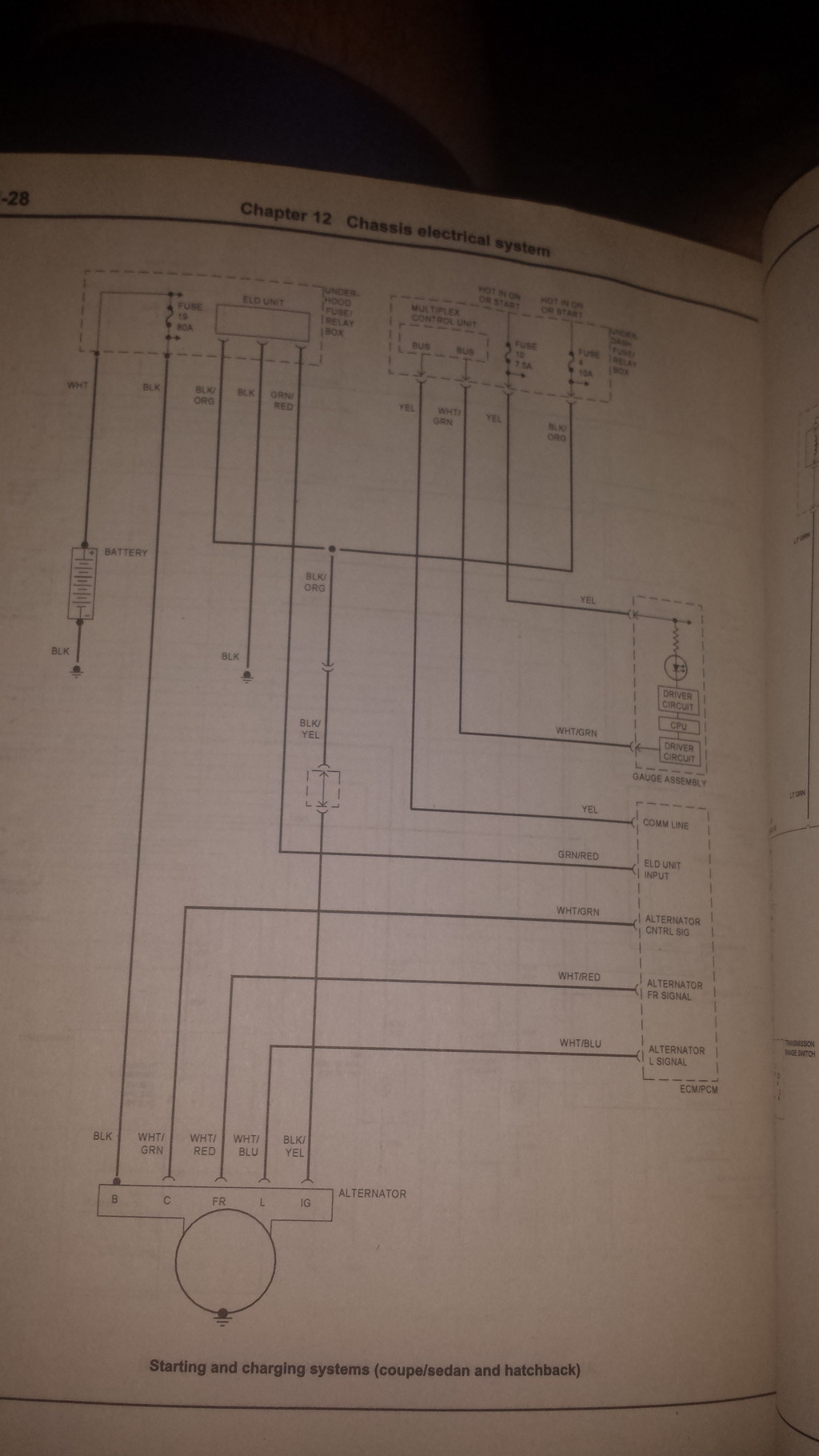

I will redo the 4 wire plug in the alt according to the updated info you gave me. I am getting to work on this today as Mondays are my off days....and this weekend was crazy!
I printed off the testing procedures you recommended above, then I left them at work :/ I will start tackling all of this today.

So the red battery light stays on with the key "on" but engine not running, with 4 wire plug disconnected.
Also the car has the courtesy chime with the key in, but no lights... the interior lights work if I push them in. The cluster dims with headlights on. A/C works, radio works, etc...
I will be doing the cluster self diagnosis test. As for the multiplex, from my research I do not seem to have most of the issues associated with that. BUT I am not sure what the "main fuse" located on the in cabin fuse panel is. All the fuses I have checked have been good.
Please advise.

Re: TOTAL HONDA NEWB, First post. Battery light on, alternator charging.
It blinked with the test of the lights
Next steps
Turn ignition off
Disconnect alternator 4 wire plug
Turn ignition on (do not start the engine)
Check voltage between blk/yel and ground
Is there battery voltage?
If no, check fuse #4 in the dash fusebox
If yes, then you're into checking circuits between PCM and alternator, NOW you need a service manual.

This should work, right? Is there a way to know which circuits should be energized and which should not? Once again thanks
Looks like a wire diagram of the charging system.
Use this in conjunction with the service manual?
You can see where the multiplex unit is involved between the PCM and the gauges. The 2 lines in and out of it are part of a communication bus, data is transmitted over it and you can't measure voltage on it. Much of the gauges and idiot lights operate using only data from the bus.
Voltages....refer to the troubleshooting stuff in the service manual. In the diagram the 12v powered stuff should be obvious as are grounds, but the rest.........
Here's a handy PDF on Hondas charging systems I just found, this explains better than I can:
https://www.google.com/url?sa=t&rct=...5wyG_ukAxxeDxA
"The voltage regulator utilizes five terminals: Ignition (IG), Control (C), Field
Reference (FR), Battery, (B) and Lamp (L). The B terminal is the high current
circuit that's responsible for charging the battery"

Looks to me like I should check the white/red, green, blue from the alt to the pcm? If there is a short in those styles that could effect the charging/trigger the light?
The basic tests are: Disconnect the alternator harness and the PCM harness, then do the continuity tests for each wire, and check each wire for a short to ground or power.
The alternator grounds the "L" circuit to turn on the warning light, so if the "L" circuit were grounded elsewhere between the alt and PCM that would cause the PCM to issue the command to the cluster to keep the light on (in theory).
I see your book diagram posted doesn't give terminal numbers at the PCM. You are gonna need those.
At the PCM:
Circuit L goes to connector and terminal B10
FR is B13
C is B18
ELD input is E15
Communication BUS is E24
