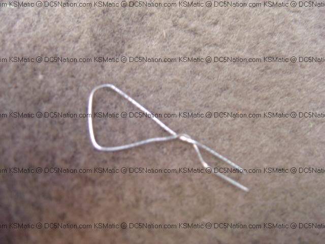

Paper Clip, you can use the paperclip and bend it out to where both ends are next to each other so it can be put in to two pins.

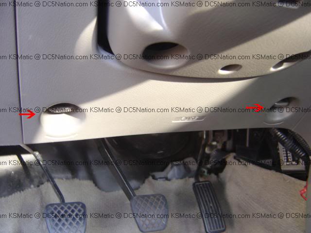

Remove the bottom panel under the dash, two twist clips which can be easily taken off. (turn counter-clockwise)

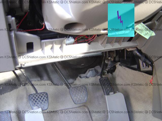

After the bottom panel is exposed, locate the fuse box (see drawing for location)

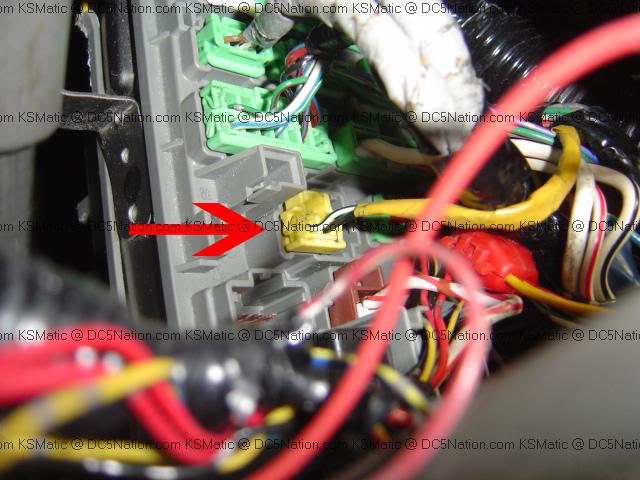

Step 4:

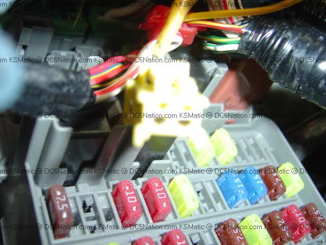

Locate the SRS plug above the fuses in the fuse box panel, you will see a yellow clip in the middle left side. It is also the ONLY plug thats yellow in the fuse box panel.

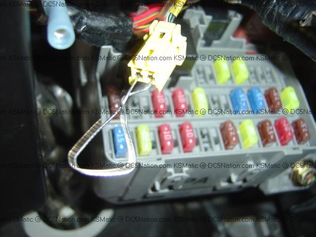

Step 5:

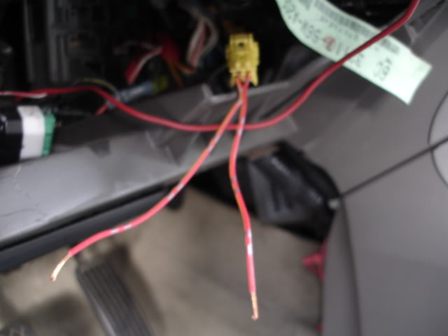

Unplug the clip. You should see two pin holes that you will be completing the circuit with using the paper clip or wires
Step 6:
plug the paperclip in to the 2-pin clip.

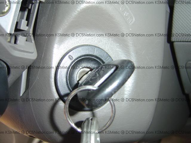

With the paperclip or wires in the pins, place the key in and click to the Ingition On position II and leave it alone throughout the whole step.
