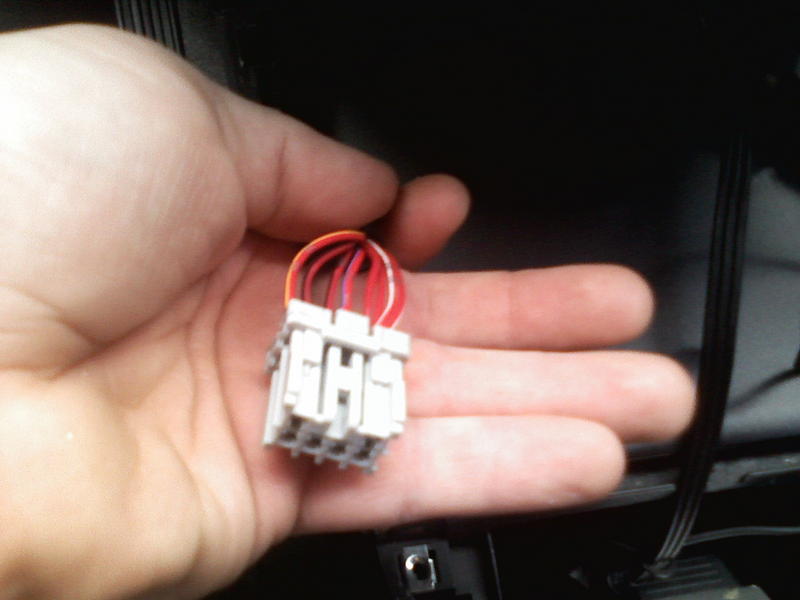

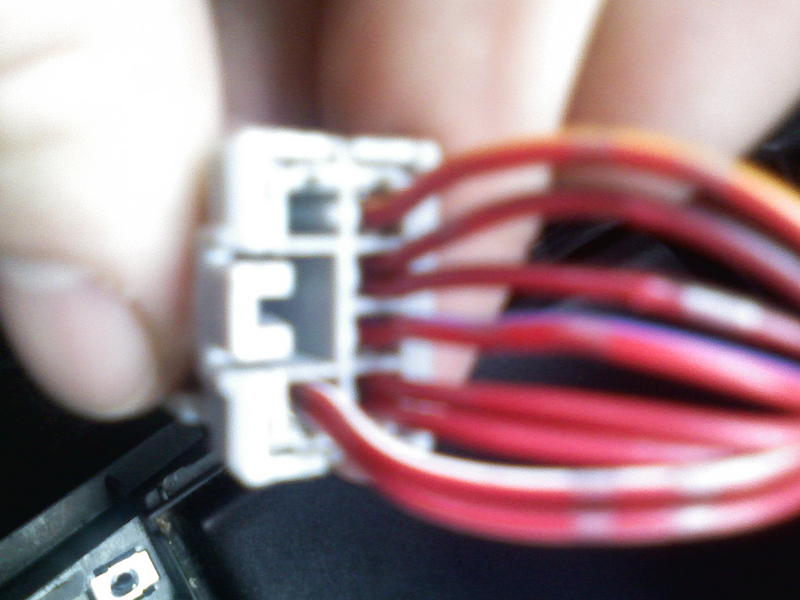

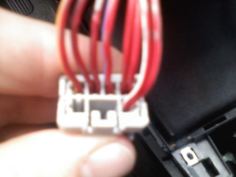

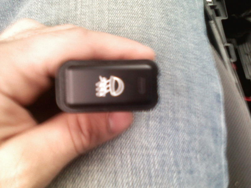

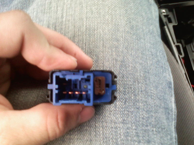

Update: With pictures, if anyone can help me I will rep you!! What color do I have where the blue trigger wire should be?

Is my switch and harness OEM can anyone verify this? Looking at the first picture I posted, is the blue wire at the top right of the plug on the corner, if you were holding the plug in that position?
Old Jan 8, 2010
  #40
Re: 12 Volt signal wire
switch is oem for sure, im not sure but prolly the harness too. if you are looking for the trigger, you need to test each wire with a multimeter to see which one gets 12v with the headlight lo beams turned on, but nothing with headlight off. its gonna be a different wire depending on your year and model of car. get a multimeter, set it to measure 12v, put the black probe to the ground, and one by one stick the red probe into each wire on the connector to measure voltage. im not sure which wire is the ground on that connector, mine had a black wire, perhaps one of your wires has a black stripe and that would be ground.

the one that had voltage was the one in the top right, but there is two wires there which one do I connect to power? or do I connect both?
Old Jan 8, 2010
  #42
you need to test each wire separately then. whichever one gets 12v with headlight on is the one you have to cut. you cut the wire, then attach a new wire to the switch side of the old wire. attach the other end of the new wire to your preferred trigger source like 12v socket or dash lights. tape off the other end of the old wire (not the switch side). i dont know why you have so many wires like that on the harness?

okay here is all it says for the switch, 01-04 civic. red and red/blk are power and ground for the dash light portion of the switch (lights up the fog symbol). blk is a ground for the indicator light when the switch is active. blu is the input power wire, and red/yel is the output wire to the actual fog light bulbs. the red/yel wire is also a low volt wire that triggers a relay to supply power to the bulbs. so if you re-route the red/yel wire to the parking light, the fog switch would be bypassed, and the fogs would turn on whenever the park lights were used. this is why the blu wire should be used, so that the switch still operates normally. sorry i cant be of any more help. thats all the book says, and thats how my oem harness looks. and it only has 5 wires.

So I have to cut each wire and try it? I was trying to avoid it, and just cut the right wire. I mean its not a big deal to splice the wire back together incase I get the wrong one, but I just figure doing it the correct way was always better.
Old Jan 8, 2010
  #46
when testing, you just have to shave a bit of the plastic off to expose enough wire to touch the probe to. only cut the wire once you figure out the correct one. its possible both might give the same 12v reading. and put e-tape over the slightly cut wire whichever is the wrong one.
